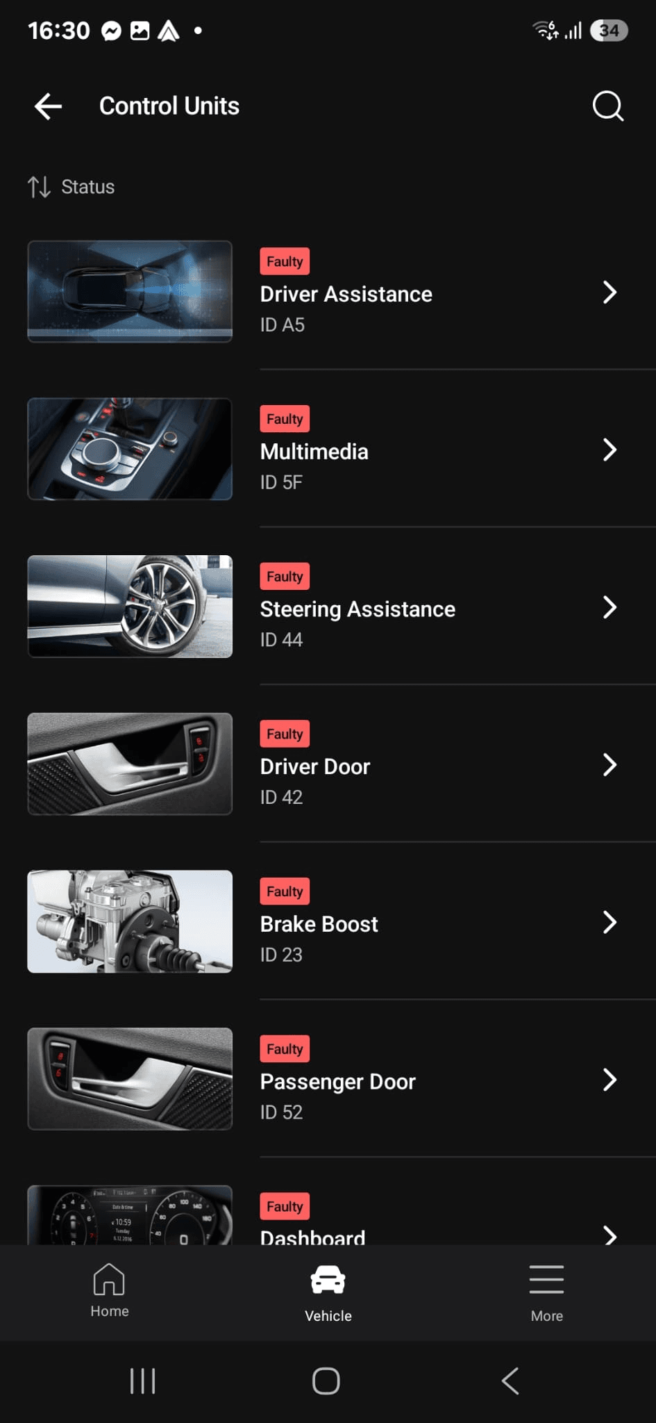

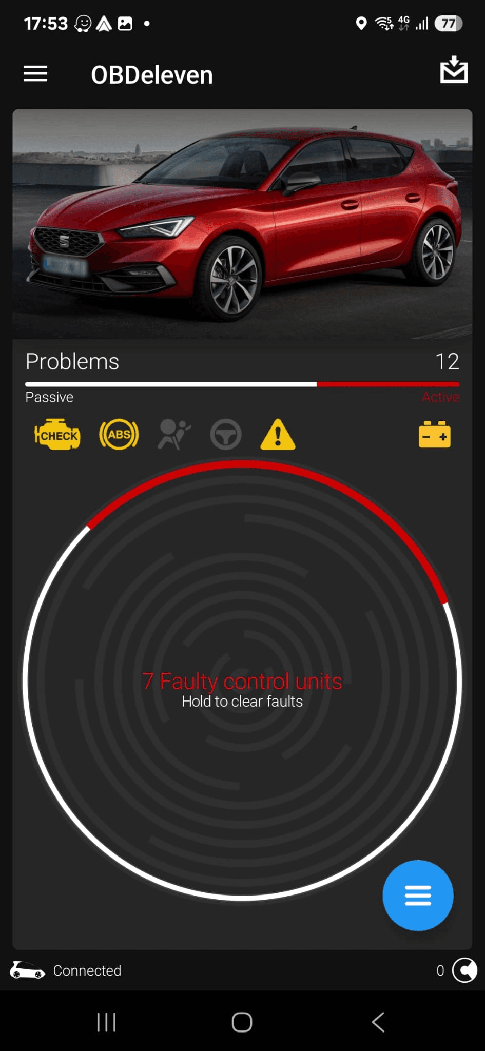

This is a scan immediately after wiping all error codes, again keeping only parts that show error cords, do let me know if its easier to analysis the problem with the unedited/shortened text:
11th April 4:57pm after wipe VSSZZZKLZNR004459 Seat Leon

I will make another log after my next drive with the car to see if the same 7 seven active errors shows.

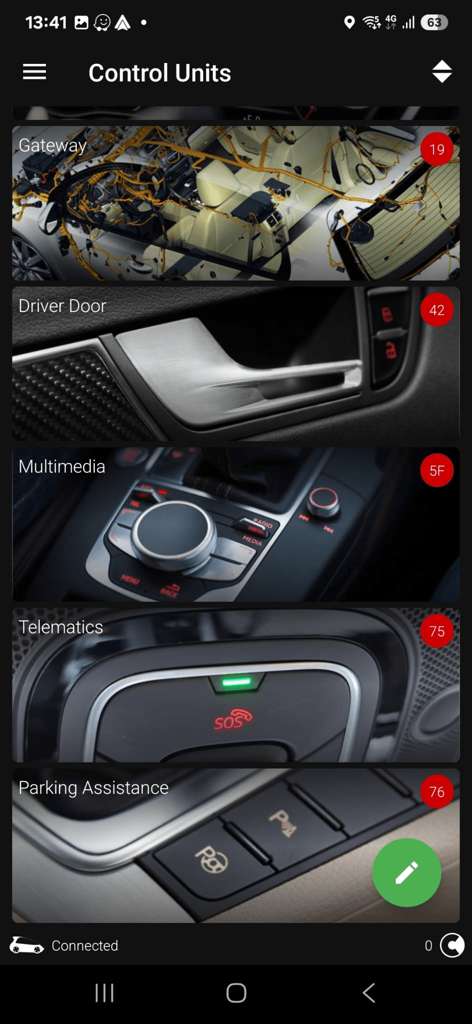

You have s Problem with your Gateway, check the Plug.
Then Drive To the Service Station and make s light Basic Setting and check
Thanks for pointing me in the right direction @cairus.
I'll find out how to get to the gateway plug and see if I can check and re-seat it. Likely be tomorrow in better light. Do I need to disconnect the car battery prior to doing this? I've not found any info specific to the Leon MK4, the MK3 and users did do this if I read correctly.

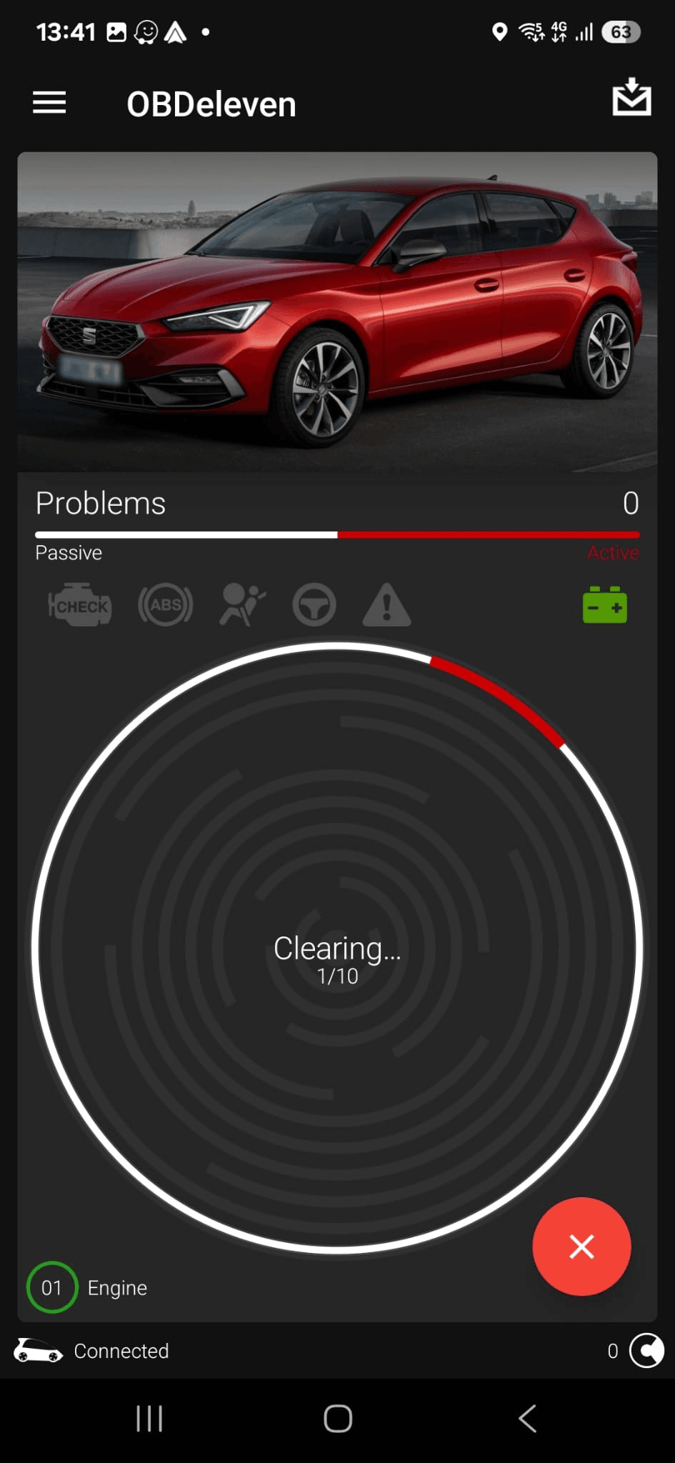

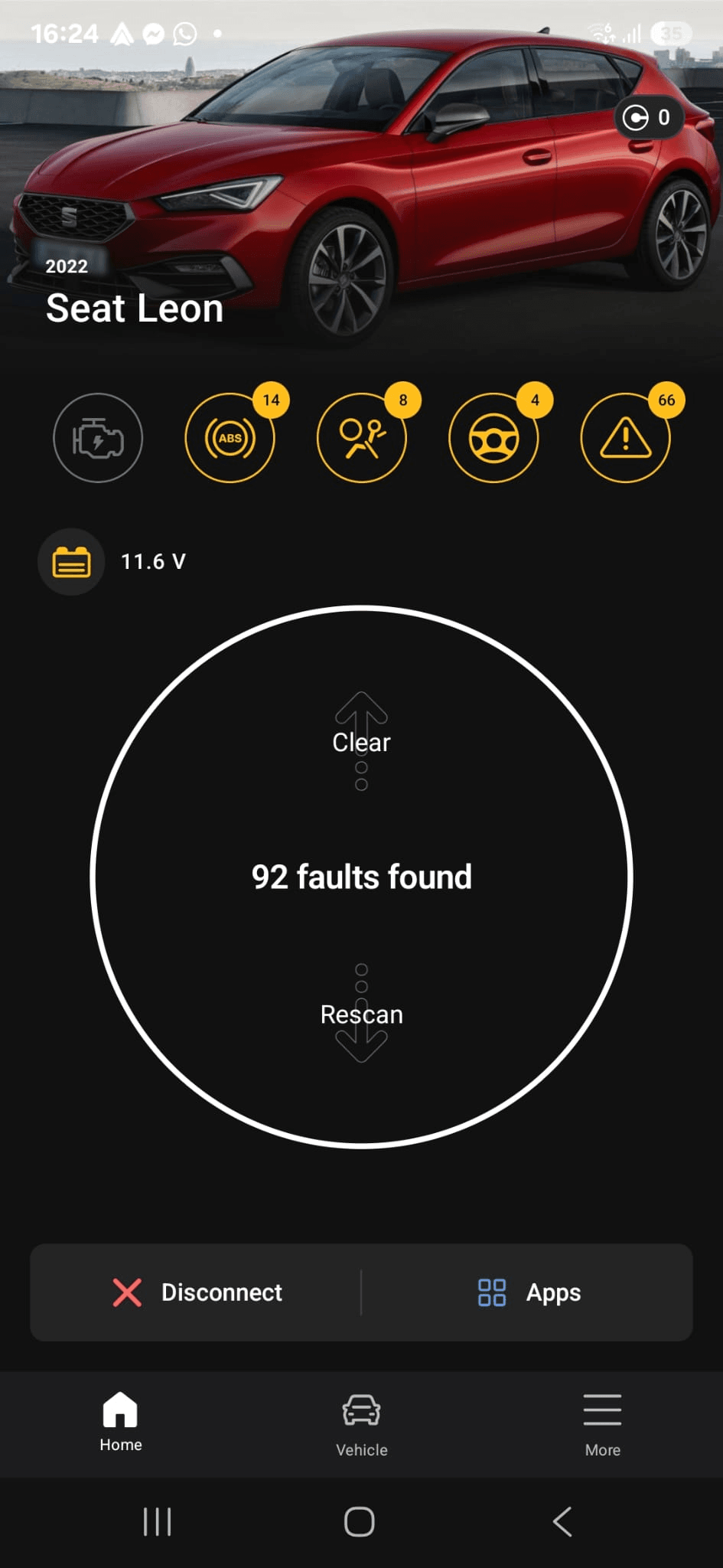

thanks for the heads up on this buddy. I'm getting the car looked at but a technition today who has a ODIS device so hopefully this will get updated, I've also printed those reports out, highlighting the ones that have reoccured over the past 3 weeks and removing the parts that don't have any errors. Thanks for the help and insight on this guys.
My suspicion is somebody did an update and didn't clear the fault codes. When you update a module using ODIS that module is taken offline while the update is carried out. This upsets every other module on the CAN network which causes loads of communication faults.
Whenever an update is carried out the fault memory is supposed to be cleared.
I'd clear the codes recheck after couple of days or a week of driving. See what actually comes back. It's possible nothing will come back.

Good call mate thank you. Yeah I've been making a habit do a scan every now and then to compare to past scans. Happy to share the OBD11 reports if interested.
With the MQB evo based vehicles I wouldn't worry too much about benign faults stored in the background, there's even a list of acceptable faults that cause no problems. When there is a genuine issue you will most certainly end up with a warning on the dash.
