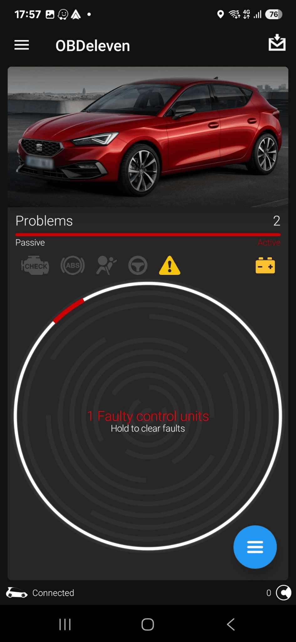

This is a scan immediately after wiping all error codes, again keeping only parts that show error cords, do let me know if its easier to analysis the problem with the unedited/shortened text:
11th April 4:57pm after wipe VSSZZZKLZNR004459 Seat Leon
OBDeleven data log
Date: 2025-04-11 17:57
VIN: VSSZZZKLZNR004459
Car: Seat Leon
Year: 2022
Body type: Hatchback
Engine: DLAA
Mileage: 23654 KM
09 Central Electrics
System description: BCM37w_M1
Software number: 5WA937086M
Software version: 0174
Hardware number: 5WA937086M
Hardware version: 026
Serial number: BXJ53F23062194061467
ODX name: EV_BCM37w
ODX version: 007001
Trouble codes:
C107E54 - Headlight No basic setting
static
Date: 2025-04-11 17:56:25
Mileage: 23654 km
Priority: 4
Malfunction frequency counter: 1
Unlearning counter: 40
Terminal 15 status: On
Terminal 50 status: Off
Engine running: Off
Status of brake lamp switch, discrete: Off
Brake lamp switch via CAN, status: Off
Voltage: 11.9 V
Outside air temperature: 22.0 °C
Light switch position: Automatic
B201B00 - Program monitoring
static
Mileage: 23654 km
Priority: 6
Engine running: Off
Voltage: 12.0 V
I will make another log after my next drive with the car to see if the same 7 seven active errors shows.

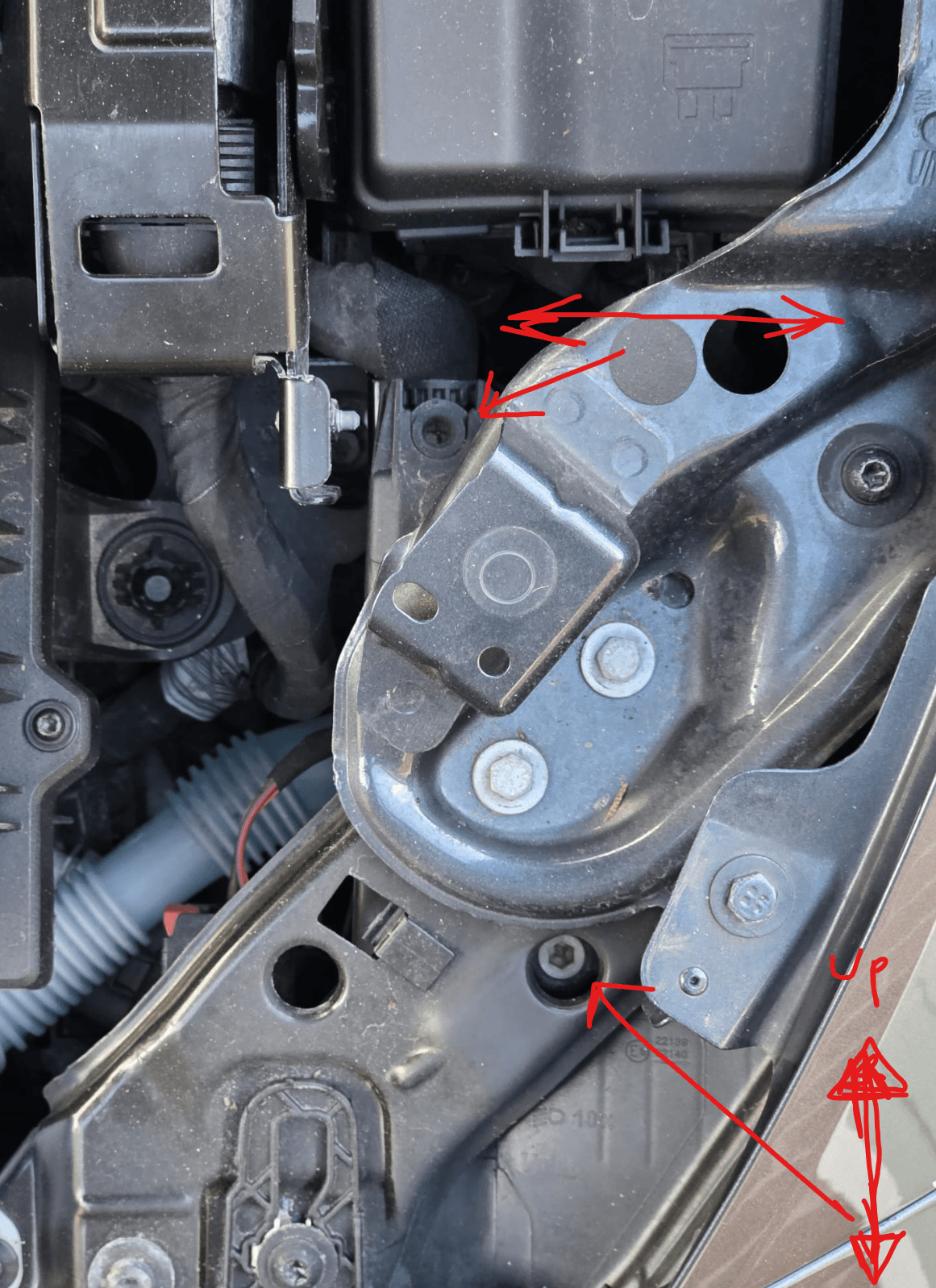

and I'm assuming the top is for left and right, the bottom one is for up and down:
Please do not adjust your lights yourself.
Thanks for the warning. I wont. They do seem to aim very low and have never been able to find how to adjust via the touch screen panel, like the physical 1 2 3 roll dial you have on older cars.
