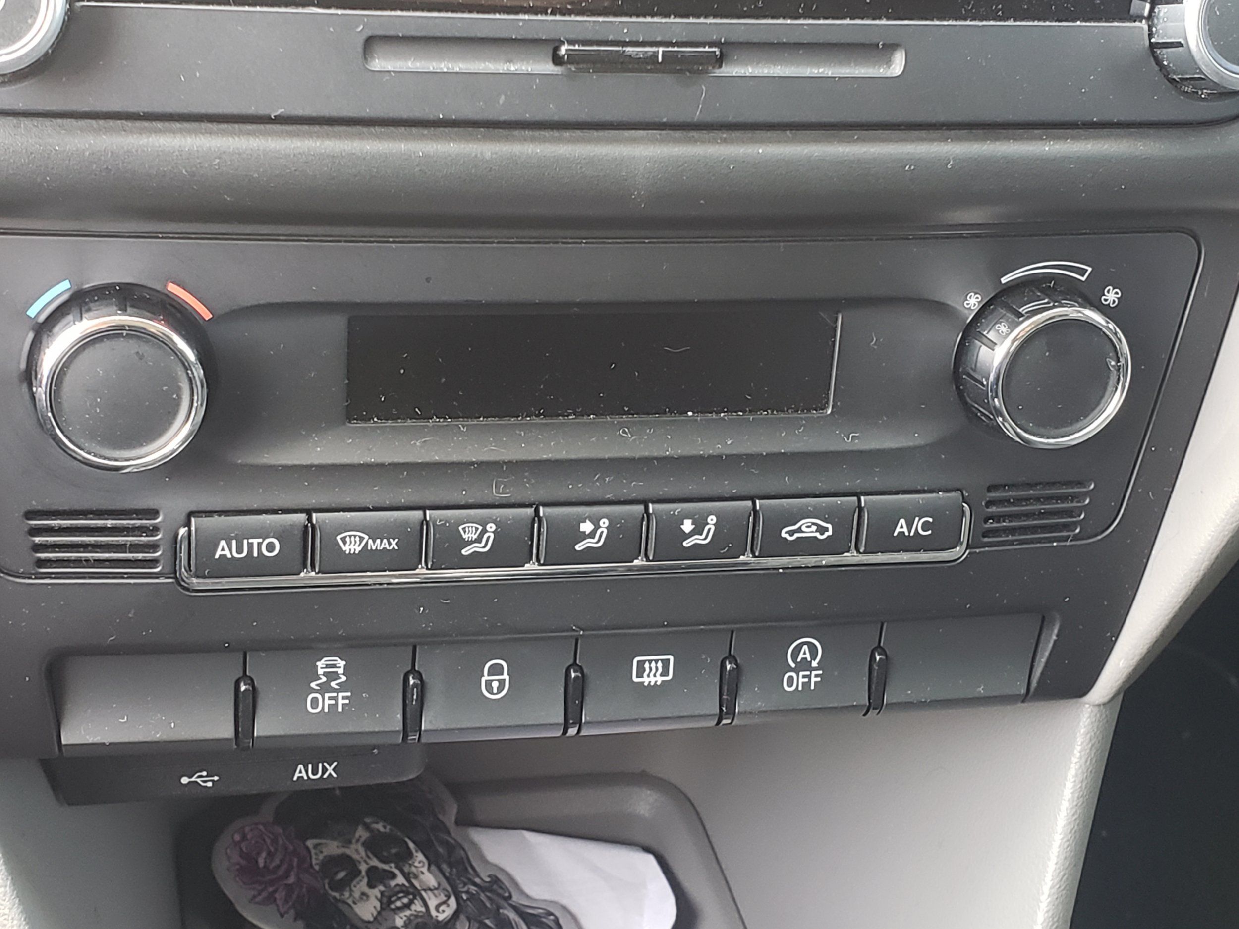

As per title, wondering if the stop start system is in any way linked to the heater/aircon climatronic settings on the Toledo? It's a 2014/14 plate
1.2 SE Nav with the auto climate system as in the photo. It seems that if the climatronic is completely off, and the display is therefore off, the stop start works each and every time. If the climatronic is on, then stop start more often than not doesn't work. And if it cuts out with the climatronic display off, and the climatronic is switched on, the engine restarts instantly. Wondering if this is normal, and if so is there any way to prevent the stop start from not working.
I do NOT want to disable the stop start system, and sorry I don't have a handbook for reference.
Thanks in advance
I have the same car as you, and I've been driving a lot this week with climatronic / AC on all the time (on auto) and the engine has cut out at every standstill.
As you know, there are loads of different parameters the stop start uses, and I've given up trying to understand the behaviour of the system! Is it the same with the climatronic on but AC turned off? I expect there's another parameter at play; maybe the climatronic temperature? Mine is set at 20 degrees.

Next time mine refuses to cut out I'll turn off the climatronic and see what happens.
Thanks for the reply - no, it doesn't matter whether the AC is switched on or off. I'm wondering, having seen your reply, whether it is because of some temperature difference inside and outside the car. In fairness I tend to only use the AC to bring the temperature down initially and then open the windows. I'm not a lover of aircon myself, I prefer fresh moving air from outside - and really, really moan about the lack of a sunroof!..... All other perameters seems to be OK, battery fully charged etc
If the temperature is set to 20°c for example and the interior temperature is 25°c then yes this should prevent start stop from operating
The first 6 months I had the AC mostly set to windscreen, and that kills the stop start as shown above.
