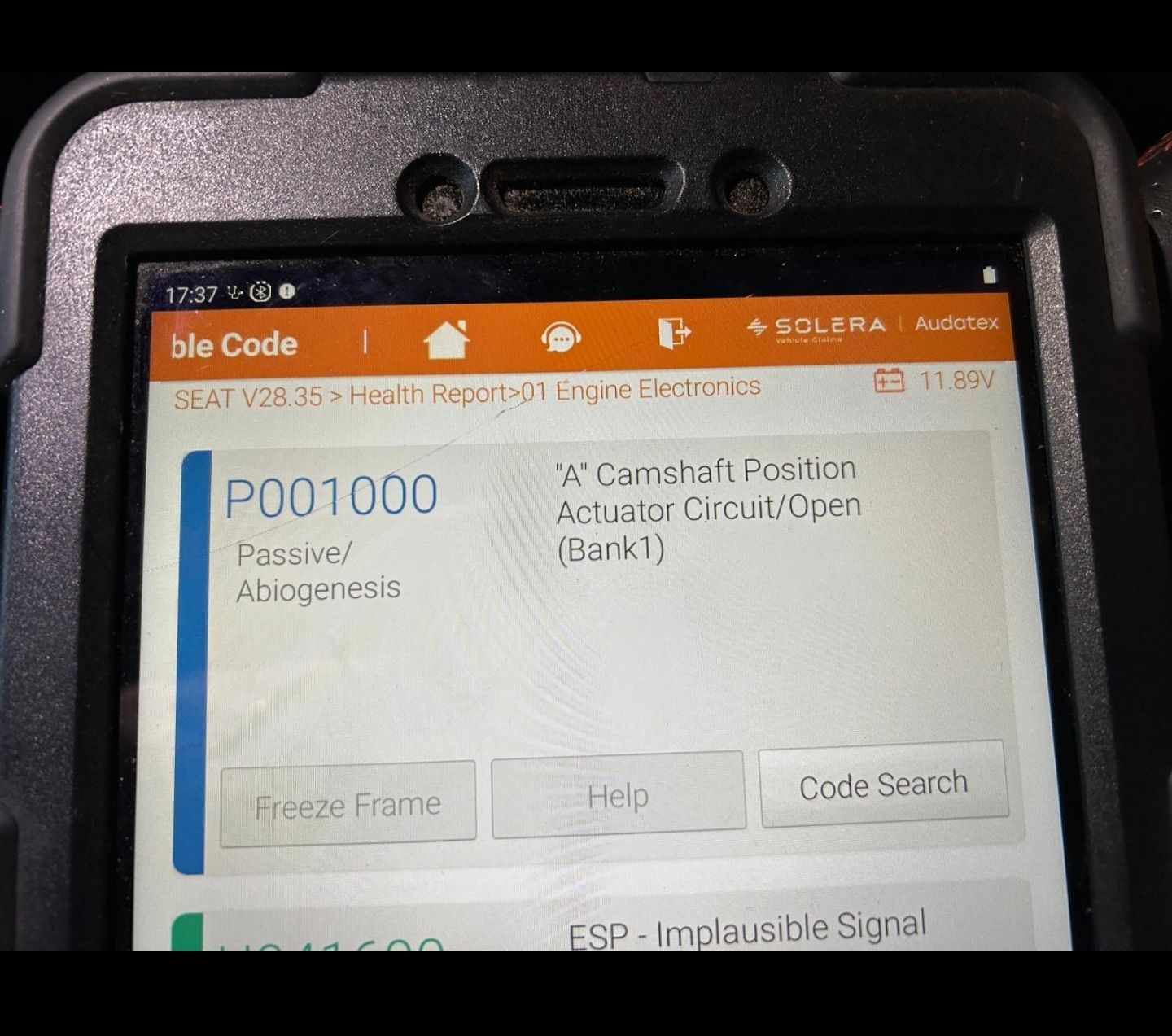

Got this out of it today. Is this the actuator that goes into the inlet cam on the timing belt side controlled by a magnetic sensor. I'm going to take it back to the dealer but want to have half an idea whats going on with it.
Open circuit fault with the actuator. It could be the wiring or the actuator itself.
