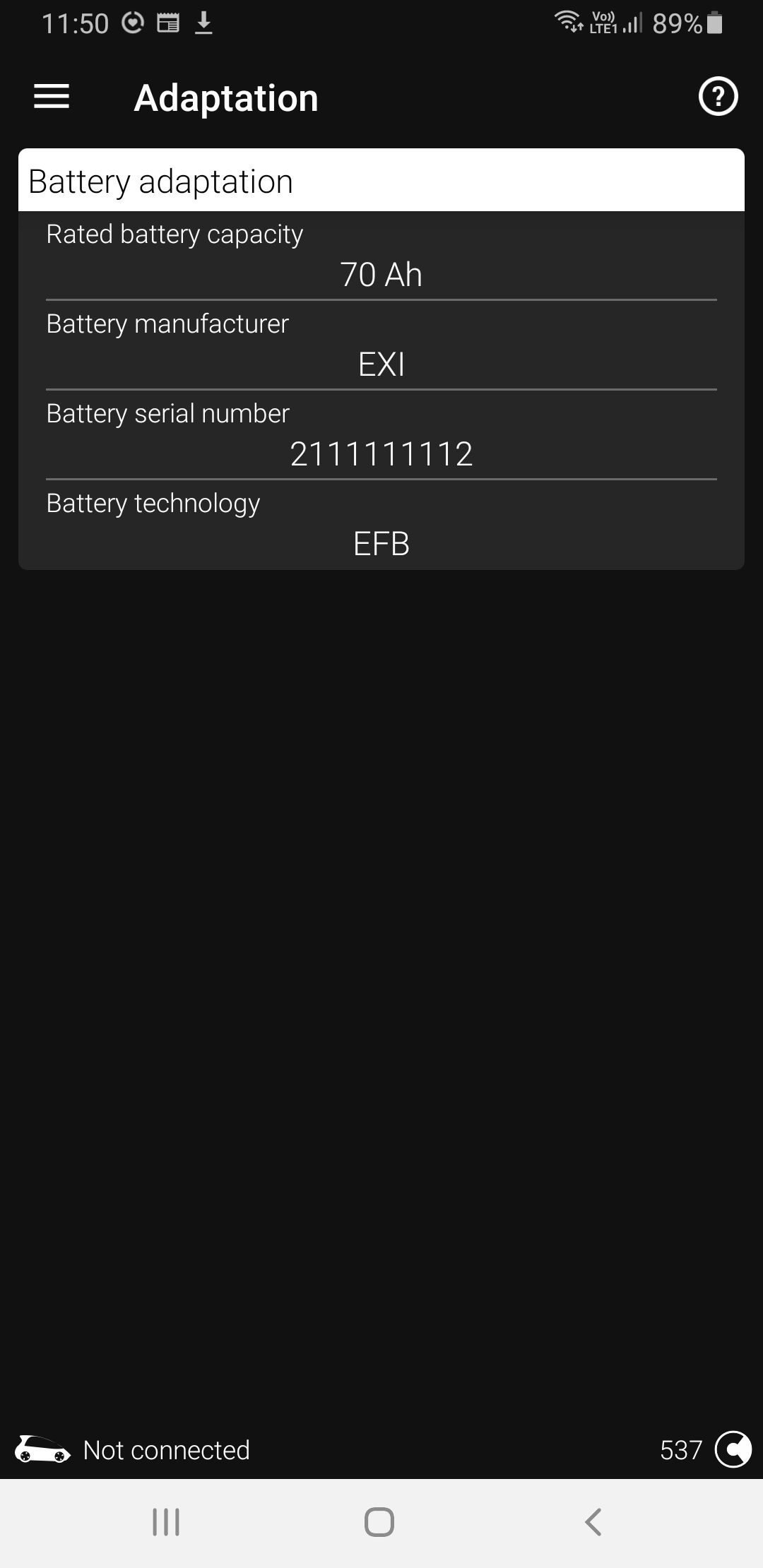

I think you should do the adaptation.
Go to Module 19 Gateway -
Adaptation -
Battery Adaptation.
Last time i did it was on my Vw Alltrack, 2018 this year.
This is how it looks:
