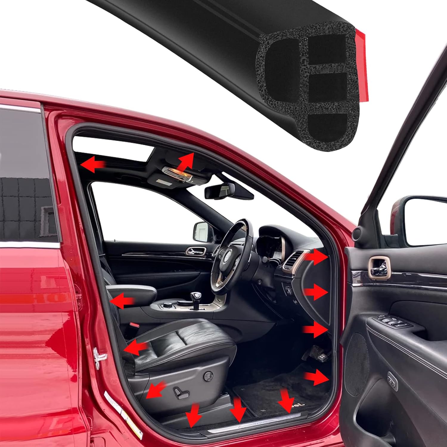

That too, but I was wondering about that sillicone piece that sits right on the door frame that keeps water out
I attached a photo of the thing from online of a random car.
Oh and about the trim around the A pillar, the clips break off easly? I am afraid of breaking one since I have never done anything to a car.

That too, but I was wondering about that sillicone piece that sits right on the door frame that keeps water out.
You don't need to remove that. Just the plastic A-pillar trim, the glove box and the dashboard end cap. The weather seal stays in place. You do need to tuck the lip on the dashboard end-cap under the weather seal when you refit it. A plastic trim tool is ideal, a few pounds off eBay.
If you pull the trim straight out the clips should not break. I've not had to replace any yet and I've fitted a few cameras. You just need to be careful when refitting. If you push the trim on without having the clips in the holes you'll bend the clips and need new ones. It's easy though, not like the tailgate trim!
May 9, 2025
