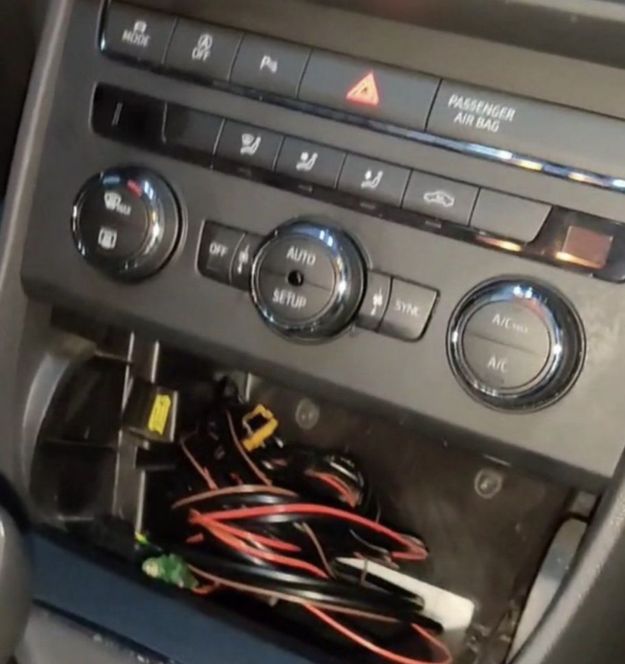

There are two light sensors - one for external illumination (either in the windscreen or rear view mirror).
The sensor for the internal illumination is the black dot at the centre of the Auto/Set Up switch on the climate control panel (picture is from another thread, possibly from a pre-FL car, but common across VAG cars of this era).
