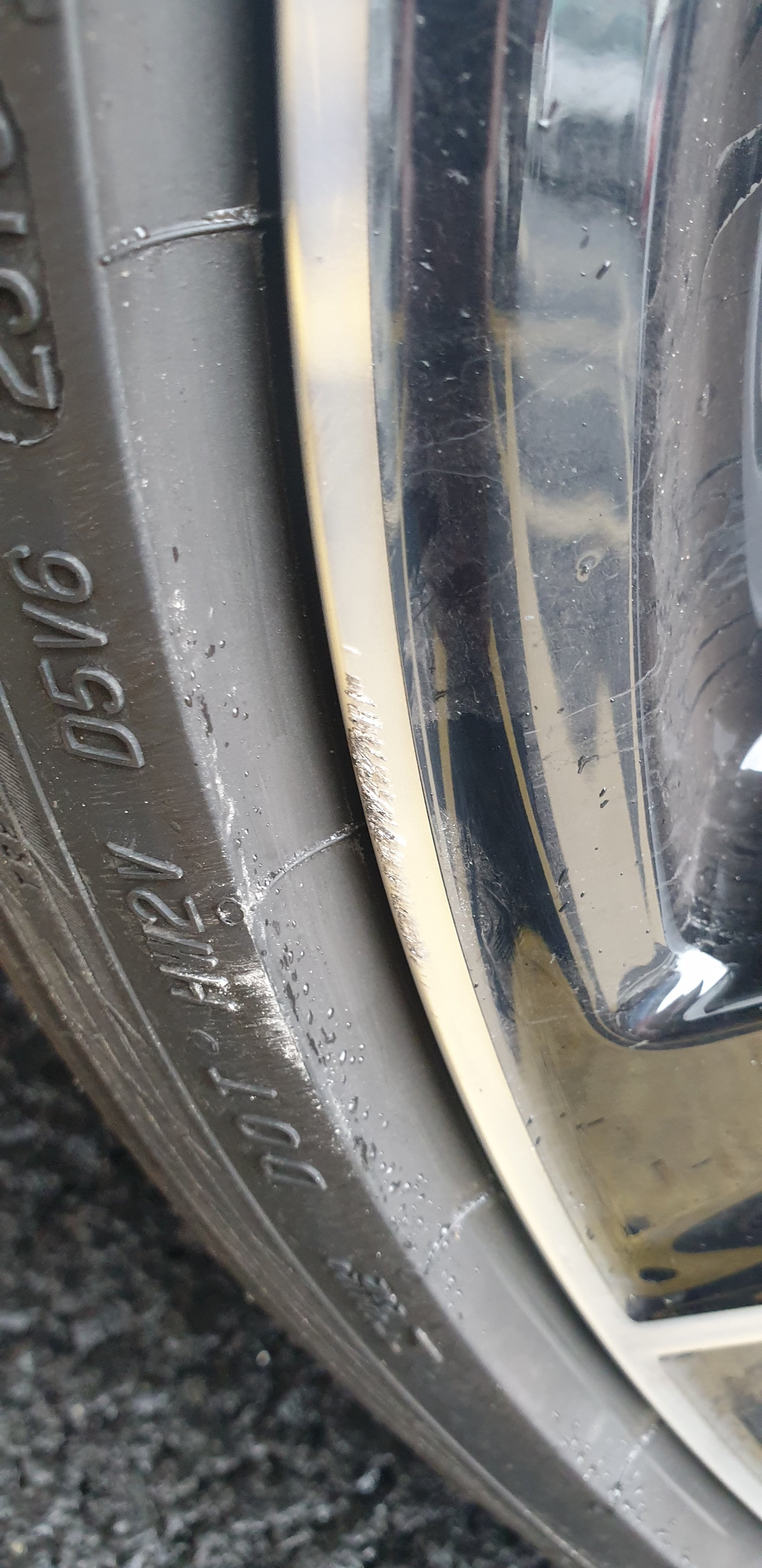

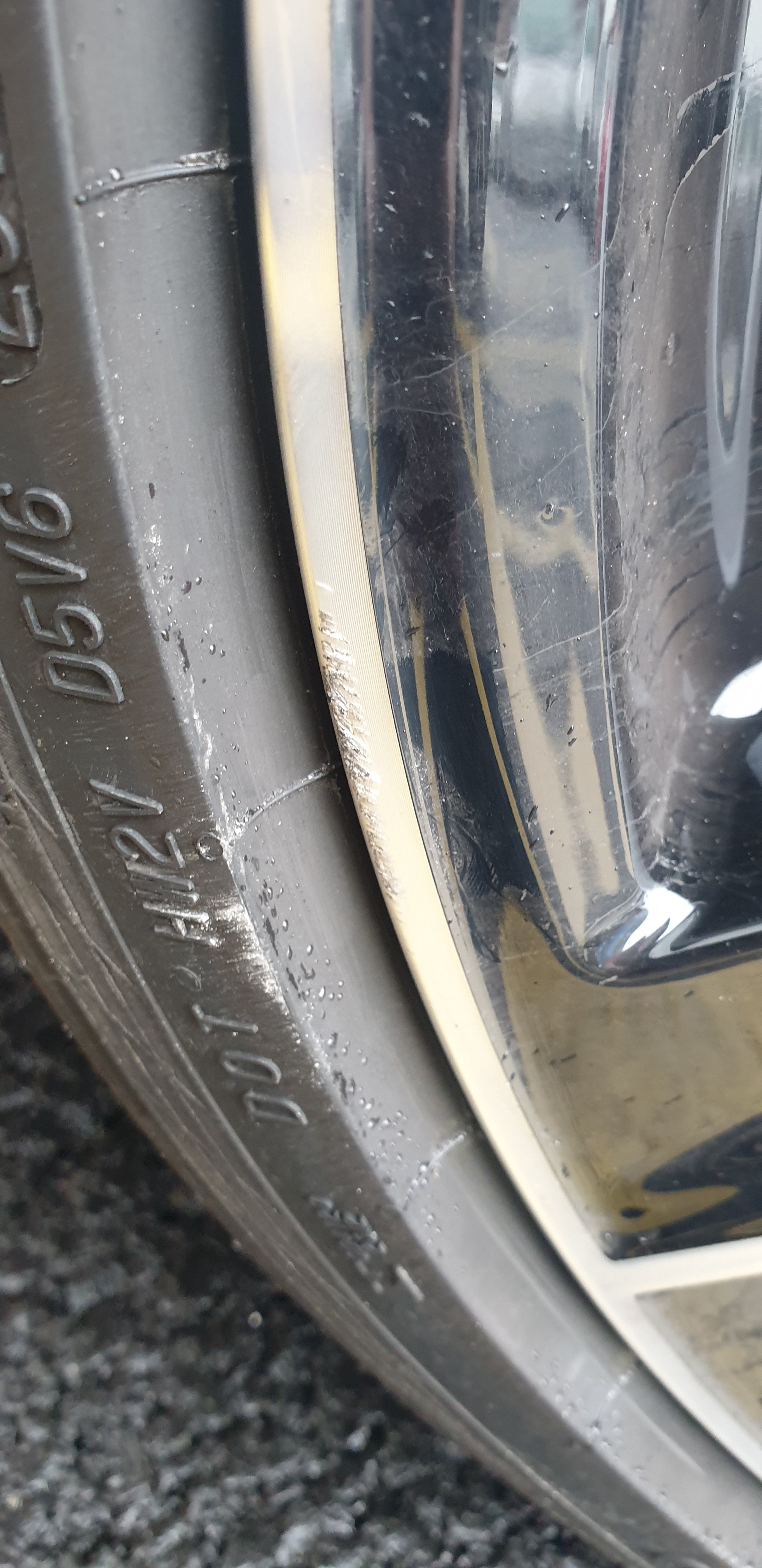

Hi guys,
Wondering if anyone had any ideas on how to get this kerb mark out of my alloy?
I have read about the wet and dry sandpaper approach, just wondering how effective that is?
Any suggestions welcome!

That’s not coming out by the looks of it.
Also even if successful in sanding there’s also a coat of lacquer that you’ll be removing leaving it open to further damage and eventually needing refurbished anyway.
It’s not awful though to be honest so I would just try live with it, if not your around £100 to have it refurbished.
Reactions: MXP2090
Live with it and wait for the corrosion to set in. Or get it refurbed.

Mask off the tyre (and alloy further away), and then wetsand with 2000/3000 paper. It will almost disappear and then apply laquer or use use a good paint sealant to cover the sanded area. Its worked well for me before on similar diamond cut edges.

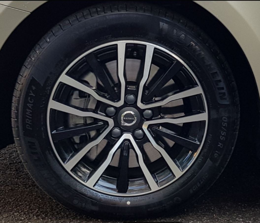

If you are in London, go to Whoops Wheel Fix it in Hendon and they should be able to sort that (without refurb) for about £75-80, can't remember exact price, as I had other stuff (non wheel related) done at the same time, took them about 3 hours.
My wheels (non Seat) were also curbed, and that's despite me having reversing camera!) and after they fixed it with polish and laquer etc, till today I'm still trying to find out where I kerbed it.
Regarding Alloygators, some fitters would outright refuse to mount on a diamond cut finished wheel, even if you tell them you will take the risk, this is why I did not go for alloygators...as they advised on their website, not for diamond cut..
*Sorry I can't zoom in to the part where they fixed it, as i don't know where it was...despite looking for the past 3-4 months...but i suspect it's at 10o'clock position on the full wheel pic..judging by where the writing on the tyre is..
Just found out prices:
'Sure, we can do a smart repair on this alloy at a cost of £65+vat. (half a day turnaround)
Alternatively we can get the full diamond cut repair done for £80+vat (3 day turnaround)'
