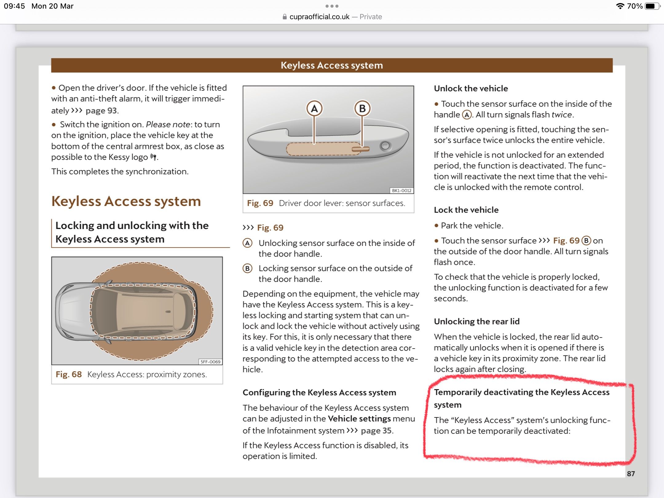

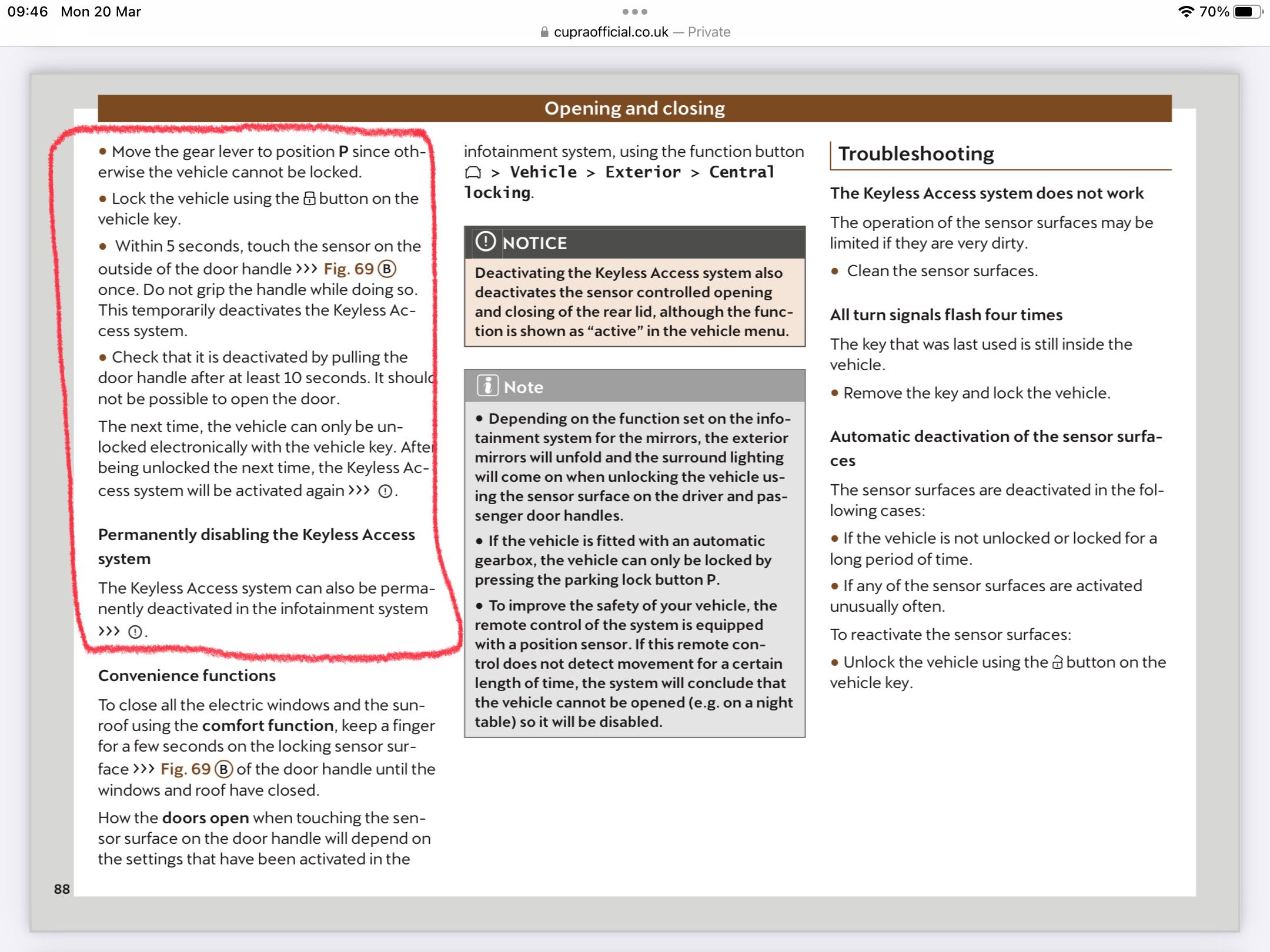

There are options to either temporarily or permanently disable the keyless entry function - pages 87 and 88 in the 2022 edition of the Owner’s manual (maybe different page numbers in earlier editions of the manual) - screenshots below;
My 2020 VW doesn’t have the option to permanently disable keyless entry, but it does have the option to temporarily disable it which I always do. It’s easy to do but needs to be done each time the car’s locked, but that’s no real hardship to do IMHO. I keep my key fobs in a metal tin when they’re in the house to stop any would-be opportunists trying to intercept the key fob signal.
