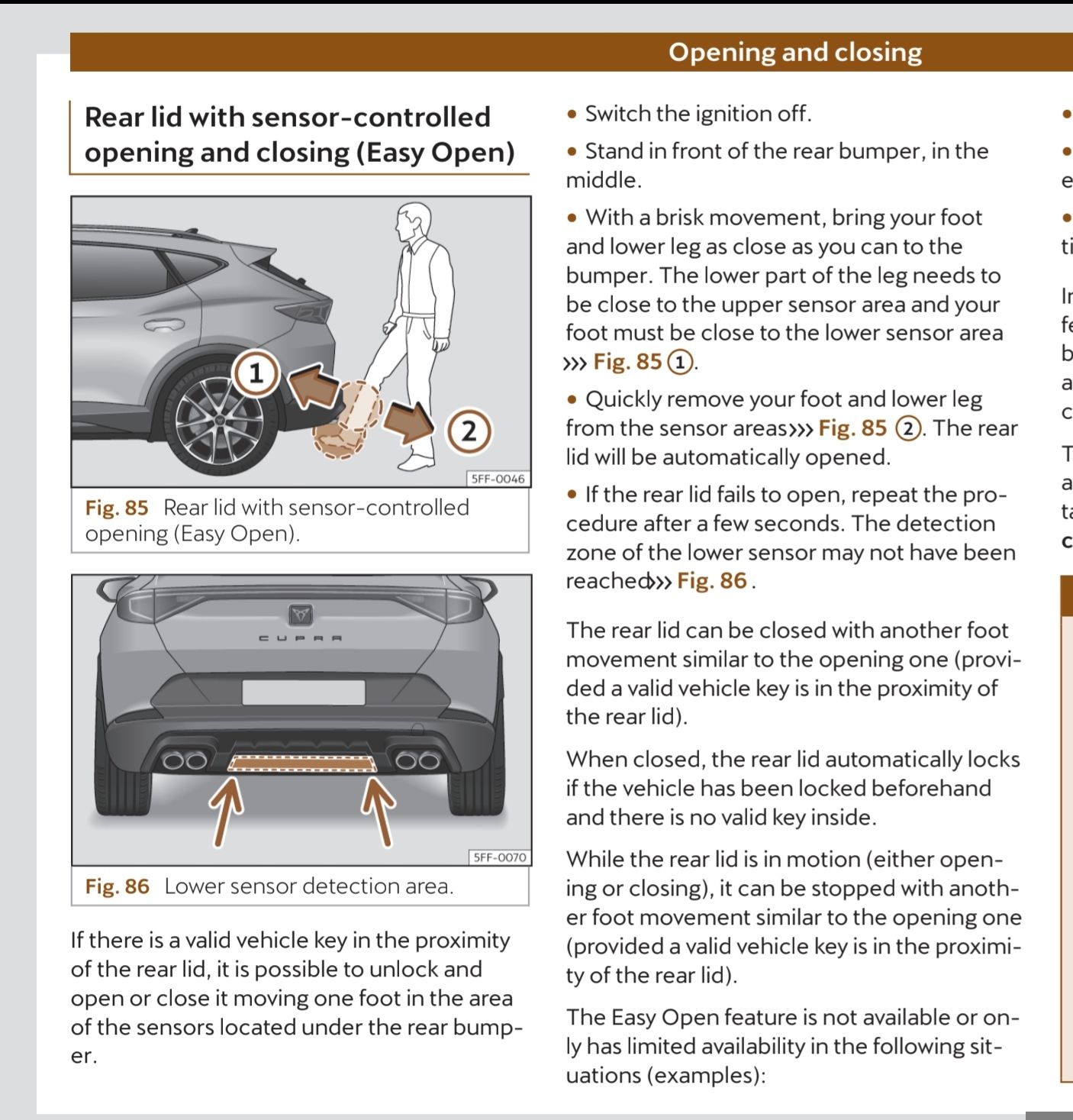

I only have my Formentor PHEV 8 weeks. The keyless entry doesnt work every time. It did when I had it first but the past few wks it’s opening at drivers side but not locking so I have to take out keyfob from pocket or handbag to lock. Also I have the got foot wave opening for boot but rarely works. Where is the sensor for this ? Tnks
It's right under the bumper at the center. Move your foot like a kick forward, not like a wave from left to right, and move a step back. I do this on my Cupra Ateca and it works everytime. Once you got it right, there shouldn't be any problem.
  • Screenshot_2025-12-04-18-24-31-530_com.google.android.apps.nbu.files-edit.jpg

The main thing that people forget to do with the virtual pedal is move back after they wave their foot under the bumper. The system uses the parking sensors to determine that you're out of the way, if you don't move far enough back then it won't activate.
