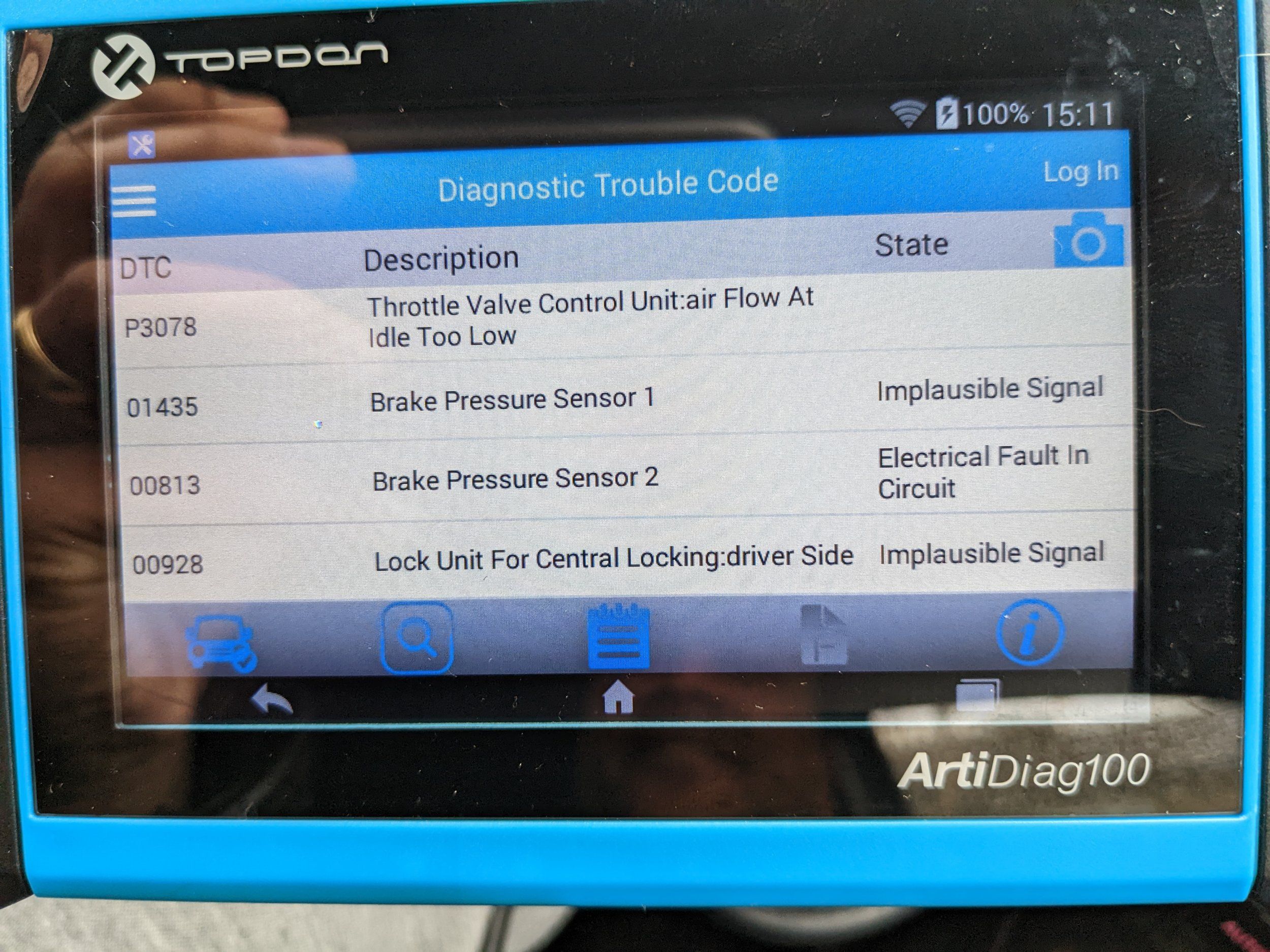

Hello mate. Hope you are well. Yes, the oild smell has dropped alot since replacing the cam cover gasket and steam cleaning the engine bay. I think I have a slight power steering fluid leak but not bad enough to worry about now.
Actually there is one, see att.

Is that scanner capable of doing throttle body adaptation/re-learn? If so then i'd give that a try.
You would probably need to do that procedure after cleaning it too.
Maybe a new airflow meter? Mine was running at 25%. I always thought they worked or they didn't. Who knew?
