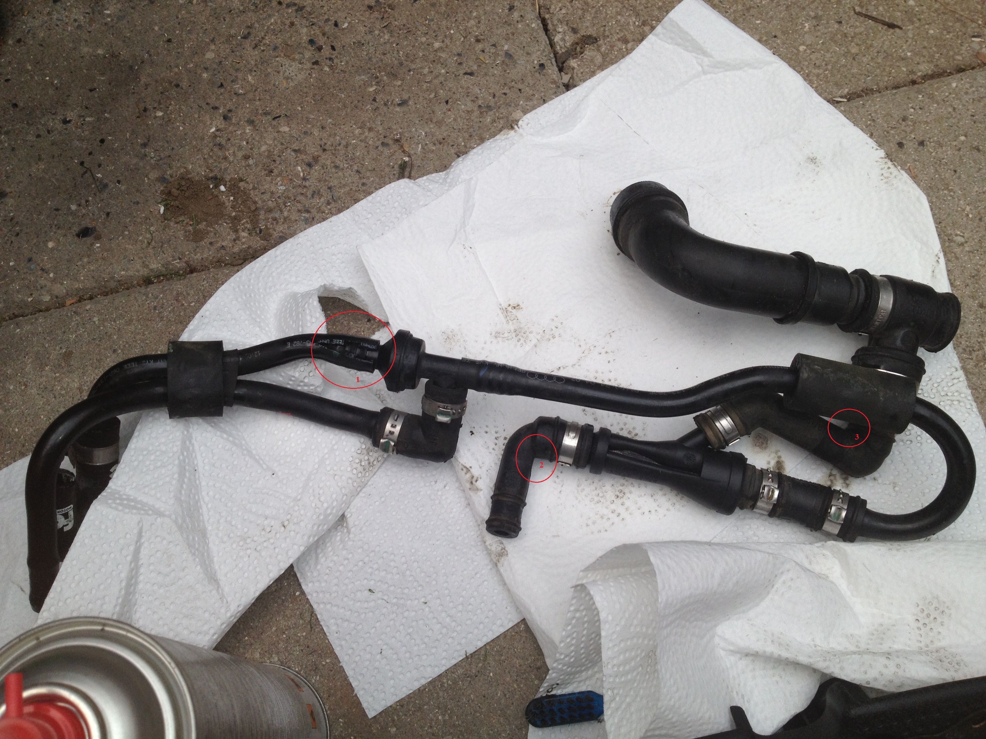

Before taking the manifold off, i found a majorsplit/crack on one of the the plastic tubes under the manifold.
So started to tear it down to see how much was split.
Two of the splits are the classic ones, Forgemotorport do a set for them. Marked 2 and 3 on the picture.
However, the split marked with 1 seems wierd, but the plastic is just cracked.
Additional question, even though i cleaned around the injector seal before taking the injector out, and cleaning around the manifold(pressure from distance/vacuum cleaner). but tiny stone/debri is visble around the valves.
I could suck some of it out with a vacuum cleaner, but some are still left there? I dont see as super with "stones" in there, but should I worry?
