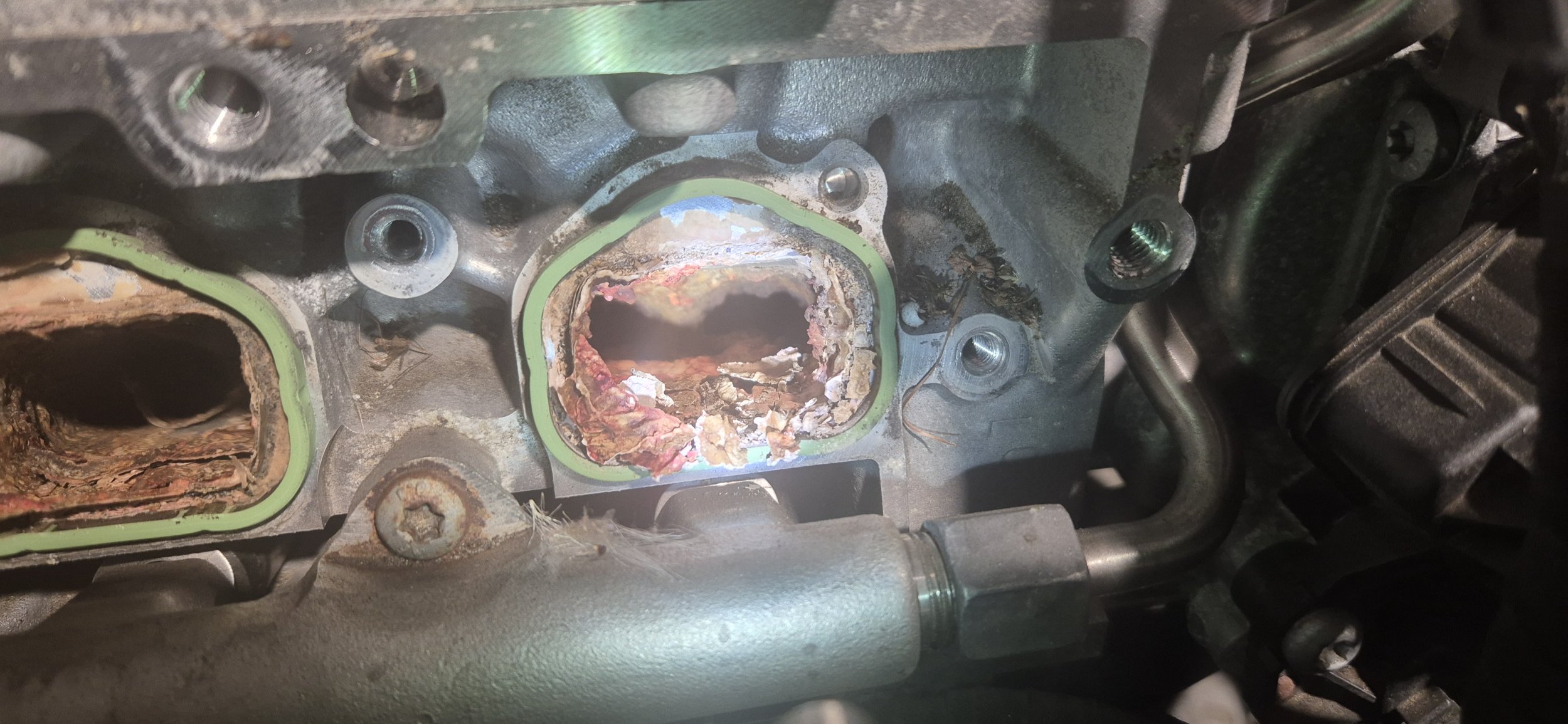

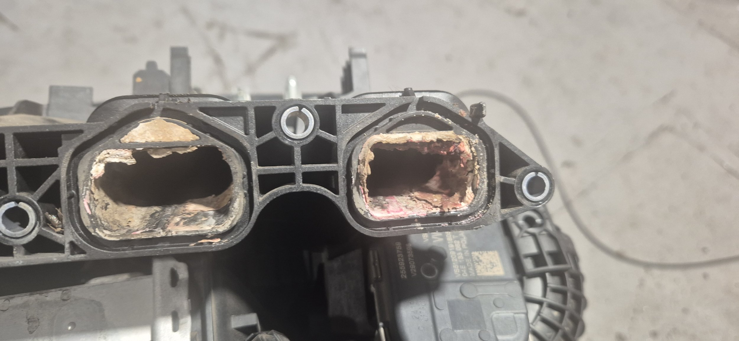

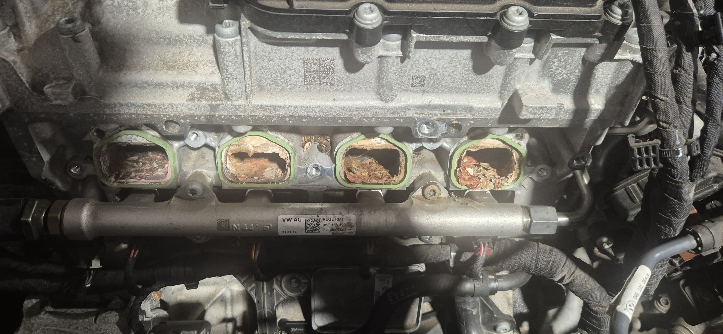

Hey All,
I've had the report and the work has been done. Car now running sweetly :)
Issue was a leaking charge cooler causing heavy coolant contamination in the inlet manifold and cylinder head. See attached pics :(
Thanks to you all for your input. I hope this update is of help to someone in the future.
Andrew

Oh, that's not good, how much coolant was this car using to cause this?
Is this becoming a regular failure for EA211 engines?
I wouldn't say regular, I've come across it a handful of times.
About 3 expansion tank’s worth, over a couple of months, maybe slightly longer..
I’m kicking myself because I knew I had a leak somewhere but didn’t have the time (or prioritise the time) to investigate fully.
first couple of coolant fills there was no misfire, and as I could see no contamination in either engine oil or coolant I assumed the slow leak was external.
At the first misfire I should have considered this, but there you go. Lesson learned for me!

It's a completely random occurrence. I've seen it happen on cars less than 12 months old. There appears to be no pattern or signs of influence.
