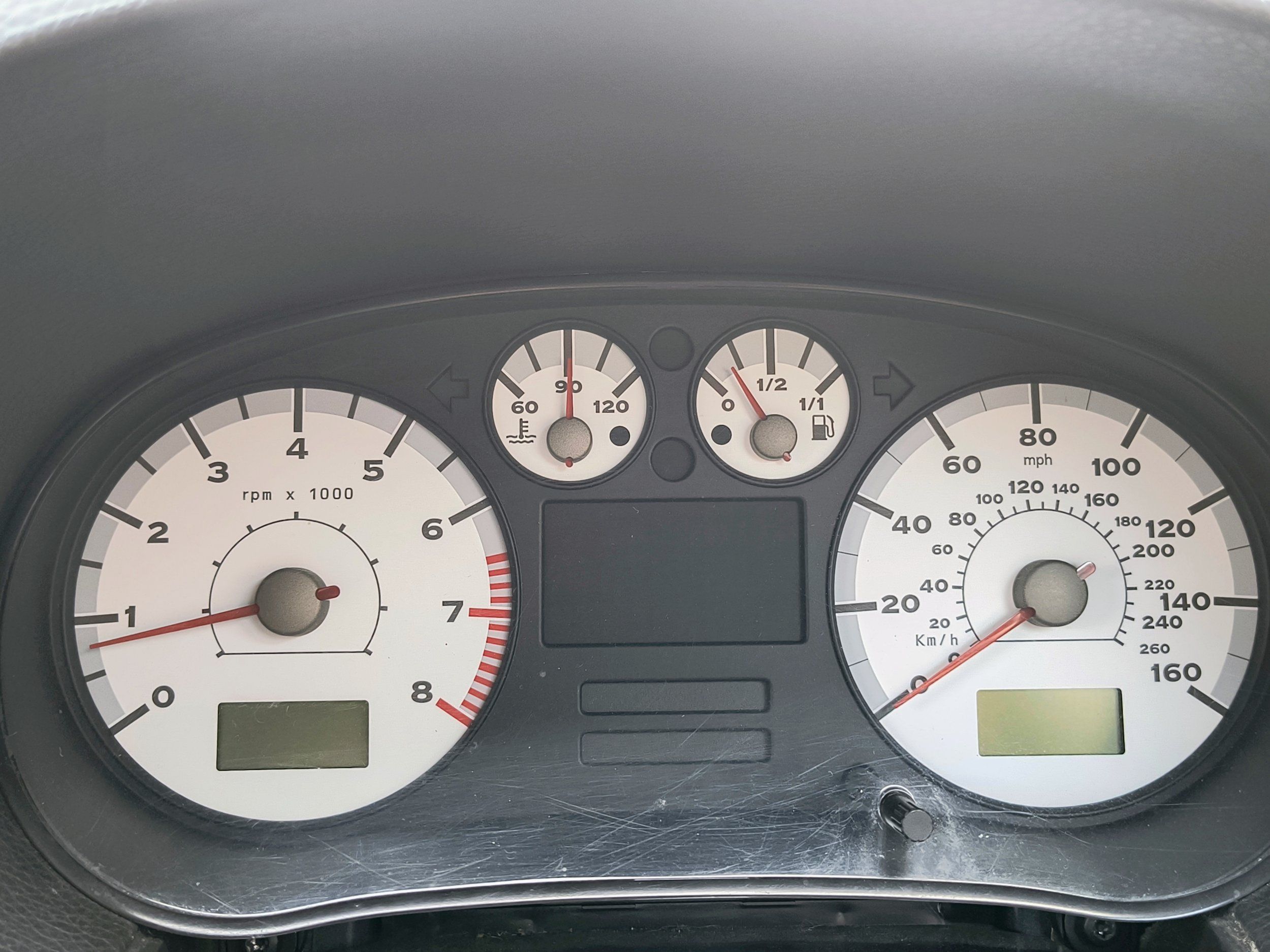

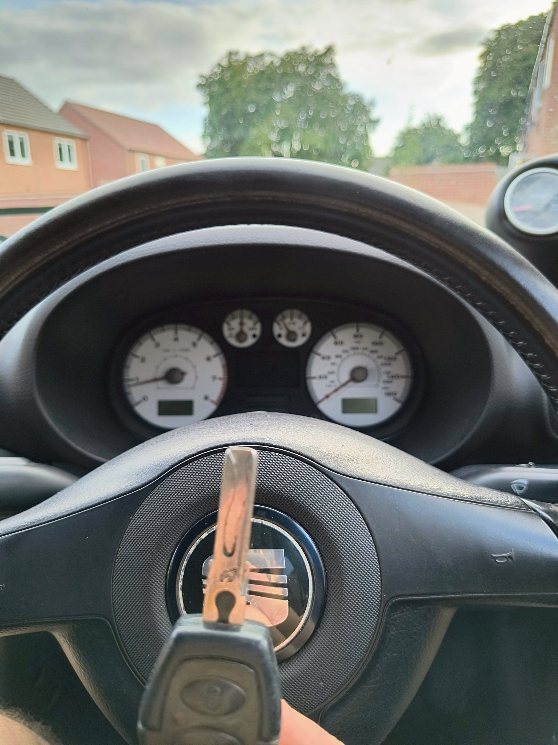

Hi all,
Just wondering if anyone has come across anything similar, AUQ cupra when turning off the ignition and removing the key, the instrument cluster stays on like the car is running, fuel level, coolant temp and rpm guage stays at idle speed when engine off and key removed.
Have attached photos of said problem and will stay on for an indefinite amount of time, max I timed it for is 45 minutes but can sometimes still be on the next morning
I will be cleaning all grounds in engine bay and plenum tonight to see if it makes difference, TIA

Full list of earth points here for you.
Beautiful, was needing something like this, I imagine it's something to do with one of the earth's under the dash, as it had previously been stripped to track I think then owner before me put it all back together, think one of these will have been missed or is poorly earthed. Will update when get round to it, certainly not today's job haha
Just to update all watching, cleaned all earths in engine bay and plenum and no change, gonna start stripping the dash to see if any earths have been missed
I had a similar problem to yours. When I turned the key to turn off the car, it kept running, only when I pulled the key did it turn off. I changed the ignition switch and so far I haven't had a problem.
