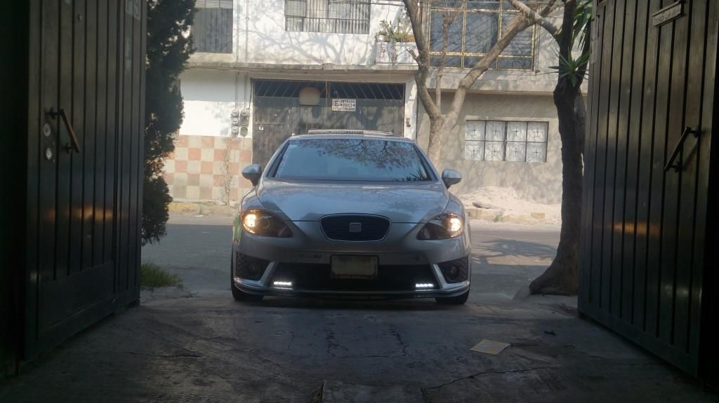

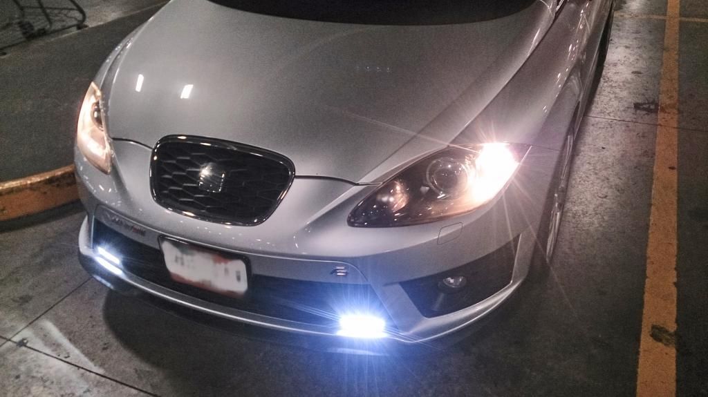

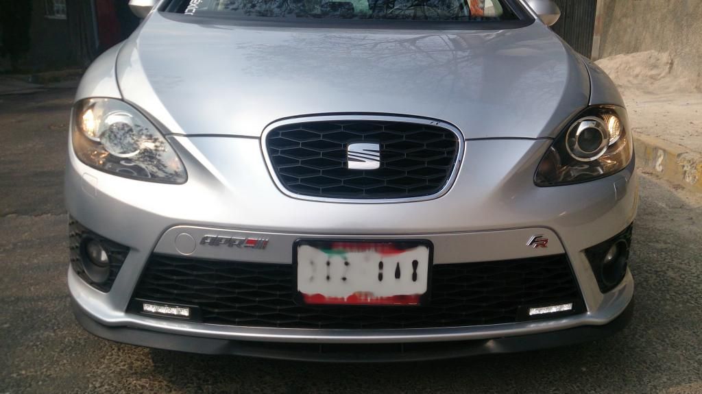

Since no one ever really posted a single pic of the actual DRL LED kit (ZGB1P0052190) installed, here's how it looks on my 2011 FL FR (for informational purposes :p):
Judge them yourselves.

How do they wire in? do they just connect up to the ignition live so they always just come on with the ignition, or do they connect up to the existing DRL wiring so they are "intelligent" and can be configured through the MFD the same way as the standard DRLs?
VAGUE
Wanderer
Sep 30, 2012
187
Mexico City
They're connected separatedly from the existing DRLs; if you disable the DRL function from the MFD, they will remain on while the existing ones will extinguish.
These are the only conditions where they'll light up:
Engine on is a must
- When headlamp switch is in the 0 position.
- When headlamp switch is in the AUTO position (if available) and there's enough daylight to have the DRLs activated.
Also, when the headlamp switch is in the 0 position and the engine is turned off, they'll stay on for a couple of seconds serving the Coming Home feature, however, their configuration seems to be independent from the actual MFD setup that controls the rest of the lights when the switch is in AUTO position.
