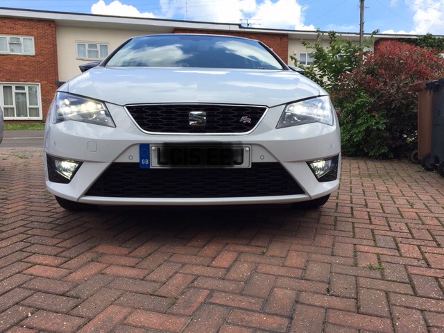

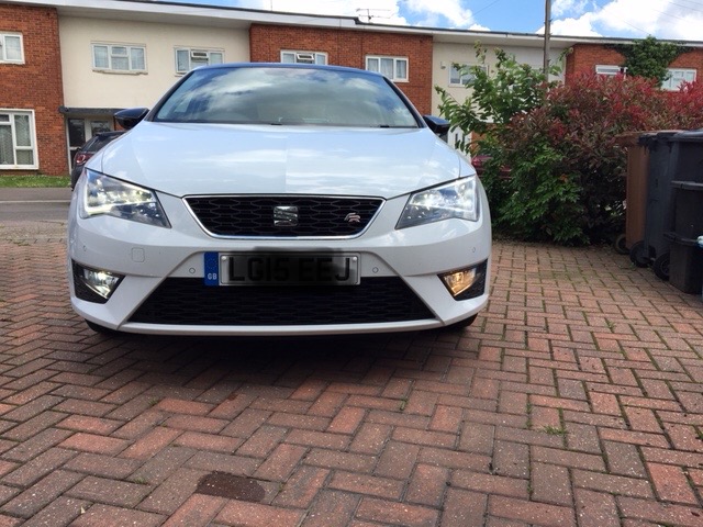

Installed my bulbs and found that the passenger side was not too difficult even with the washer bottle. Managed to get hand in and onto the wire and twist bulb in / out.
Have included a couple of photos showing new / old and both new.
Looks much better! I have enabled the cornering fogs with OBDeleven.
Reactions: Ratocego

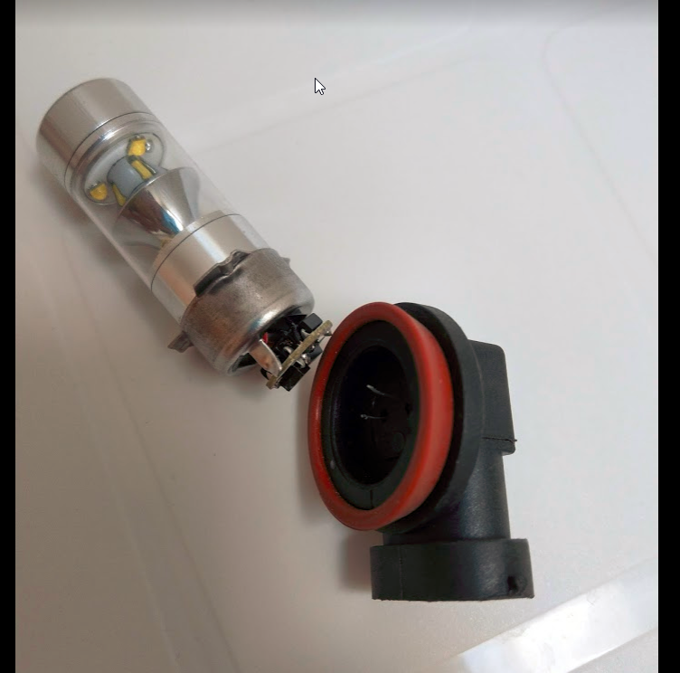

Managed to disconnect the Halogen bulb,this has happened when trying to put the LED one:
What a saga im in! should I bother to try to solder it? dont even know where those 2 connectors from the housing link, as there are 4 on the lamp side), or just get a another one?

Oh no that's rubbish! You could try pushing it back together and then put it in the driver side to check as that is really easy and quick to do. I am guessing it got caught on the back of the light fitting as you were trying to wiggle it in but surely it should be more robust than that?

I can push it back and it stays, but the problem is that the wiring from the lamp that meets housing is broken, so it would need to be resoldered.
Sent an email to HorizonLeds, and they said I could send this one back so they can process a replacement, so Happy Days!
Now I have bought previously some crappy Leds that I did managed to replace on the driver side, but never in the passenger one, in the end gave up and sent back as there was no output and the color didnt match.
Now after checking you guys pics with these Leds, I decided to give another try, so bought it but by mistake only got one, so ordered the second yesterday and this morning attempted the passenger side first as it was the one I couldnt replace last time.
I did just as you described, but this time used my right hand to pull the washer a bit, just enough to be able to pull down the connector with my left hadn, and man this time it worked. The worst part was yet to come, as you said it was hard to plug the connector back onto the new fog light, and in one or two attempts, it broke...
I am pretty sure I wasnt being brute, but well I am waiting now for the second one to arrive any day now and ill give it a go, I havent even bothered to plug the OEM Halogen one.
