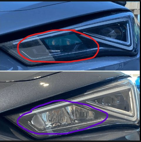

Hello, the cupra Leon can be equipped with the led matrix headlights.
But the look of the headlights is the same as the led high in seat Leon, is there any way of unlock the matrix functionality in seat leon? If the hardware is the same
Thank you
Nope, the size of the lights is the same (good to know for retrofit) but the light structure is different pay attention to the high beam section in attached picture marked RED (matrix) and PURPLE (standart). Also good to know the lights won't turn as you can see from this video we talking here about pretty much matrix led only for the high beam as the low beam is fixed and won't turn while turning in a bend. In my opinion waste of money

Nope, the size of the lights is the same (good to know for retrofit) but the light structure is different pay attention to the high beam section. Also good to know the lights won't turn as you can see from this video we talking here about pretty much matrix led only for the high beam as the low beam is fixed and won't turn while turning in a bend. In my opinion waste of money

Thank you very much for the precise information

Thanks for this comprehensive explanation, because I couldn't quite figure out how to identify the matrix. I just went to the garage and checked; I really do have a recessed module with two lenses, like you circled in red.
