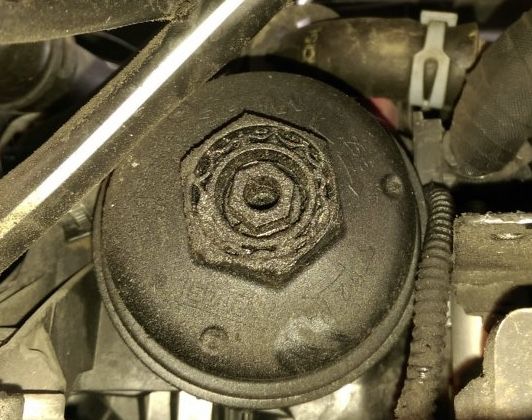

i‘m going to change the oil and oil filter on my 2015 2.0 tdi soon.
l’ve managed to get the under tray off and it looks like it’s going to be a bit messy taking the filter cap off.
I did notice a small hex inside the 32mm hex, (looks about 13mm) and am wondering if that is a drain screw for the filter cap.

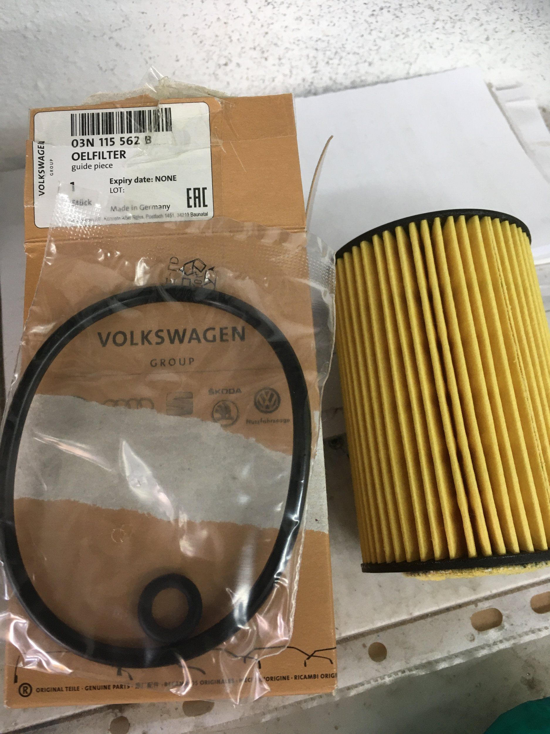

Yes, the small o-ring is for the small plastic drain bolt, the large one for the filter housing. Use some new oil to lube both o-rings before fitting. Make sure all mating parts are spotless.
Thanks.
I did it yesterday and did lube the o-rings with new oil etc 👍🏻

The other shiteness about that little drain plug is that it's soft plastic and easy to round. Then you've got no choice but to remove the big cover and it's messaroony!

Hi all, does anyone know the fitment size of the outer bolt on this cap, its unusually sized so im going to need to order a socket specifically for the job as none of mine fit!! any help appreciated, thanks :)

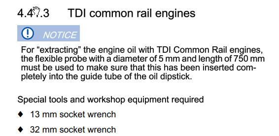

Its just a 13mm - though mine has seized and rounded so suspect yours has had a similar fate which makes the socket a tight fit - best to use a 6 sized 13mm as it's only plastic.
I have to just remove the whole cap (32mm socket) and deal with the spillage! Even with the cap in a vice I can't remove the centre screw so I will get a replacement cap next oil change.
