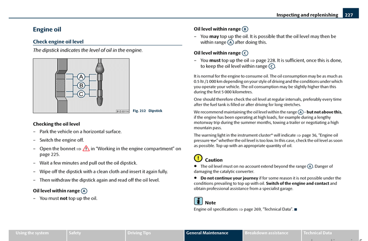

I'm well within their crazy 1L/1000km
I do approx 10,000 miles a year and a 4L bottle of oil lasts around that
I didn't know they had a list - would explain why the garage use that
Its roughly £50 a year I'm spending on oil (excluding servicing) so fortunately not a crazy amount at the moment!

Their allowance is actually 0.5L /1000km - which is the same as 0.5L /620 miles or 1L /1240miles.
Looks like you're at around 1L /2500miles so around 0.25L /1000km which is half the usage that VW say is the maximum.
FYI; I keep a log of any oil I add and the mileages - and over the last few years i'm averaging about 0.16L /1000km.
I might start doing the same, good to know I'm not at the limit then!
