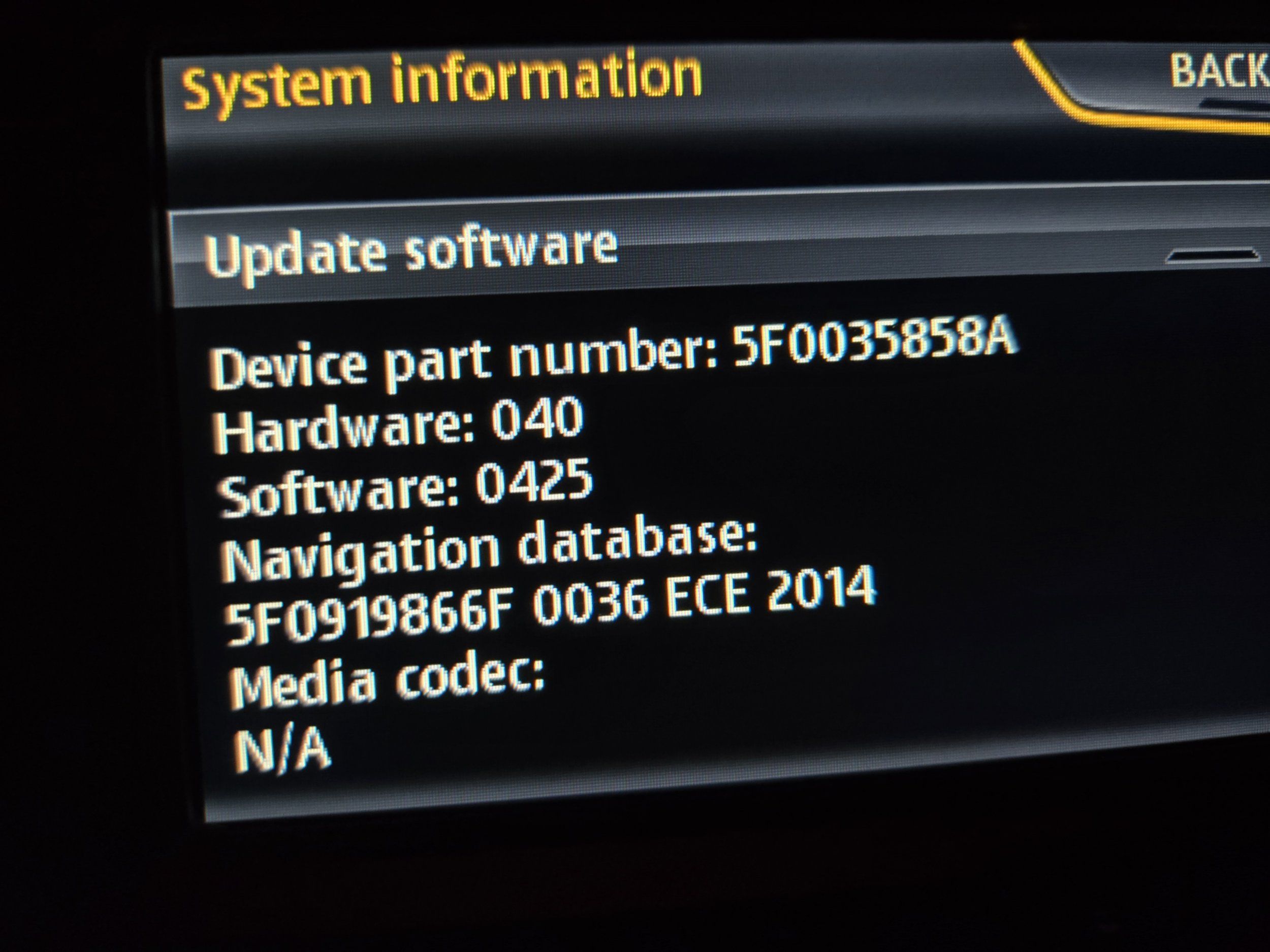

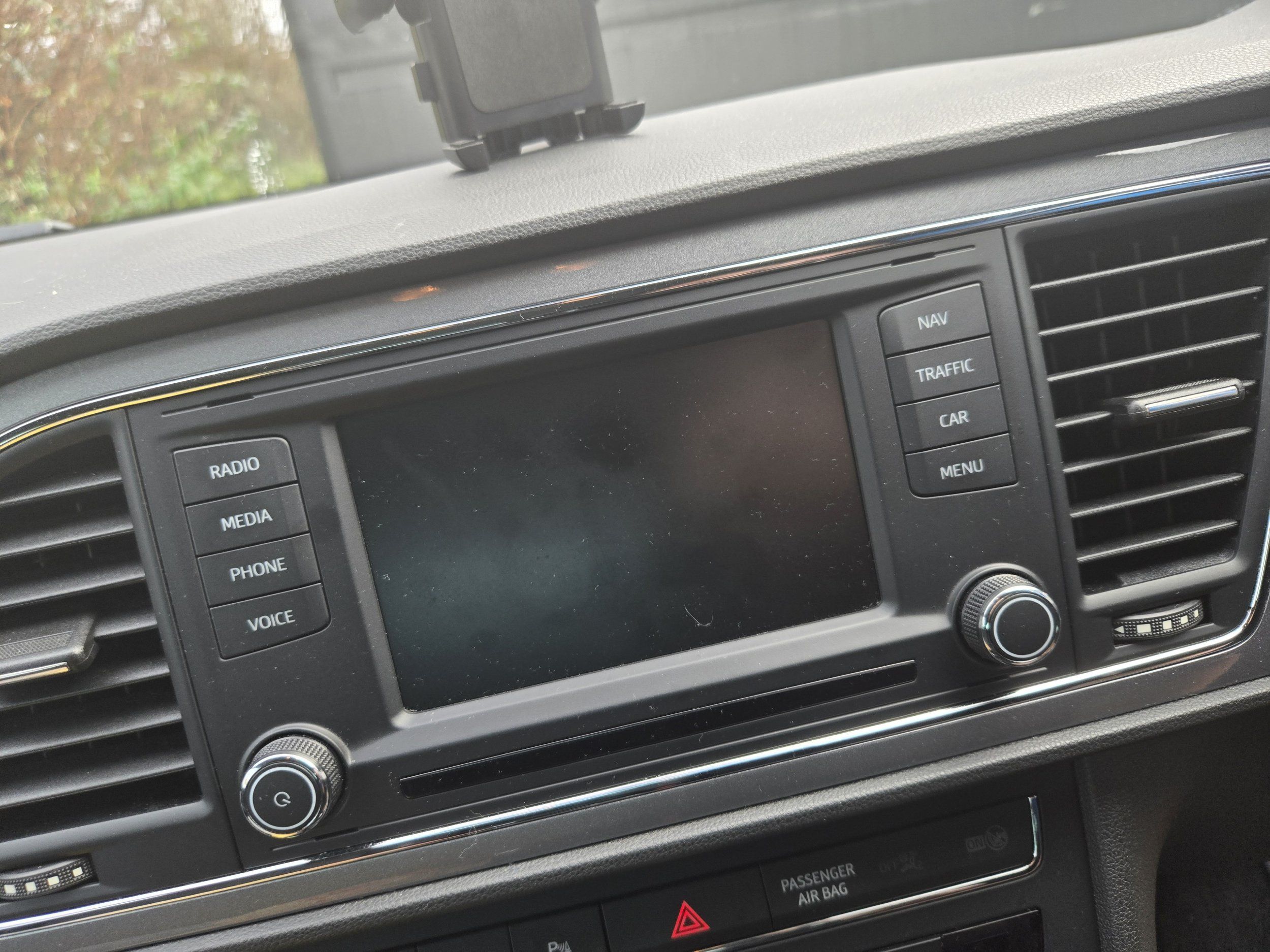

2017 should already support Android Auto & Apple Carplay

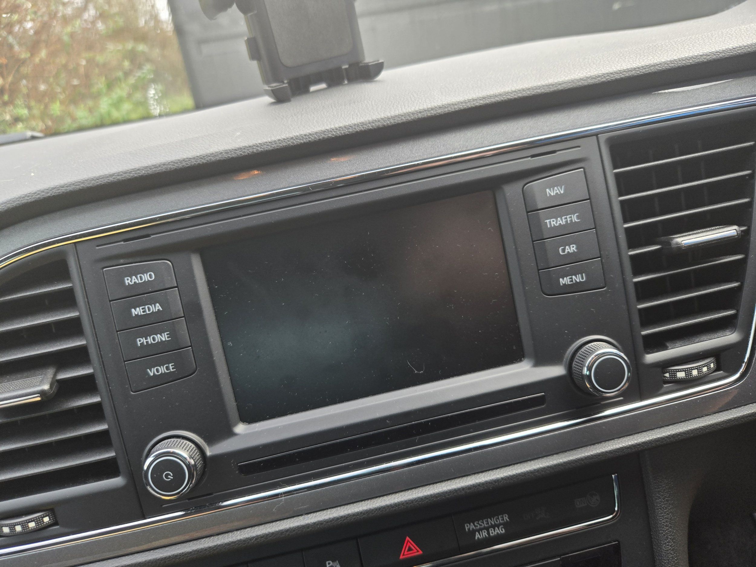

Take a picture of your infotainment unit
That’s MIB1, that isn’t factory fit. Somebody’s swapped it for the MIB2 it should have…

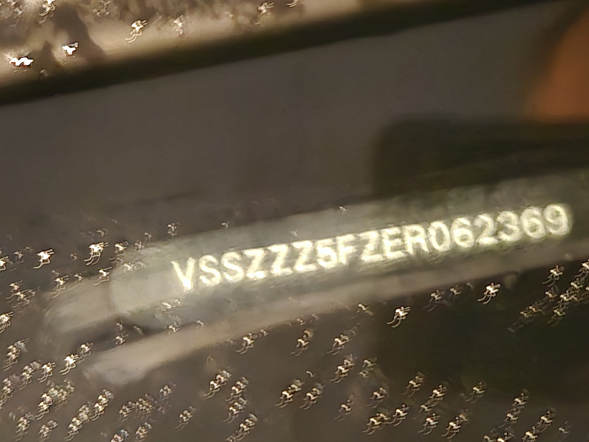

Or, your car isn’t a 2017. If you send me the VIN I’ll check for you
Not sure exactly where the vin is. It is dark right now so I might have missed it.

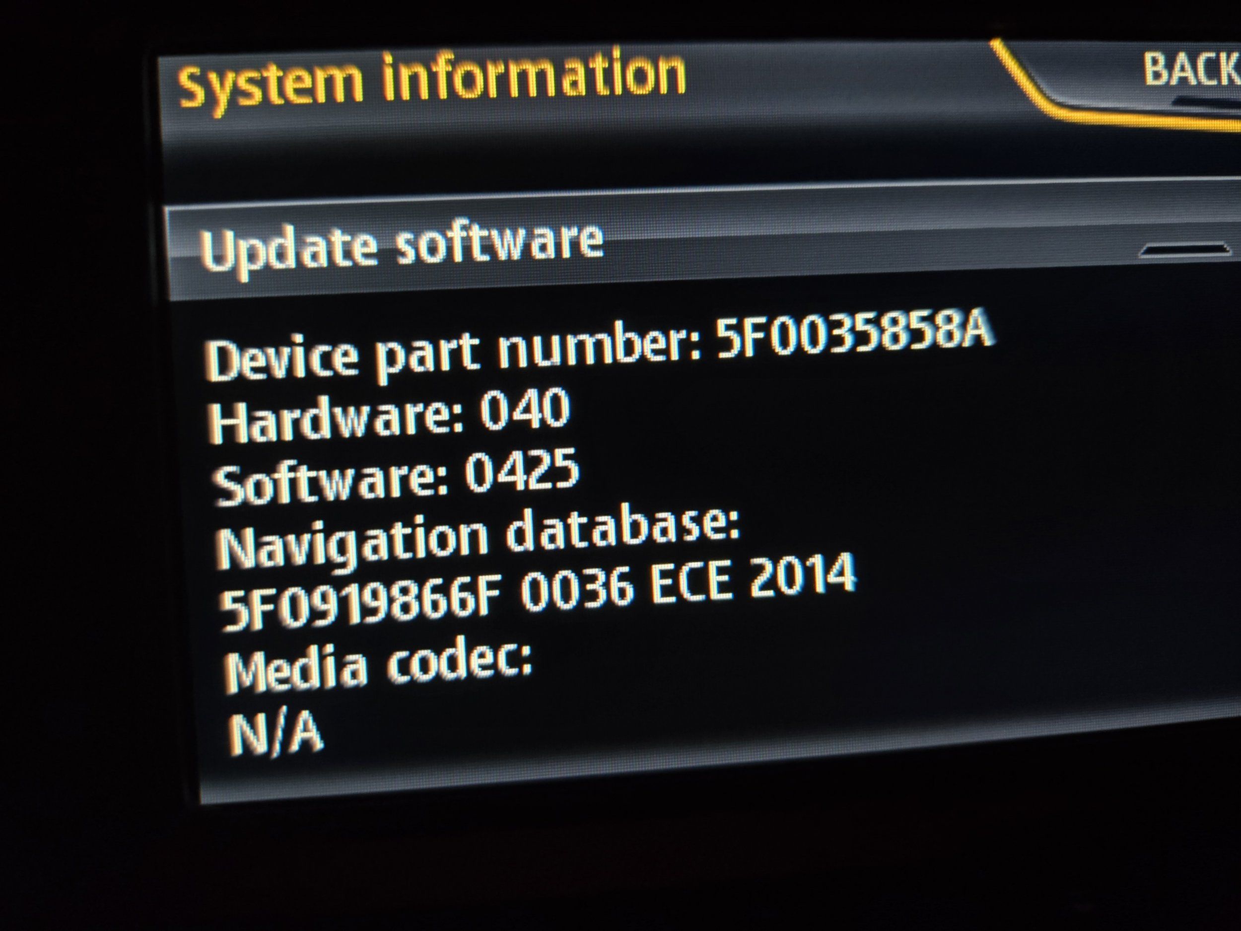

Also a picture from the system.
I am dumb. I don't know why I had it in my head that it was 2017.
