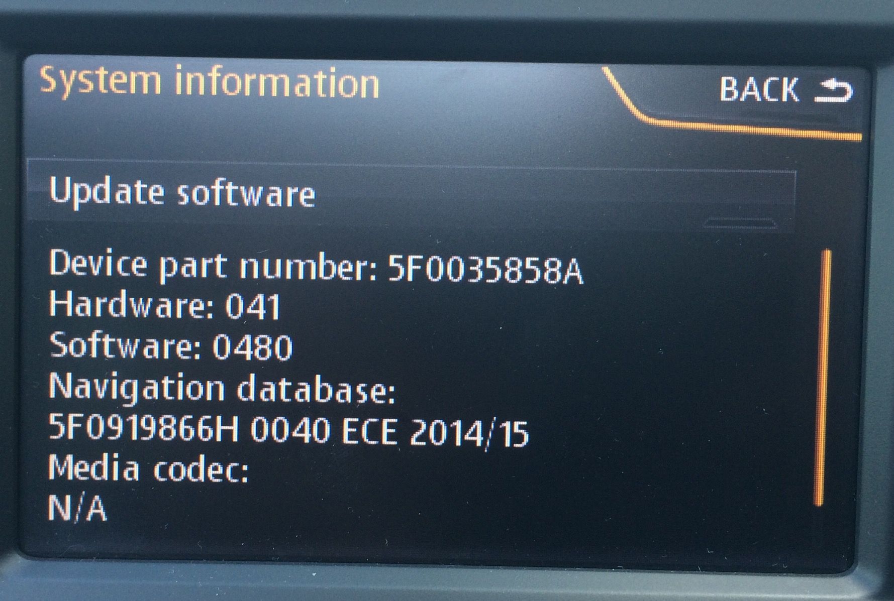

I performed the MIB1 update today following the instructions on the link to post 72 and subsequently cleared all error messages using OBD11 including the confirmation of installation change.
Am I right that once complete you have to revert to the original SD card? Sorry if this is a stupid question, but is this update software only and nothing to do with map updates? Leaving the update SD card in gave me a message “please insert a data medium with valid navigation data”
My system now is as per picture. If someone could let me know if I’ve not done the update correctly I’d appreciate it.
Thanks

Hi,
Thanks
Yes you need to put your original SD card back in because that's where the navigation data is stored (i.e. maps).

That's looks like correct update. Enjoy
