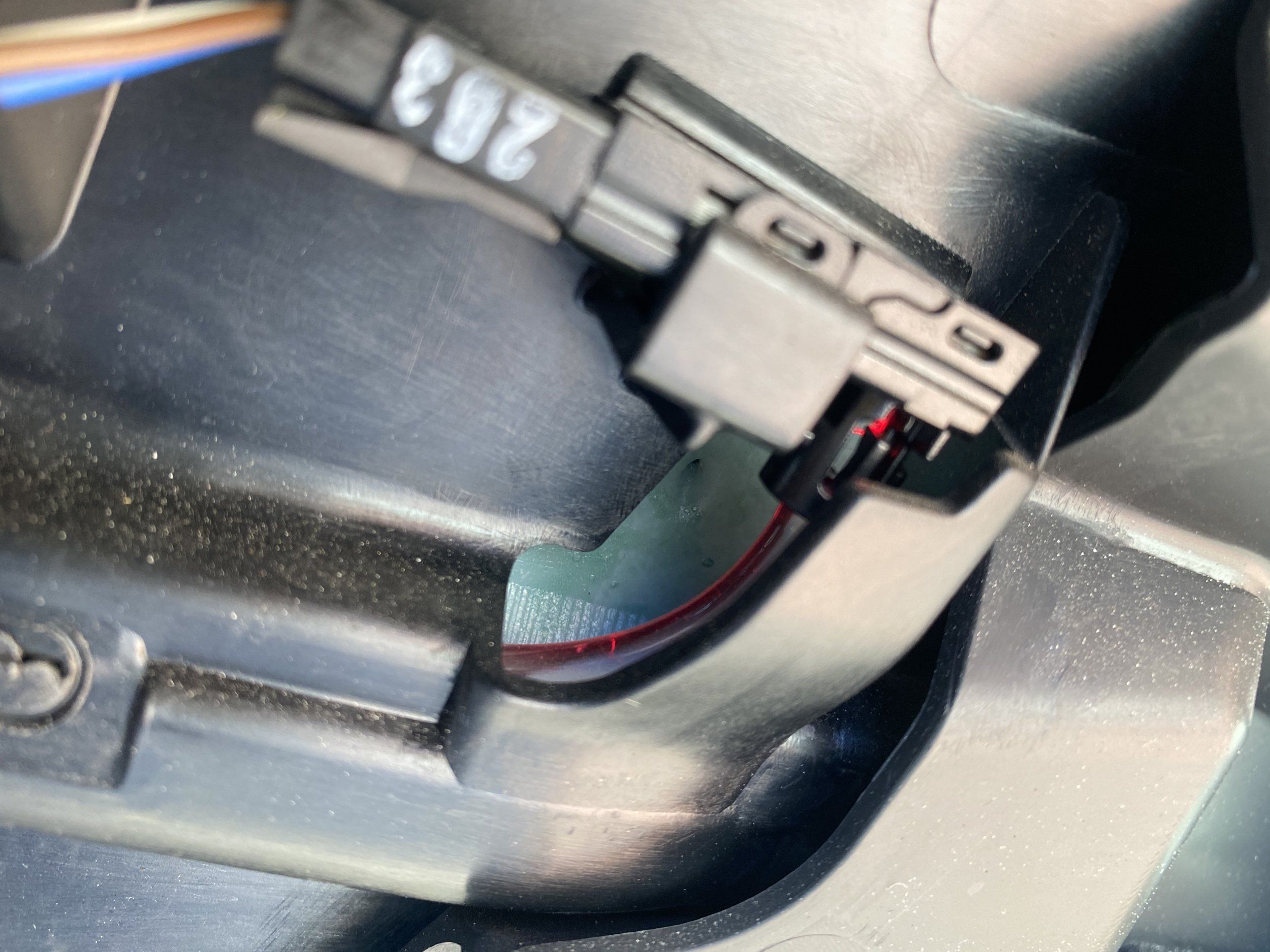

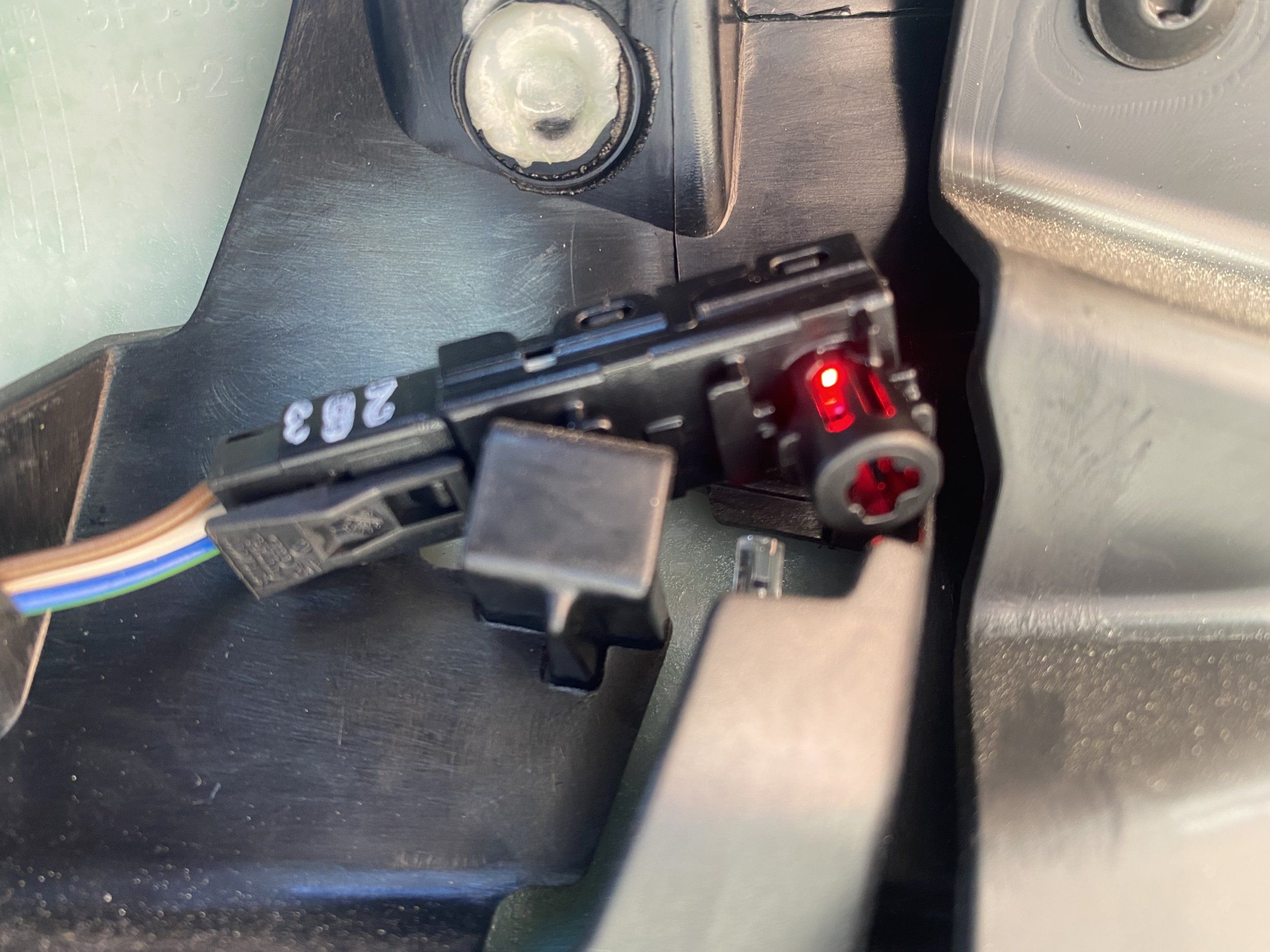

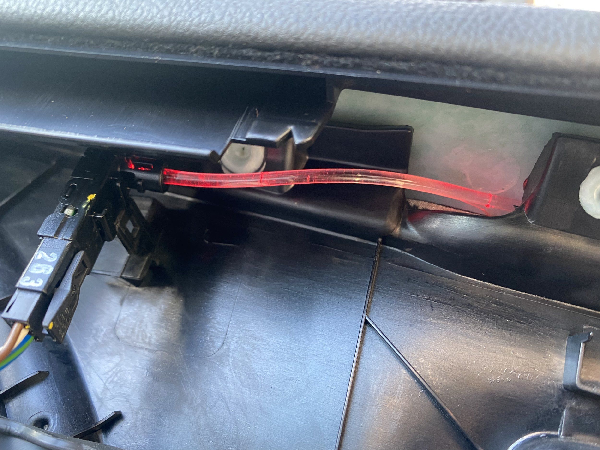

Hi all… so I taken my door card off they are both plugged in and it seems to be bright starting off the tube then in the middle there is no light can it be the bulbs on the way out or the tube
