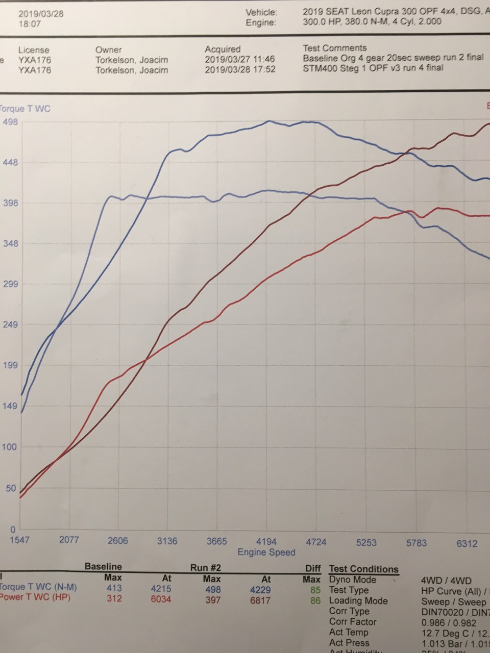

CupraSwede
Feb 28, 2019
19
18
Sweden
Here is the picture of the graph from the dyno. As KernelOkey said. Stage 1 at Stertman is: a new turbo and a tune of the engine and DSG.
Quote from their page on F-B "Brand new Seat Leon Cupra ST 300 OPF 4x4 with our popular STM400 hybrid turbo and STM Stage 1 calibration, this is probably the first OPF car in Sweden that has a hybrid turbo and tune."
