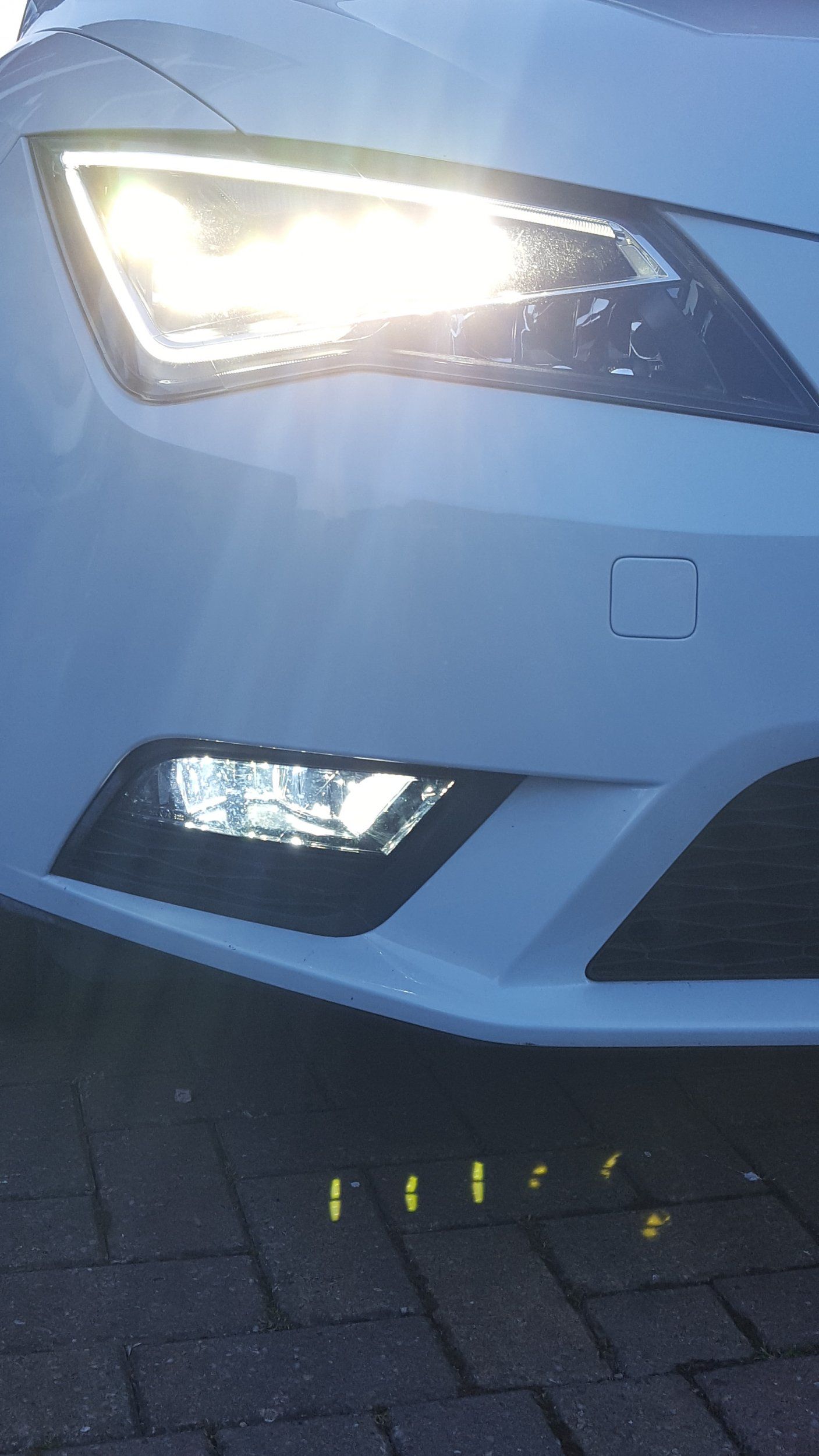

Agree about the MY2015 - my old 64 plate had factory LED package being an SE Technology, but it did not have headlight washers
