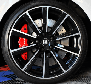

340mm standard Cupra caliper for full cast iron disc (same as Golf R brake)
370mm performance pack caliper and composite disc (alloy bell pinned to iron rotor)

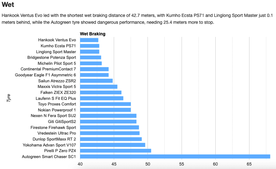

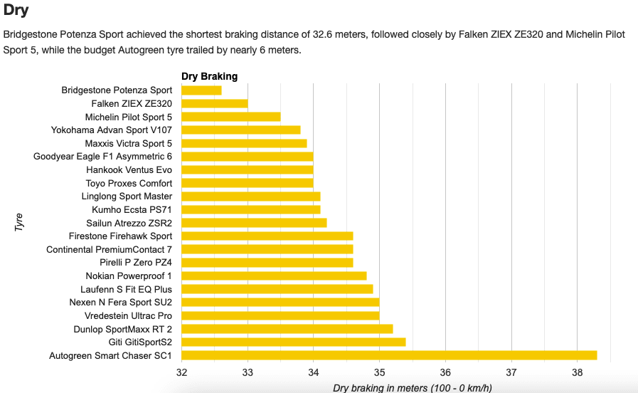

If you are looking at reduce your stopping distance (increasing your decel) - The standard (correctly functioning) brakes will be able activate your ABS so you should first fit decent tyres as the brakes aren't the limiting factor.

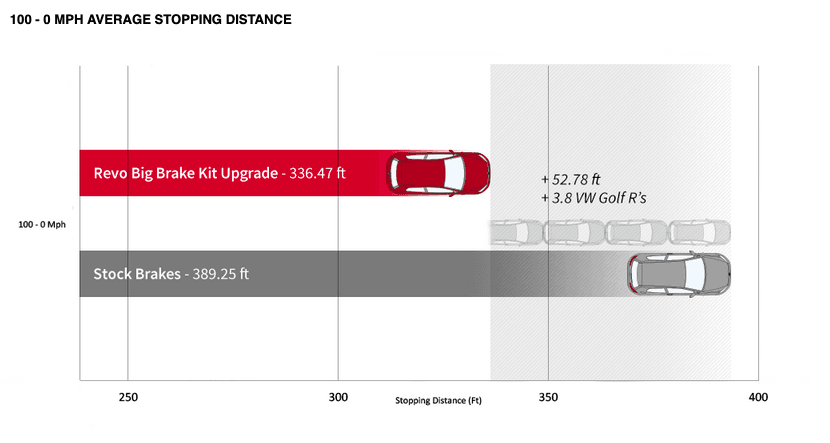

Now I use the car on the track more than on the road so my requirements are all about being able to carry on working on the track after multiple high speed braking, and Revo sold the kit with the DS2500 Pads. Now these pads are ok but do not last very long so I have replaced these with race orientated pads and they work much better, still working out if they last longer.
But I checked the Revo big brake kit web site and they still advertise that they do stop quicker.
Now I did not buy them for this reason more about stopping brake fade and performance whilst on the track (which I am very happy with)
