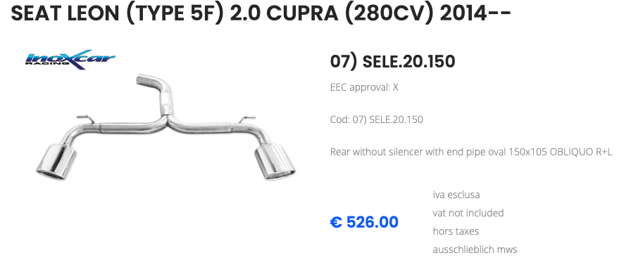

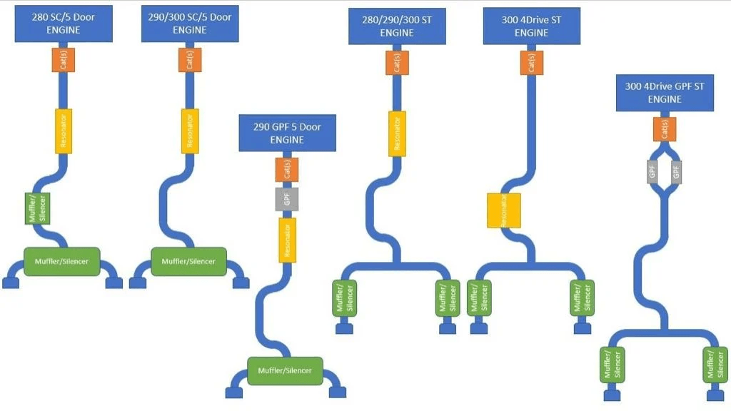

Is the exhaust layout the same for 280, 290 and 300HP Leon Cupra 5F (non ST version)?

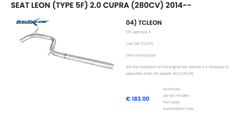

I want to mount Inoxcar exhaust without rear and middle resonator on 2019 Cupra (290HP) with OPF, but the Inoxcar exhaust is originally only for 280HP "older" version. I know that the end on the OPF will need some adapter but the rest of the exhaust should be the same or am I wrong?
Thanks in advance for your input.

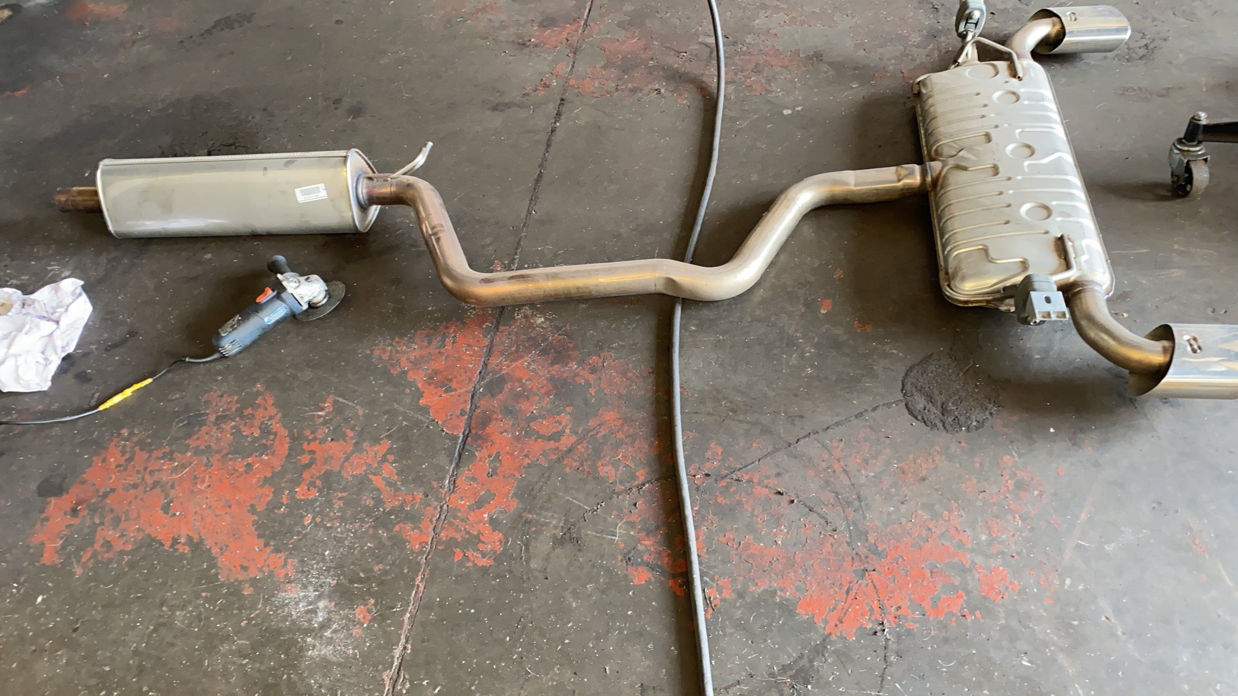

The 290 (non-GPF) and the 300 are the same but the 280 has an extra silencer.

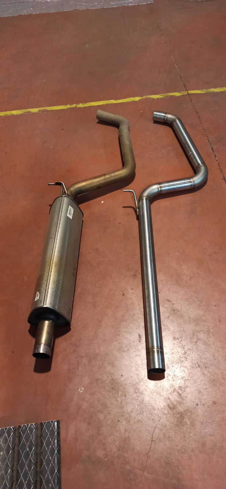

So this means that I could technically mount exhaust on photos to my Leon Cupra 5F with GPF? Curves and length is basically the same?

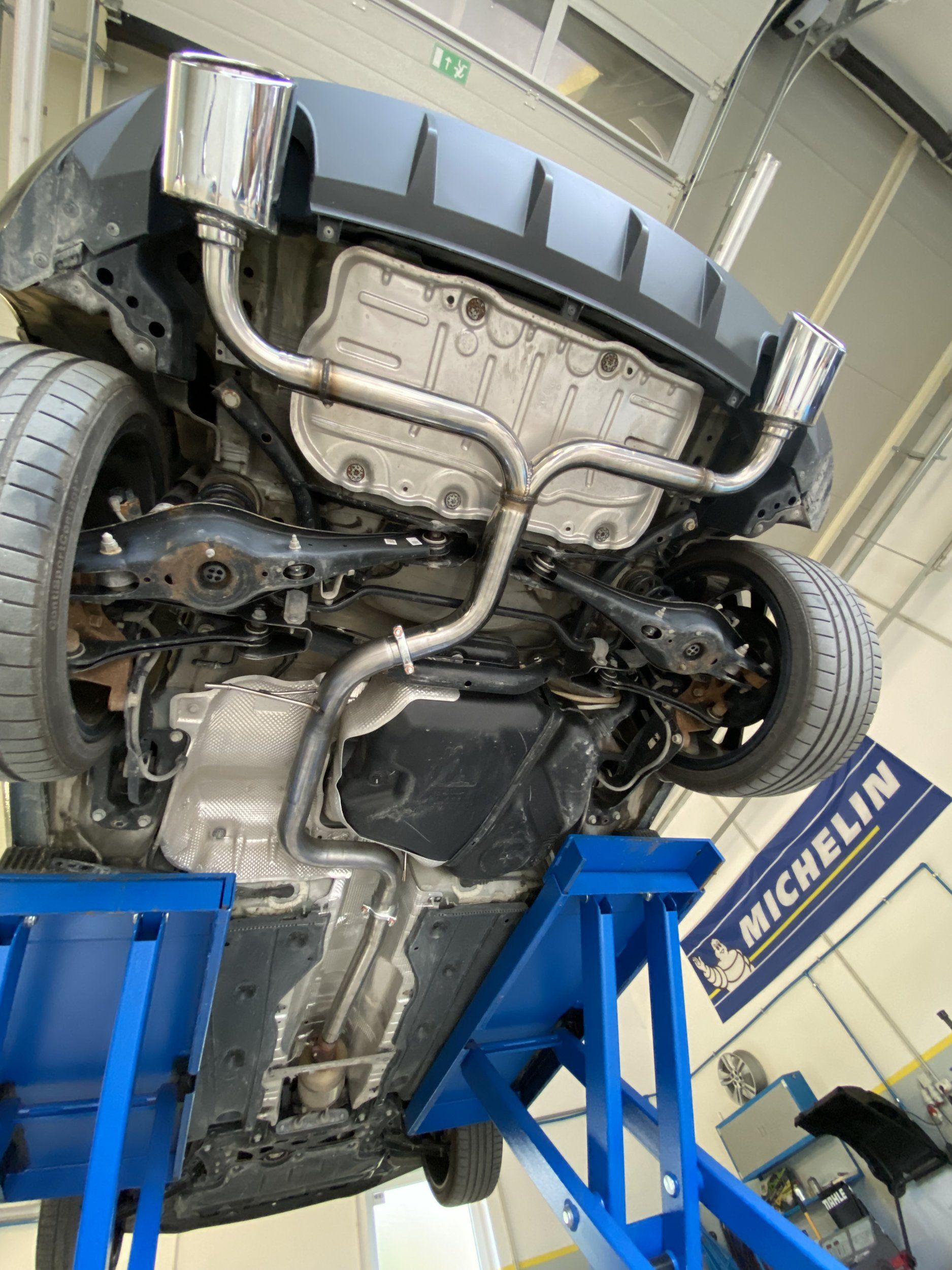

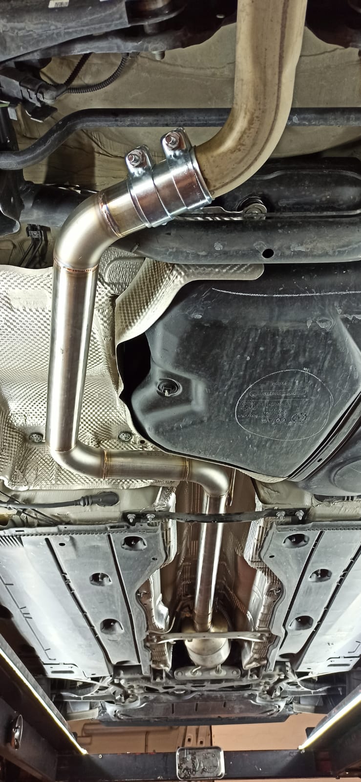

hi, first, sorry for my bad English.
There is a little video from my Cupra 290 with opf and without resonator. The video is recorded on CUPRA MODE. If you put the mode in Comfort, is like a standard Leon Cupra. I expect help you to decide.
