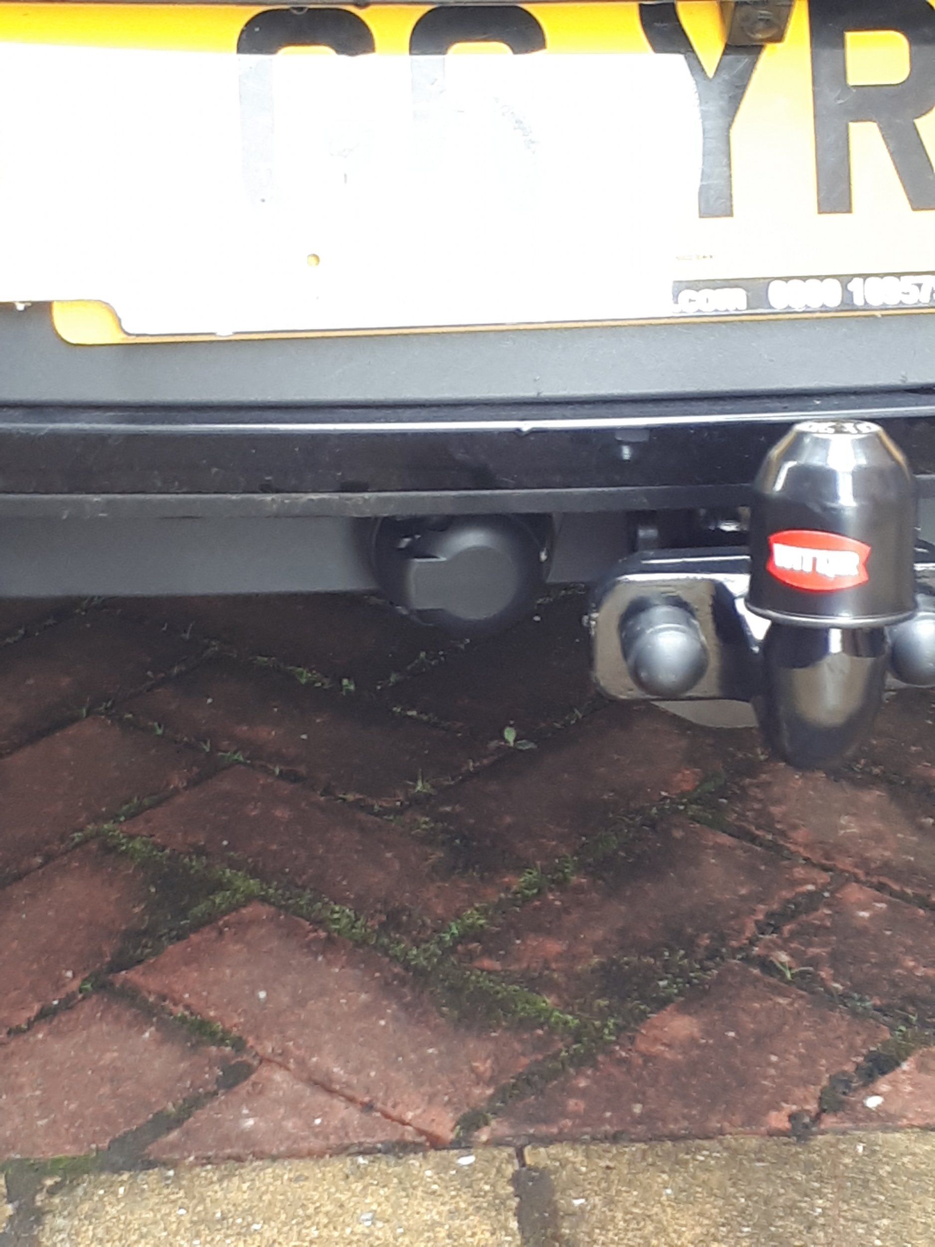

hi this my towbar!

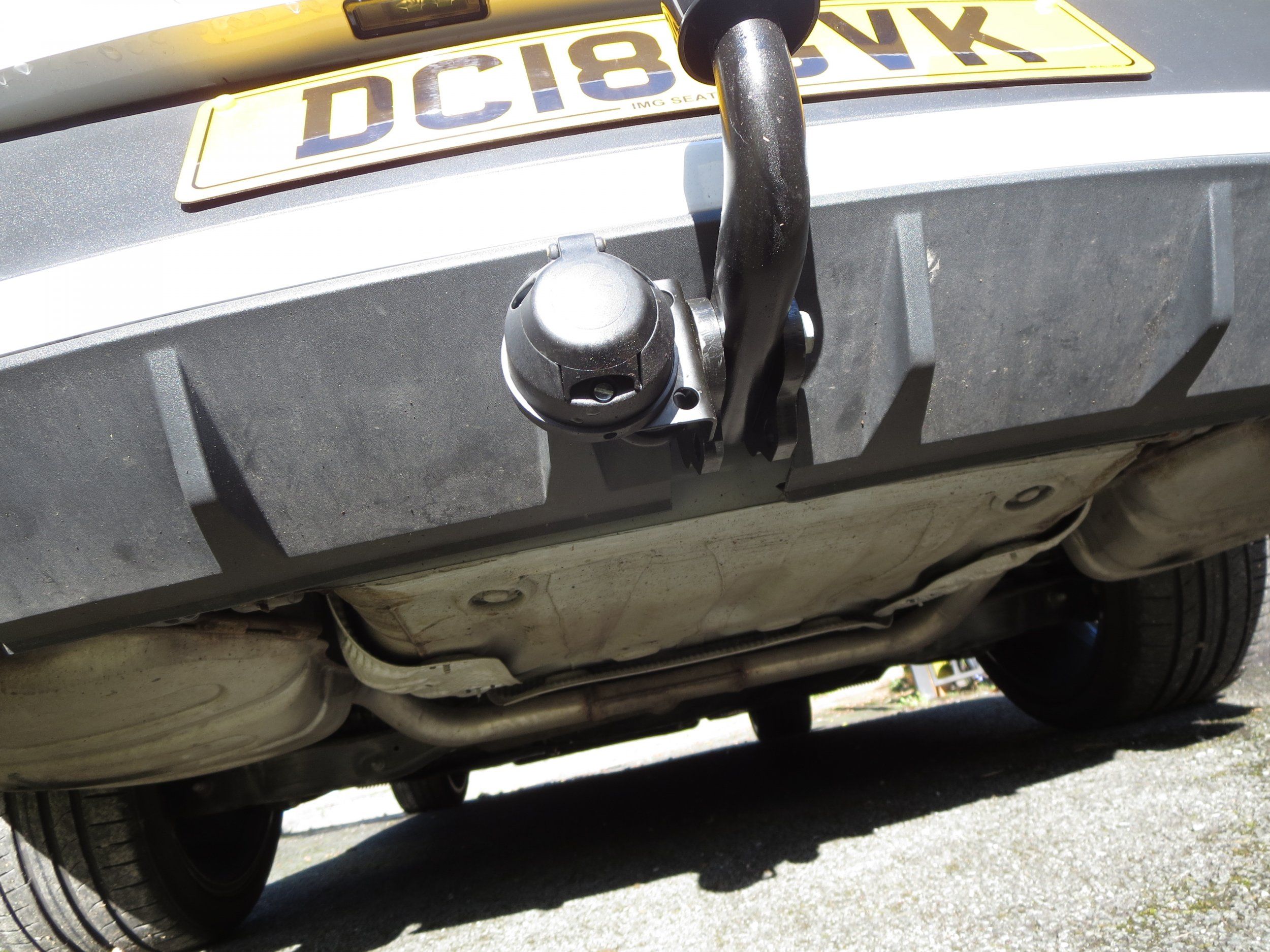

The company used my reg number to quote for the towbars so I’m not sure on specifics. Looking underneath the car I can confirm the exhaust does not get in the way of the tow bar or new rear impact bar that has been fitted.
Lookers told me from the outset that a tow bar could be fitted, your contact is wrong.

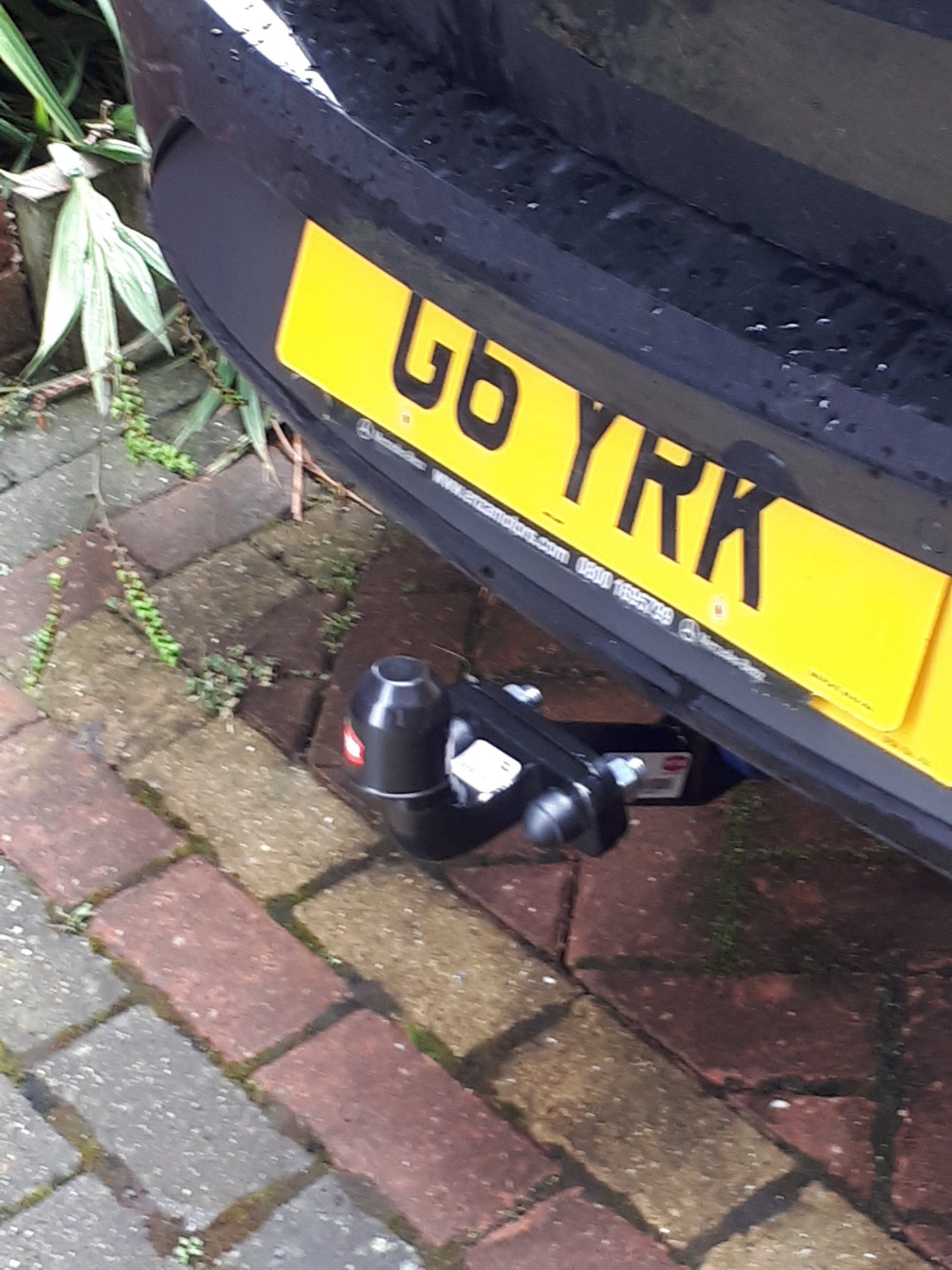

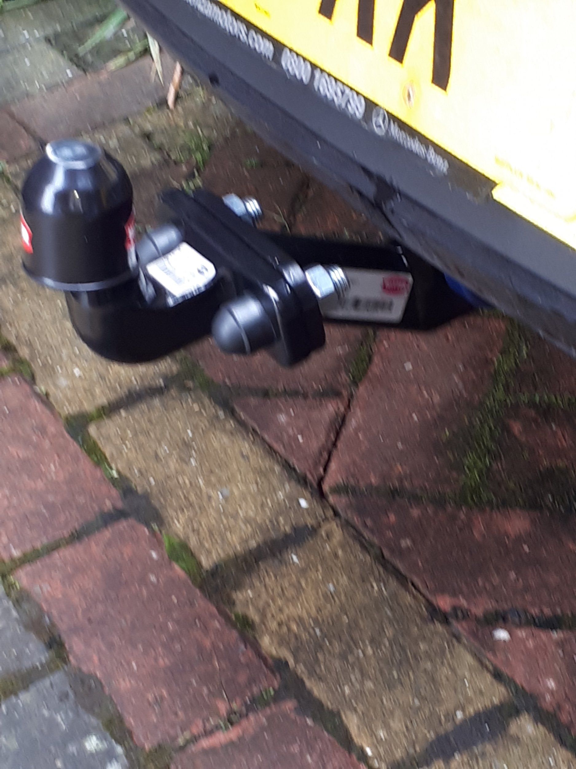

So finally I have a towbar fitted. Turned up at the shop as an fr st was being tested with a Witter attached. The detatchable bar was not obscuring the number plate so I asked how it was regarding fitting. After a quick chat and a ‘no problem’ I decided on the witter as if it’s a wet day of riding/travelling I can leave the ball in place and still be legal. Very easy to attach and detach the bar , first attempt in less than 5 seconds. I think the cutout is ok , has to have room on the right to be able turn the locking mechanism and room on the left for the electrics swinging arm. I’m pleased with the result.
Compared to the freetrack cutout it’s very neat.

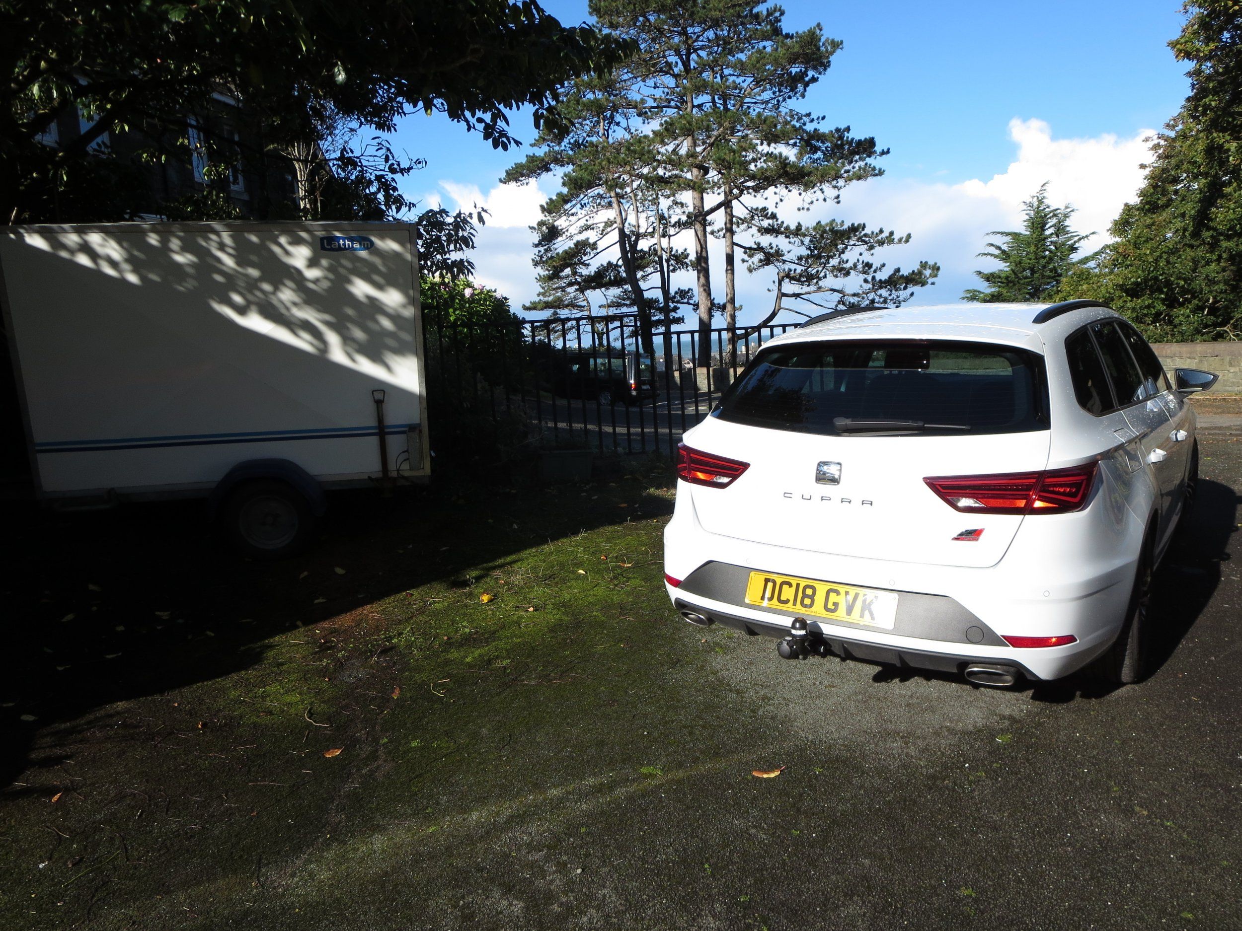

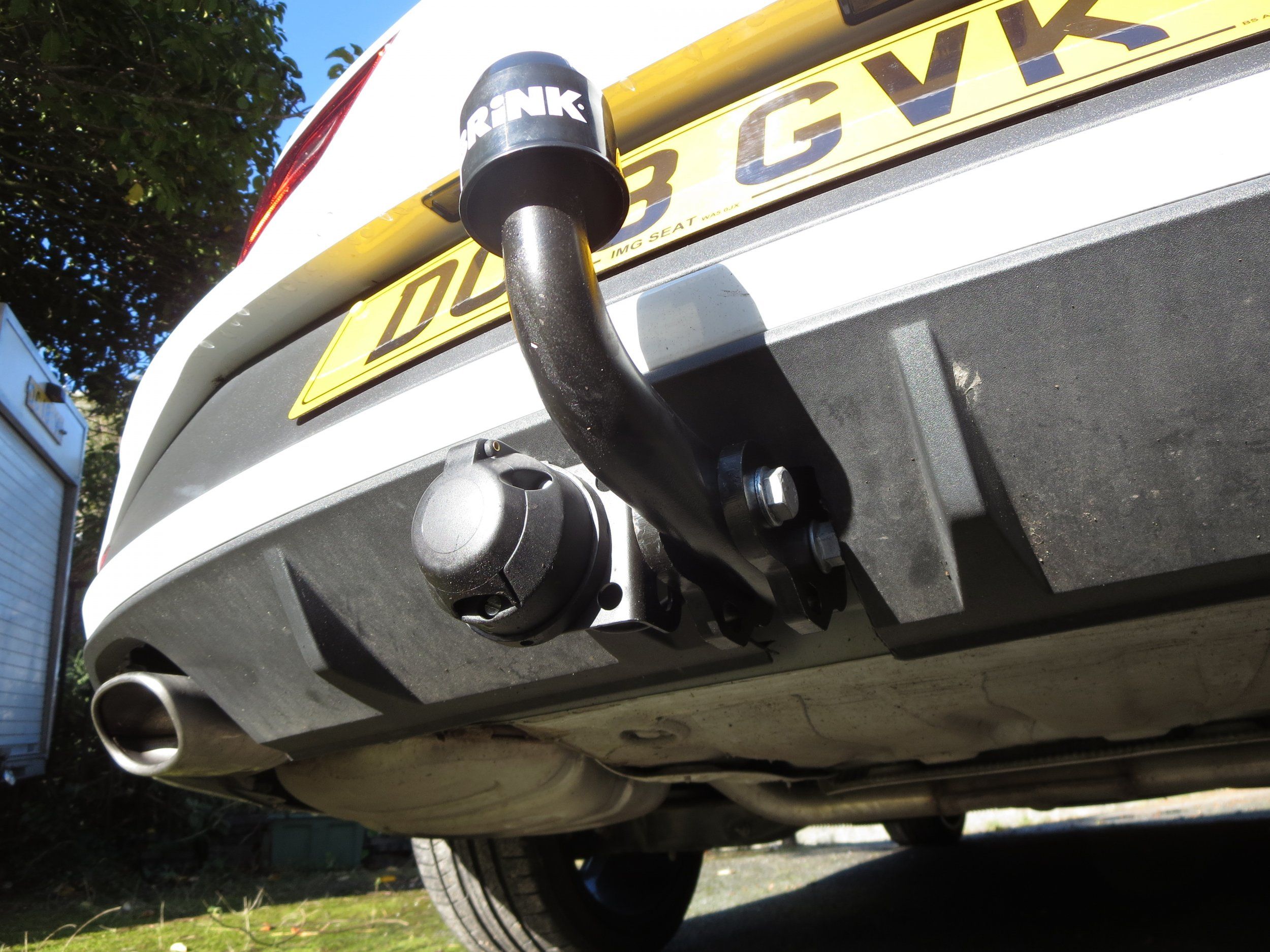

Got a Brink towbar fitted to my cupra st 300. Was kind of advised not to go for the coded wiring as they had encountered problems with the re coding. Its not detachable but you can unbolt it. Reversing sensors dont see it, and no issues at all driving forward with my box trailer. Only issue is reversing as it obviously thinks the trailer is a brick wall and if you put the brakes on the car stops like with the handbrake. You then have to drive forward an inch or two before reversing again. Not a big deal and doesn't bother me. See photos.
Good to see there is a choice of towbars available for the cupra. I've also left mine on since having it fitted, sensors are not picking it up.
I played with settings in the management screen and have cancelled the auto stop feature. I can't remember how but it is possible.

If you have the ST it must be possible as we’ve had them fitted. Witter have a choice that fits. As shown you can have a fixed or detatchable.
