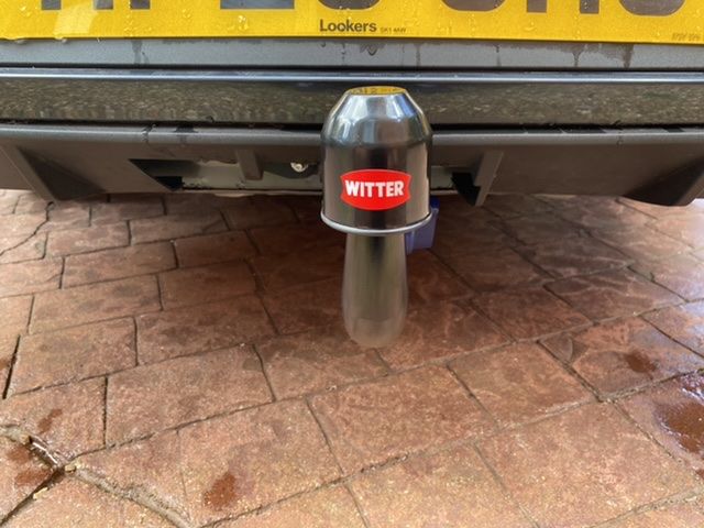

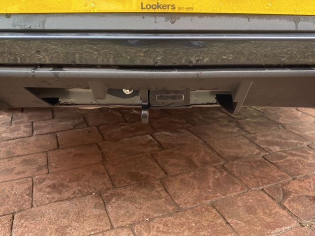

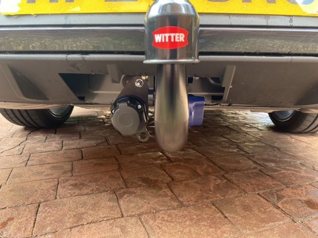

So finally I have a towbar fitted. Turned up at the shop as an fr st was being tested with a Witter attached. The detatchable bar was not obscuring the number plate so I asked how it was regarding fitting. After a quick chat and a ‘no problem’ I decided on the witter as if it’s a wet day of riding/travelling I can leave the ball in place and still be legal. Very easy to attach and detach the bar , first attempt in less than 5 seconds. I think the cutout is ok , has to have room on the right to be able turn the locking mechanism and room on the left for the electrics swinging arm. I’m pleased with the result.
Compared to the freetrack cutout it’s very neat.
