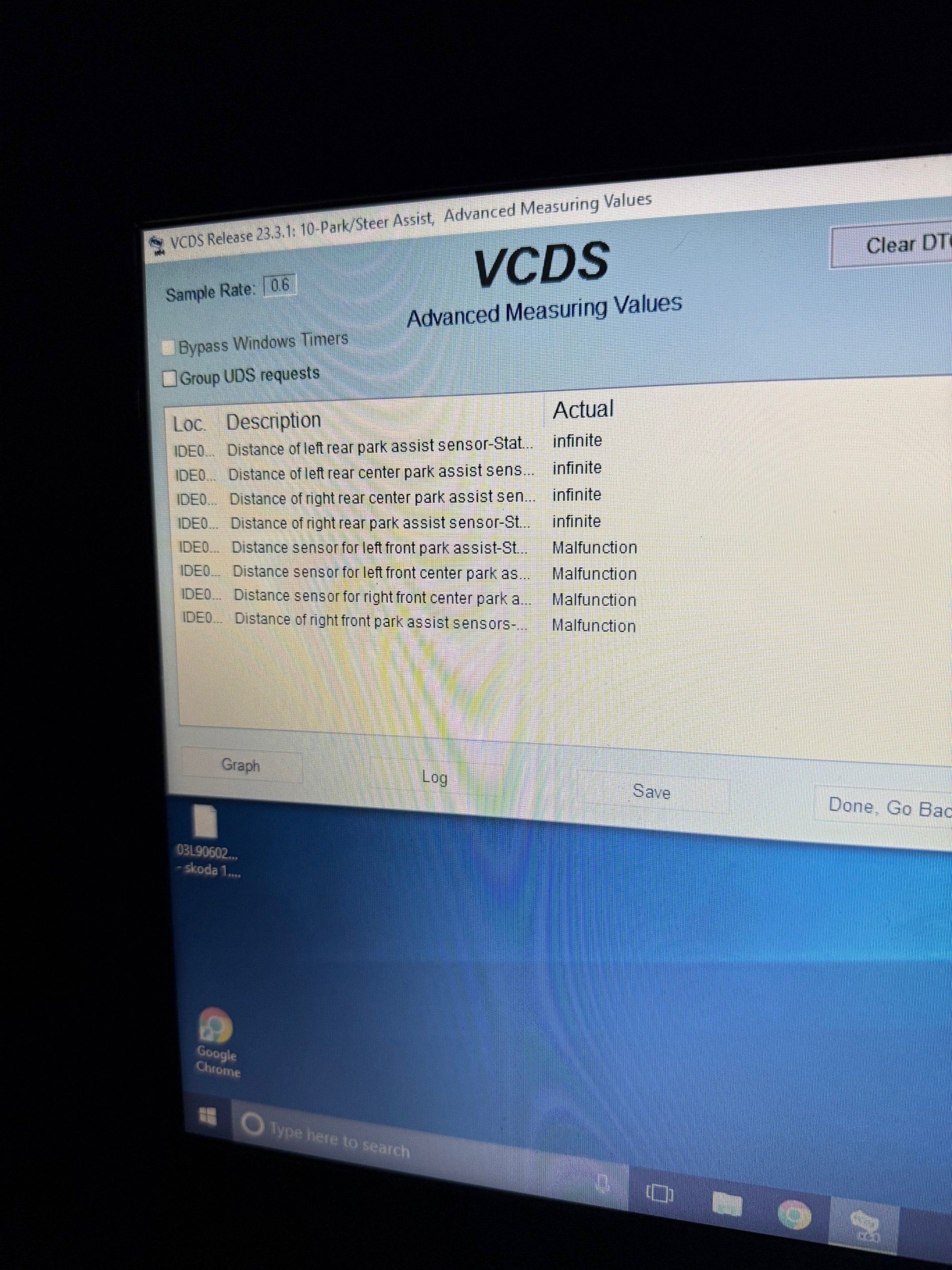

Having done the coding, I am left with some errors and cant for the life of me establish where I have gone wrong. Attached are the codes relating to the Instruments/ Park Assist and also the measures which show a malfunction.
Any help is greatly appreciated.

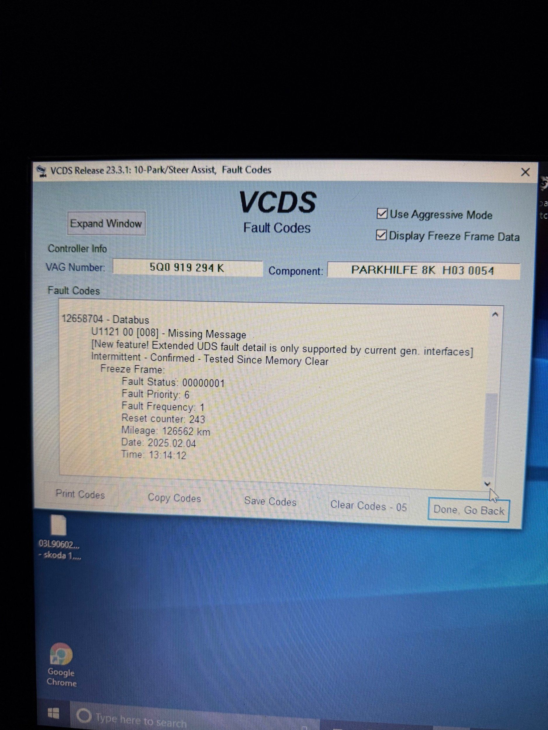

The version of your (hopefully genuine) VCDS lead isn't compatible with your car. You need a newer HEX-NET lead. Cloned leads are a no-no.

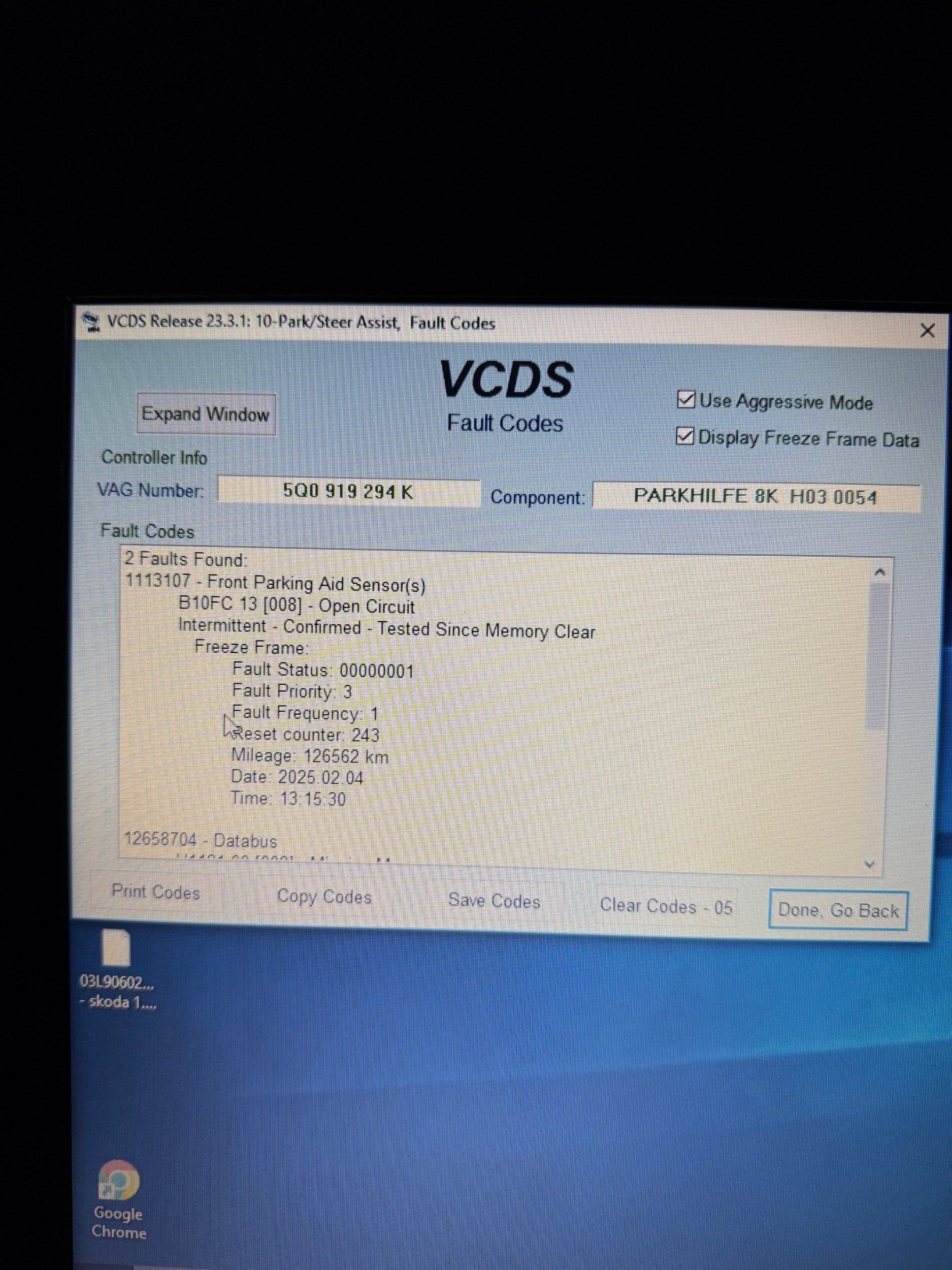

Both faults are showing as intermittent, so are historic rather than active. A compatible lead would allow you to clear those faults

Thank you. This is my friends set up so I have no idea if it’s genuine or not, hopefully, like you say it is. These codes have only appeared since the install. Would clearing them properly potentially sort the issue?
Also the fault on instruments isnt showing as intermittent. Could that be where the issue lies?

The fact they are described as intermittent means the faults are not there now, and what you're seeing is just a record of faults thrown up previously, probably before you completed coding, and therefore when the coding was incorrect. Clearing the intermittent faults "should" sort things out. I take it you have a face-lift Leon, that would explain why the lead isn't compatible and showing that a later generation lead is needed to communicate with the car. The fault not showing as intermittent does show tested since memory clear so again should clear once other historic faults are wiped
Thanks mate. The care is a 2016 pre-facelift estate which is what confused me. Which bit shows the cable isnt compatible?
I had a knock at the front and the only bumper I could find to replace came with Parking sensors where as the car didn't have them at the front prior. I thought it would be rude not to add them while they are there.
The entry saying the fault detail is only supported current generation interfaces says it's an older generation non-supportive lead that's being used. I had to update my lead when I swapped from a 2014 prefl to my current 2019 face-lift Leon. There were a lot of things the old lead saw ok on the prefl, but not on the newer model.
You would of course also get this scenario if it is a cloned or non genuine lead. Leads can be found on places like ebay for (Chinese) peanuts, but aren't genuine and can do far more harm to your car than you might imagine
