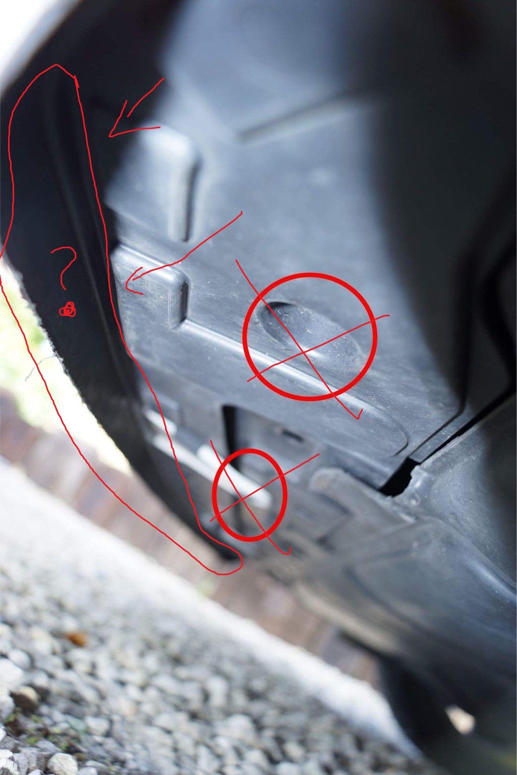

Does anyone have pictures of the clip arrangement at the side of the bumper next to the wing. My bumper keeps working its way out proud of the wing.
It was mentioned in the first couple of posts that there is a screw going up into the wing from inside the wheel arch behind a plastic clip. How does this clip get removed.
Don't want to go in at it like a bull in a China shop in case I snap something.
Cheers
Sean

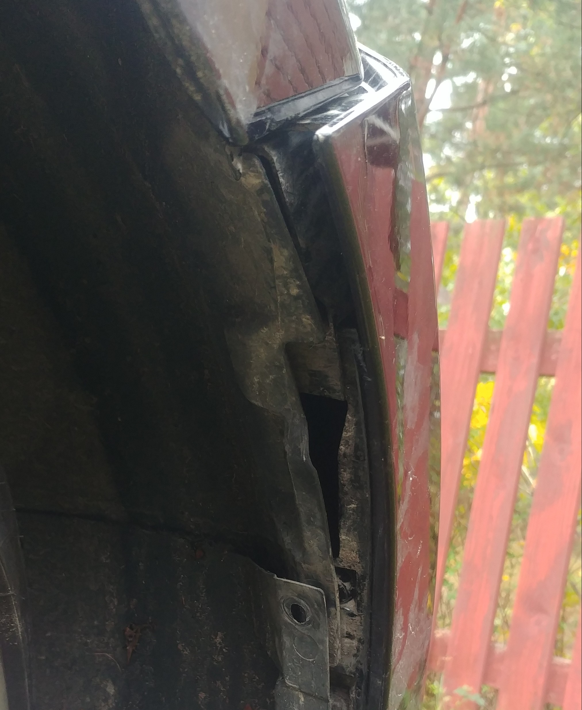

Hello. I have a problem with reinstalling the bumper. All holes lined up except passanger side(left hand drive). Bumper next to wheel arch keeps popping up. It seems like it has too much tension to up. If i press bumper down a bit holes are linig up but it keeps poppi g open again. Ideas?
Figured it out. There is a bumper connection piece (has screw hole also) with fender (i guess) and this was holding it back because it was connected wrong way. After connecting them correctly the bumper went to its proper location itself.

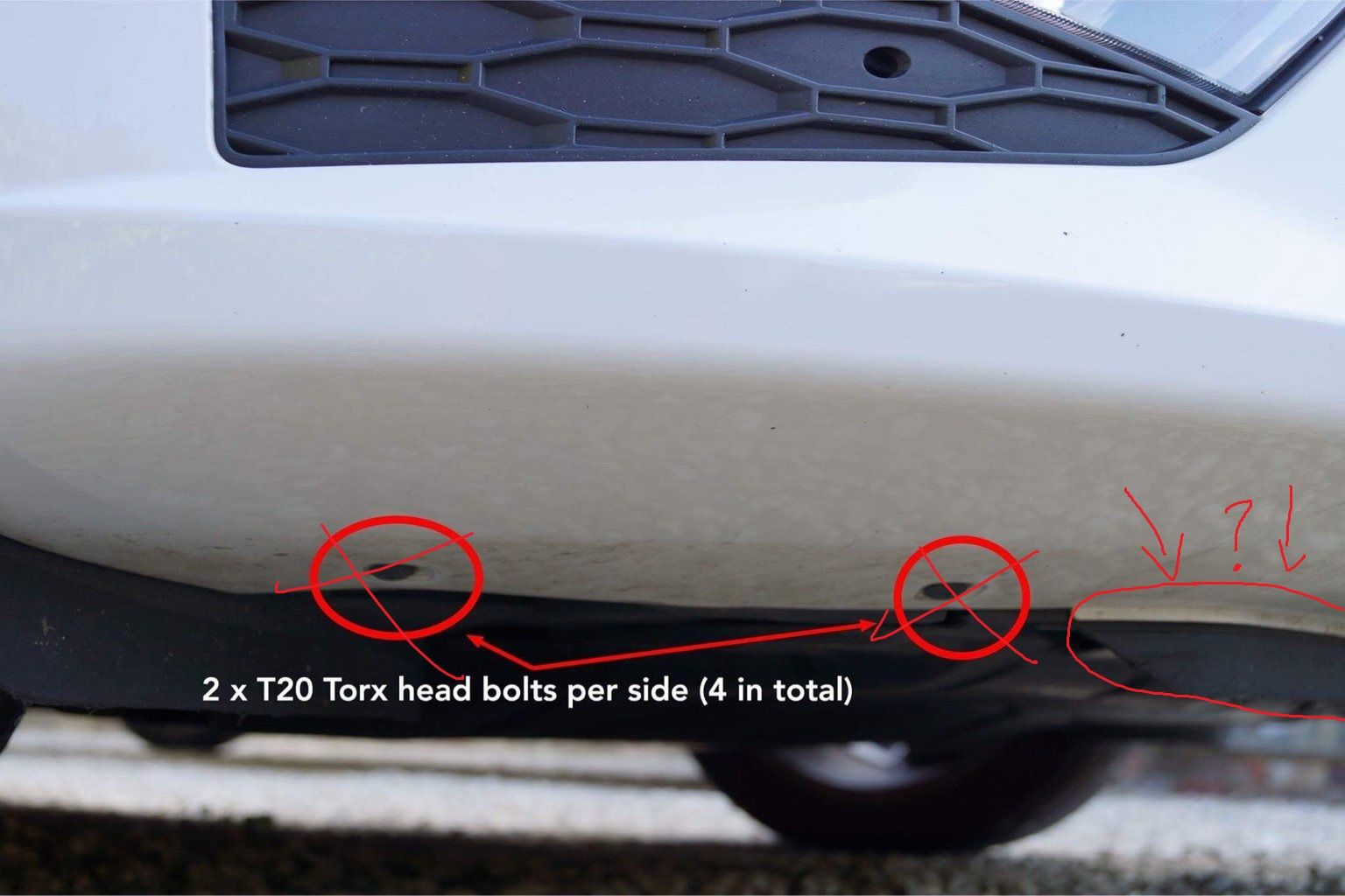

I had a look at mine but following a youtube video on an FR. Anyone know if the "awkward" T20 shown as a shape on the photo is underneath the aero flare (don't know what else to call it) on a Cupra?
The video glossed over that bit and all I could see internally was a hole in the bodywork that looked like it would allow a fixing (not present on my car from new) - but it was several centimetres inboard unlike where the inverted "T" on the diagram appears to be.
Any Cupra specific advice appreciated.

Are you talking about the bolt that holds the bumper and the weird plastic lip to the metal arch is? From memory every diagram I've seen doesn't really show where it is.

Pleas excuse the crude drawing...
At 4:02 exactly you can see him pull out the edge of the bumper after he has already undone the one I'm talking about.You can see the hole it would sit through:
Thanks Damo. That helps massively, but it looks like there are two bolts which he counts round about 2 mins in - and no aero flares! I'll have to investigate more, but I did manage to get a few more feathers out last time. Fortunately I left the top black trim and clips off to save time (and wear) later.

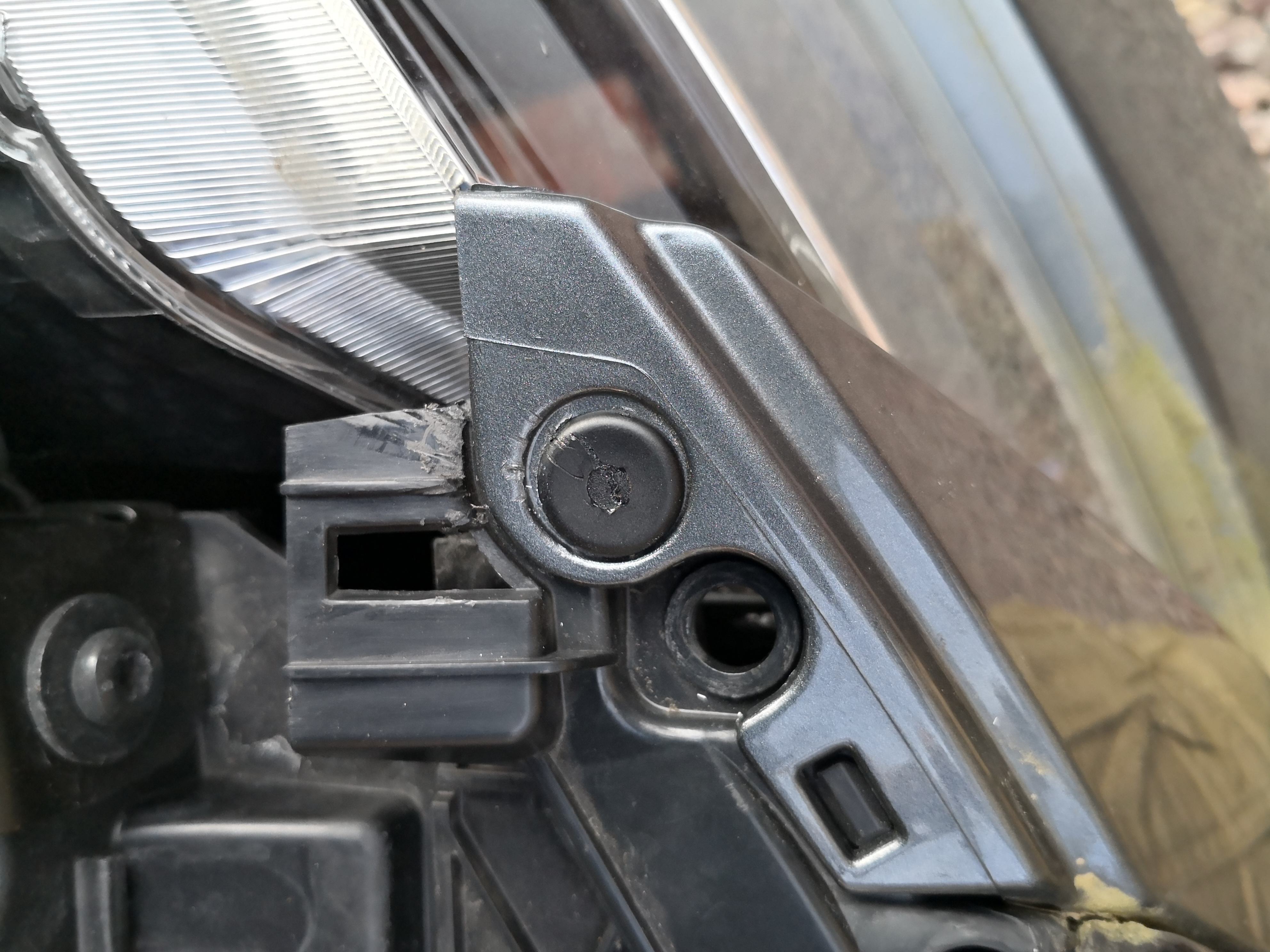

I'm struggling to remove the plastic rivet (clip?) that joins the top of the black plastic grille to the coloured bumper (one each side). I can't even get under it to prise it up. Anyone know how to remove it as I need to replace my grille? Thanks.
I've attached a picture from above the left headlight, but it's sideways.
That's well and truly busted. You could try tapping the centre down and out the bottom. I'd say it will knacker the clip but it's knackered already.
In the end I had to get the bumper off and get the broken top grille out. It would have been very very difficult without the bumper removal but you don't know until you try it. I've reused the grille frame (also fiddly with all the opposing clips) and I've put the new grille on with a copper "S" badge (mainly because it's not so bright and shiny). All reassembled now except for the Cupra badge which I may leave off as it may clash with the "S" badge.
