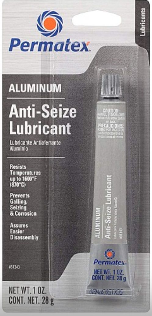

Ive attached the ceramic paste i used, looks like its also high temp properties
what do you think about it?
Loctite 8105 is hard to get, i found something close-Permatex anti seize
do you think it will do a better job then the ceramic paste?

As to the grease, I can't advise. Again, the grease I used was the one I found recommended on the net. Yes, it's expensive but the wrong one could cause more issues. It might not last or worse, get baked so hard the linkage is stuck solid. I used the Loctite stuff on my son's car maybe three years ago and it's still good plus the tube is big enough to last a lifetime.
In my opinion the ceramic paste you used should be fine, looking at the specification of the Loctite 8105 it has a lower temperature rating than the grease you used.
