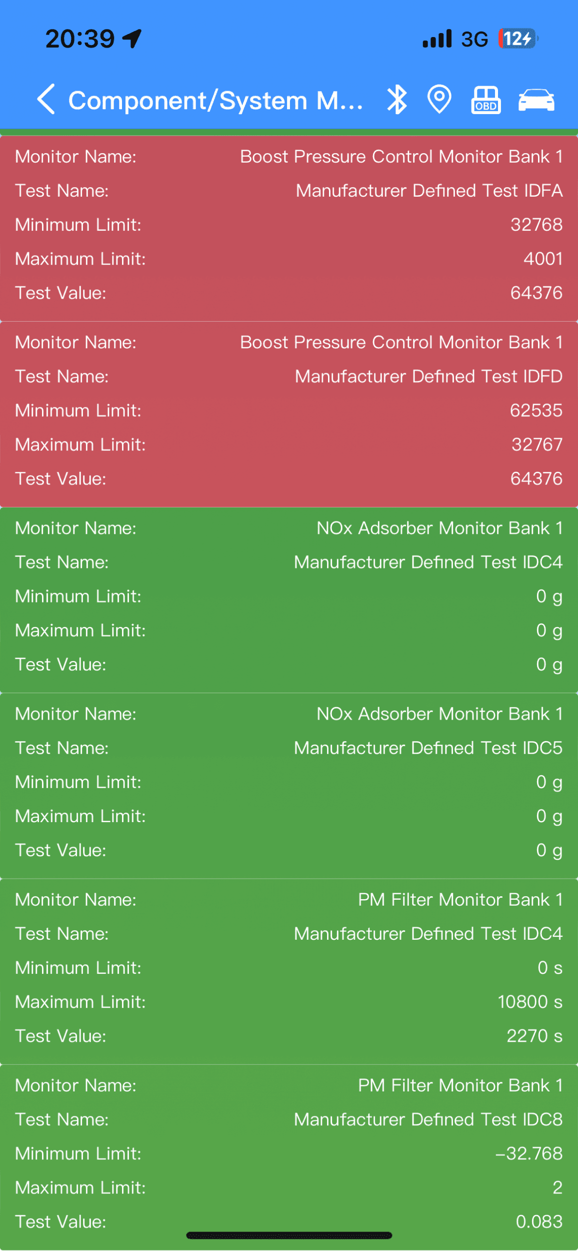

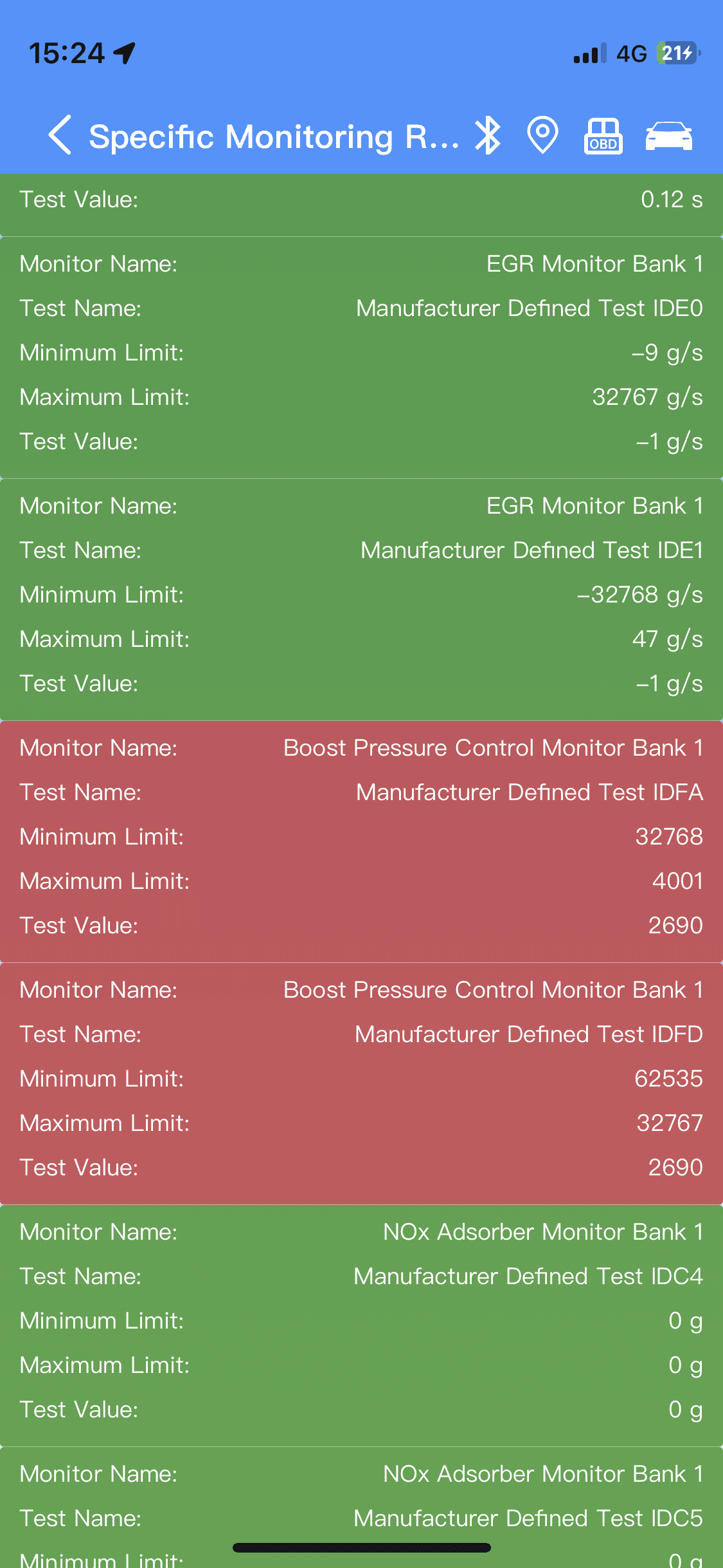

Hi I had the exact same issue on my 1.6tdi 2015 on the m1 aswell lol! Was doing over 80 and even went upto 110 no problems but on way back the glow plug light started flashing and lost a bit of power. Made it back home and the next day when I started it it was fine no issues or lights and when I plugged in an OBD2 I got these screen grabs I’m posting
