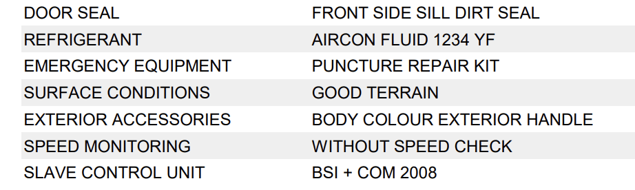

Just FYI @serdar_18fr and @jannickz - this isn't true. (I work for a major automobile manufacturer)
It's not a spec or option you as a customer can choose, but the market for the intended vehicle determines what 'road package' it has. Different brands use different terminology - here, the brand in question I work for uses the term 'Good terrain' for Western European markets, but in Eastern European markets it has 'Average terrain.' This snipped is from a build spec sheet from a 2020 model vehicle.
What exactly this changes I don't know, as I'm not part of engineering/assembly.
