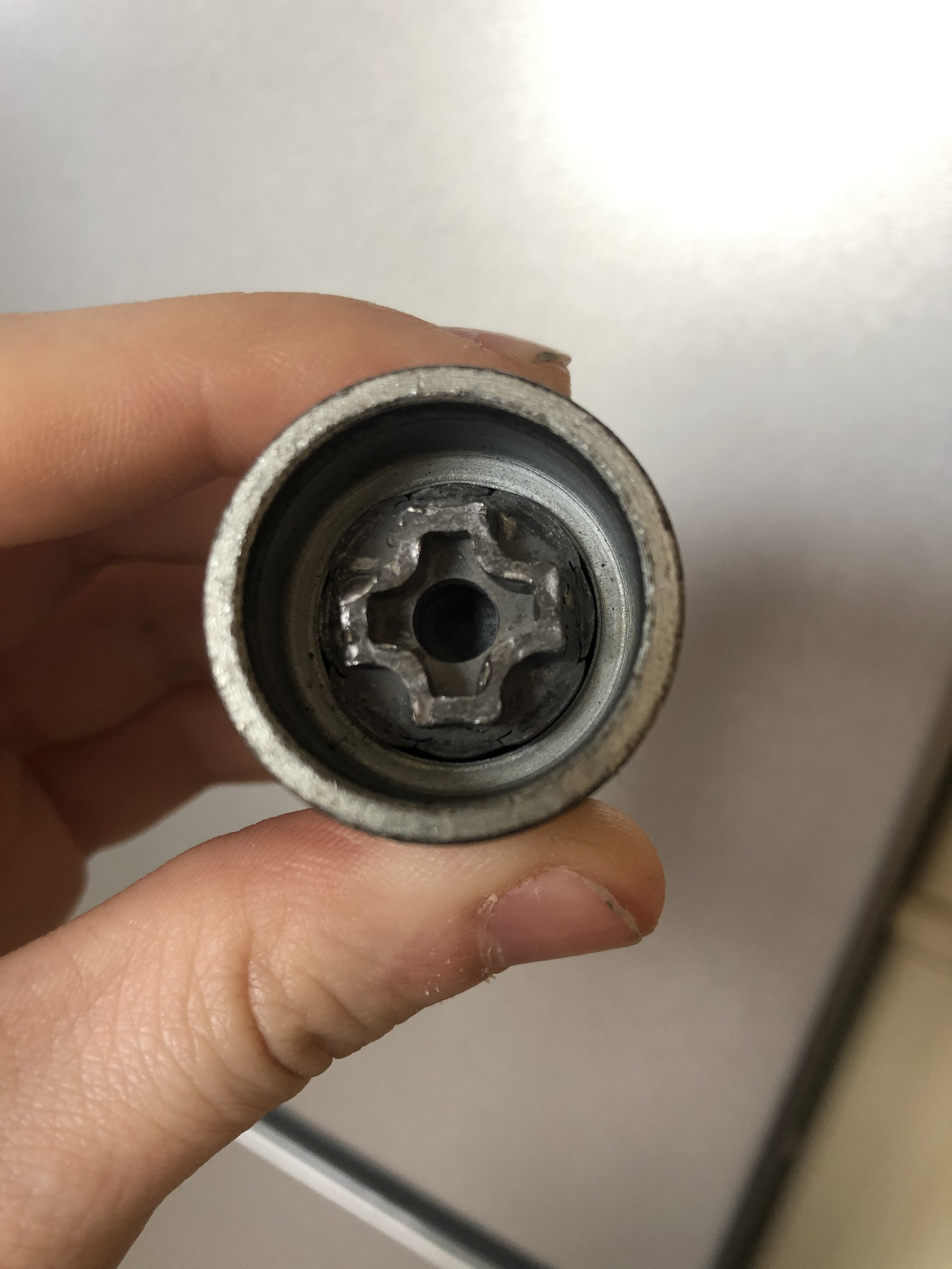

So.. I went to take my wheels off at the weekend to put my mudflaps on and at the same time i could clean the alloys properly whilst the wheels were off. However my locking wheel nut is knackered. It's not just rounded off but the inside has loads of cracks like it was used under a tonne of pressure. I probably made it a bit worse because i didn't realise and still tried to use it. When i did realise i obviously stopped and knew i need another locking wheel nut key.
I think the dealership had ruined the key as they gave me all new tyres when i purchased the car in August, as i haven't had to use it yet and that was the last time it would have been used.
My question is how do i know what one i need? it Has a letter on the back of it but apart from that i don't know where to look?? I've seen some on Ebay but i don't know if i should get them from an oem supplier (ie SEAT)
Any advice welcome, thanks.

Okay, take close up pictures of your wheel bolts and your security adaptor as well as recording the letter/number on the end of the security adaptor, then start looking on ebay for a replacement.
These McGard security wheel bolts are used by many other manufacturers and some of them use a different system for identifying them so you might end up buying the right adaptor but it has a different code on the end of it.
Just make sure that you take enough time to end up with as perfect a picture of the bolt end and the adaptor end as you can.

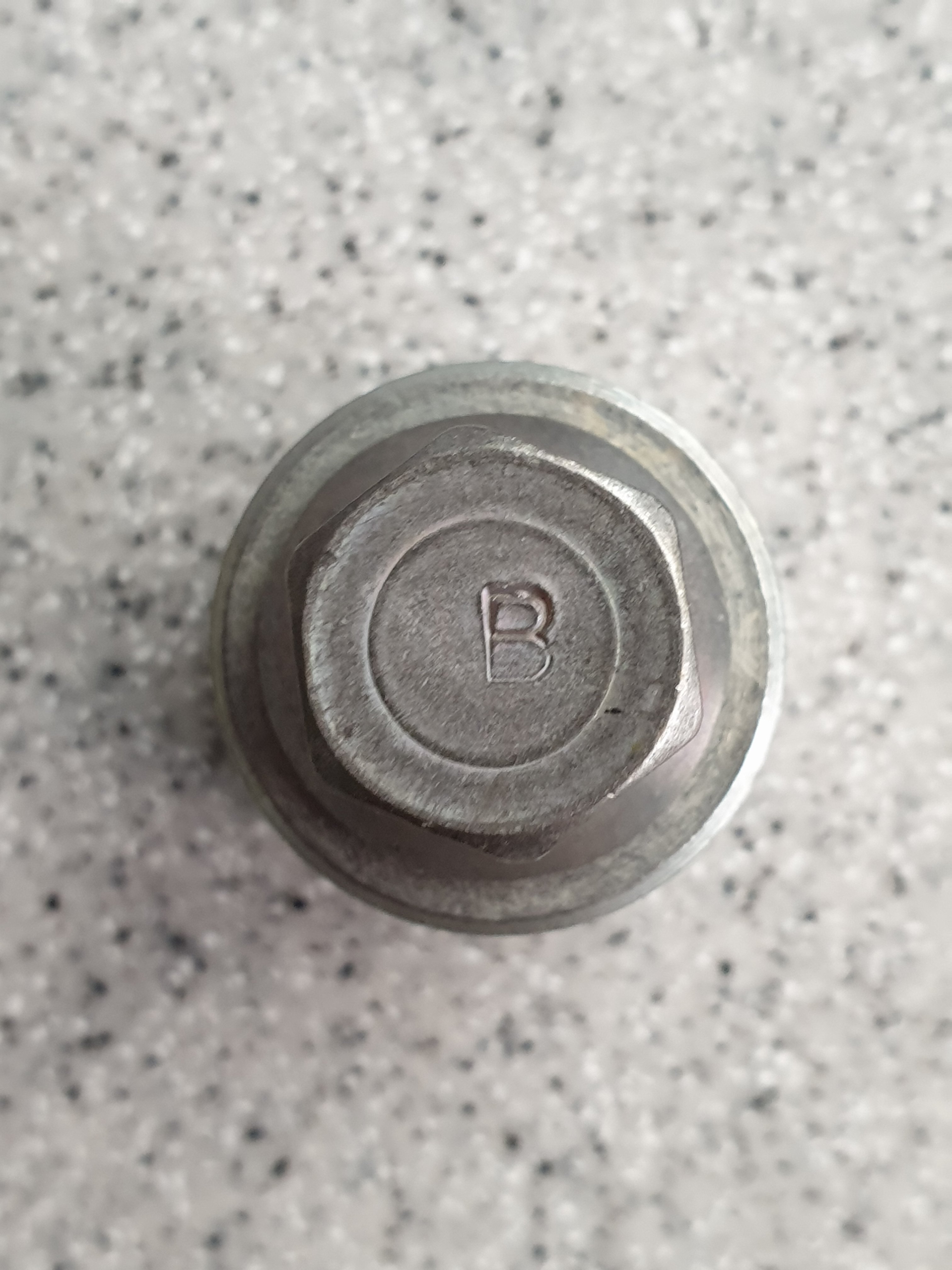

@Mr Pig It has B on the end. I'm not seeing any online that also have B on the back..
Mine has a B on it.

Sorry to be the bearer of bad news...
Normally when the locking nut key is knackered, at least one of the locking wheel nuts will have been mangled in the process - I had a set replaced after a ‘national chain’ damaged mine whilst replacing the tyres - fortunately, I found this out a couple of weeks later when changing to winter wheels, so at not cost to me.
I had to get local company to weld a nut onto the locking nut to remove, but this damaged the paint on the alloy too, so had to be refurbed.
Coincidentally this was also key ‘B’.
Well luckily only one of them is slightly damaged because I checked them all after finding the key was damaged. There’s no way that key will work though which makes me think they might have had to use another key to fit them and then left me with that one. Maybe just a coincidence I don’t know. Will see what happens. I appreciate the help all
Ps. the picture makes it look better than it is
I suppose its a tough call, to protect the wheels as much as possible it would be a smart move to get a "B" adaptor and see if you can get the other 3 wheel security bolts out, then attempt the same with the 4th one and replace them all with plain bolts and 4 new bolt covers.
I've always had locking wheel nuts/bolts and never had any issues over the past 38 years of buying new cars, so if I ended up in your situation, I'd probably buy a replacement set of security bolts and hope you don't end up with the "B" code ones as they do look to be the weakest, or one of the weakest versions - not good!!

Like you said i think the shape of this key is a bad design, surely it would need some acute angles for it to be effective? These are quite round with the tightest angle being 90 degrees..
