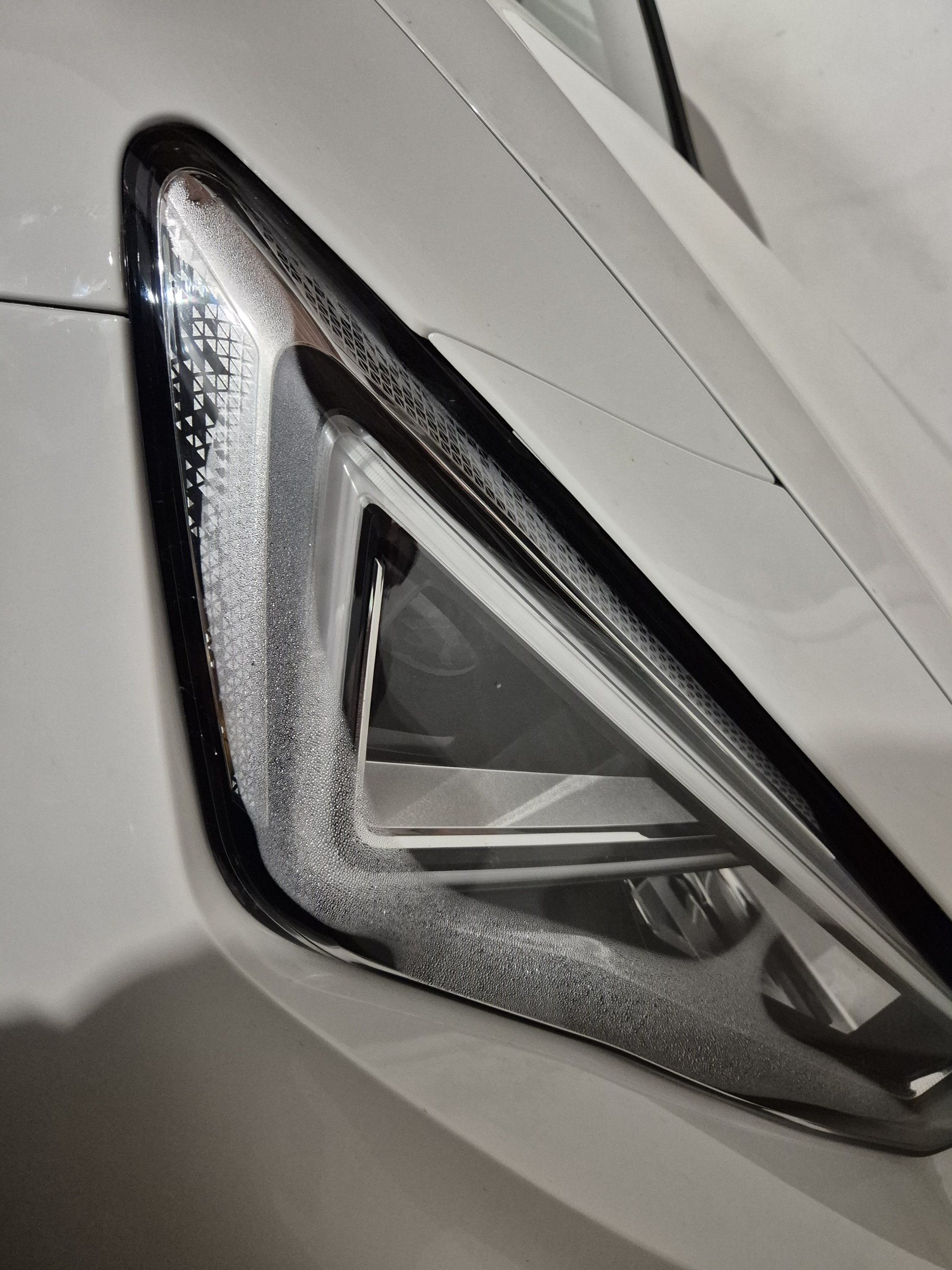

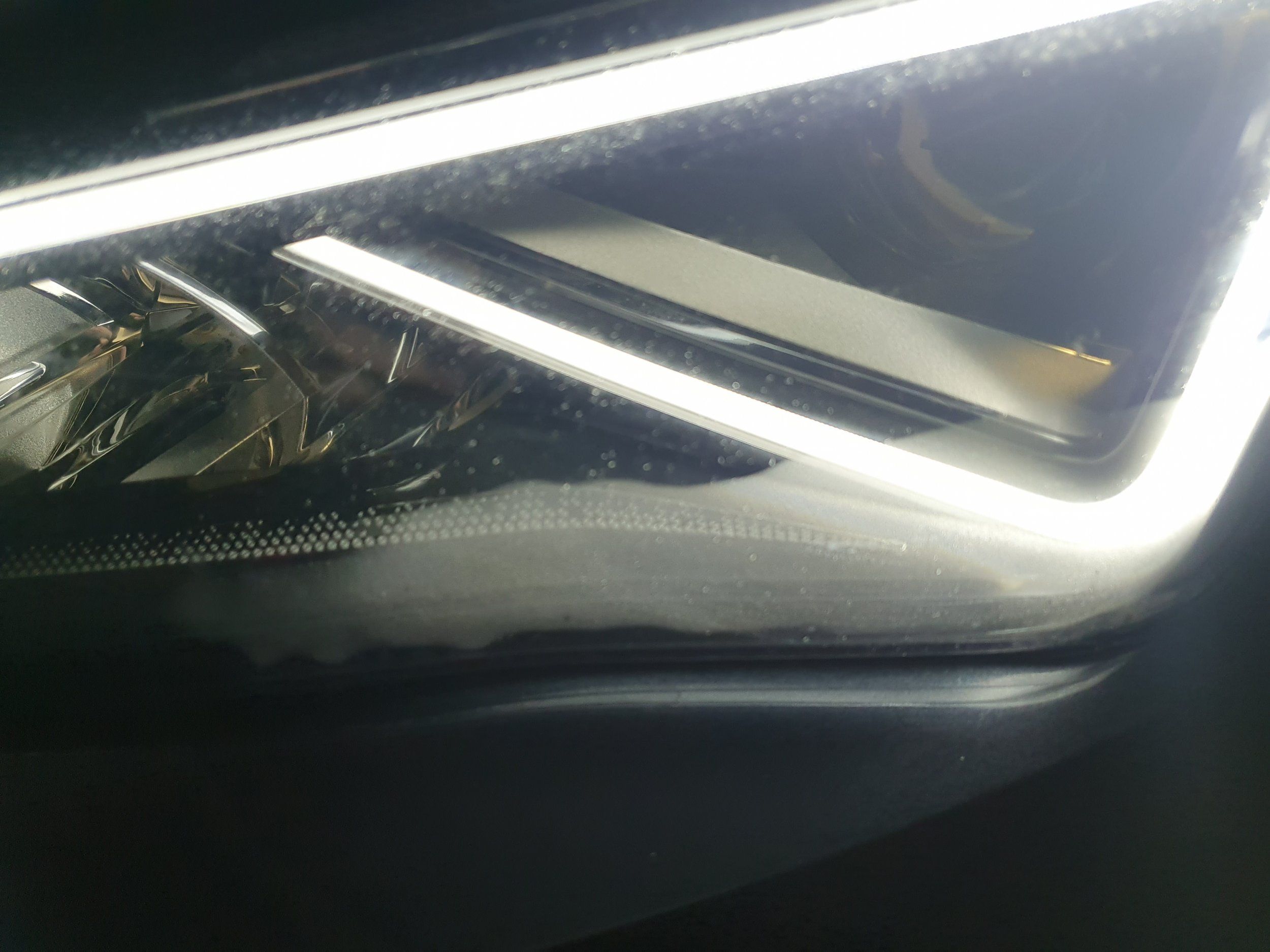

I too had headlight condensation (see pictures). My car went into the dealers for this and the dreaded SOS fault.
The SOS fault was fixed under warranty. However, the headlights were not. The dealer told me that as the water was not "pooling" it is not covered under warranty. From what I can gather from this an other car forums (not just VAG), this is common issue for LED lights. Apparently, the Cupra headlights are not sealed and have a breather hole, but being LED they do not get warm enough to evaporate the any moisture that collects in the headlights. The dealer suggested that I go home and pressure wash the car in an attempt to make it look worse, then take some more pictures. Mine sorted themselves out once the warmer weather came along. I suspect that they will be the same in the coming winter.

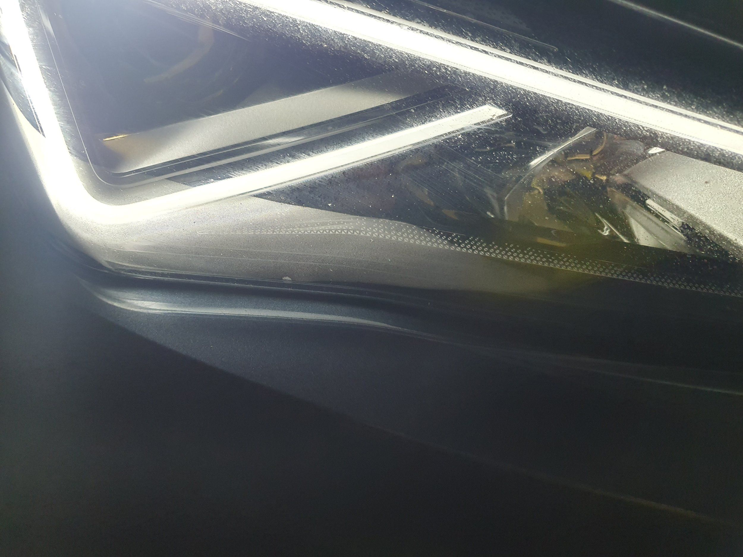

So, I’ve got a little update. I used a hairdryer to heat the front glass of the headlight. After about 45 minutes, almost all of the condensation was gone – the glass looked perfectly clear. I was really happy that I managed to get rid of it.
But the next morning (the car had been sitting in my garage all night), I came back to find the headlight looking like this 😞
I honestly feel totally lost.

I tried it once more. I really completely dried it – there wasn’t even the slightest sign of humidity or water visible.
I used a hairdryer for more than two hours and did it very thoroughly. I even managed to find and open the ventilation tube (in the left corner of the headlight), so the moisture could escape.
The headlight was absolutely clear.
But this morning, everything is back again…
So the only thing that comes to my mind is: there must be a problem inside the ventilation tube – otherwise I honestly have no idea.

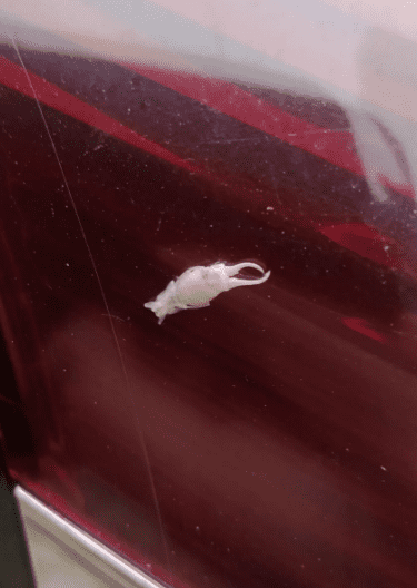

Anyway, you think you've got problems? - I have a little old Toyota iQ as my 'local runabout'. Right inside one of the red rear light units is the almost-white carcass of an earwig. Now THAT is annoying!...
Any removal tips welcomed!
