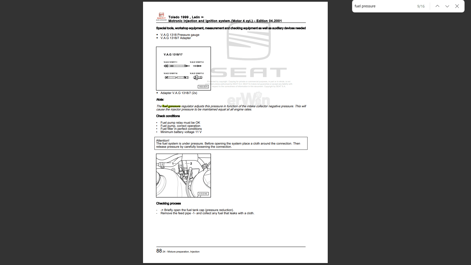

Fuel pressure specs/test for AUQ

My bad, my first test was not accurate because i mixed up the return line. (thought the fpr regulates the fuel to the rail instead of regulating fuel INSIDE of the fuel rail)
Tested it today (without starting the car because currently the car can not be started) and with KOEO the fuel pressure sits around 2.8 bar/40 psi for as long as I had the gauge hooked up (10 minutes)
Have to see if fuel pressure increases with fpr vacuum hose disconnected when the car is running again

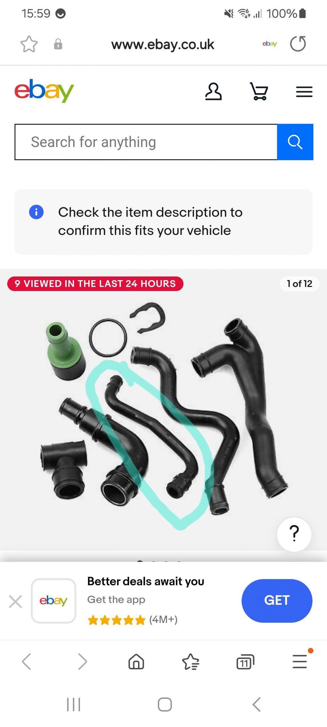

All of the above hoses are likely suspects, not just the hoses themselves, but where they push together, especially that T-piece
Yeah replaced all that BESIDES this one.
I could try to check it visually again, but if it was split it wouldve shown smoke coming out of there right?
