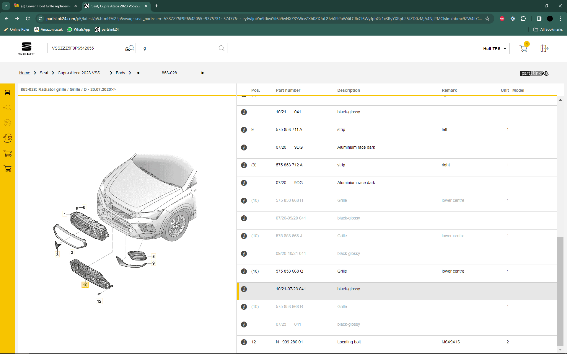

Had a little boo boo in my 2023 CUPRA ATECA VZ2 and cracked my lower front grille that holds the registration plate, radar, parking sensors and front camera. There is no damage to the sensors etc, just a couple cracks on the grille.
I can only find replacements for SEAT or pre-facelift CUPRA ATECA’s.
Can anyone help with where to buy one? Or does anyone know a rough price a body shop/coachworks/dealership would charge for supply and fitting?
Cheers all!
575 853 668 Q 041
We'd charge £125 inc. VAT + postage
You'll need an ADAS calibration after installation, your area view will likely need calibration too
