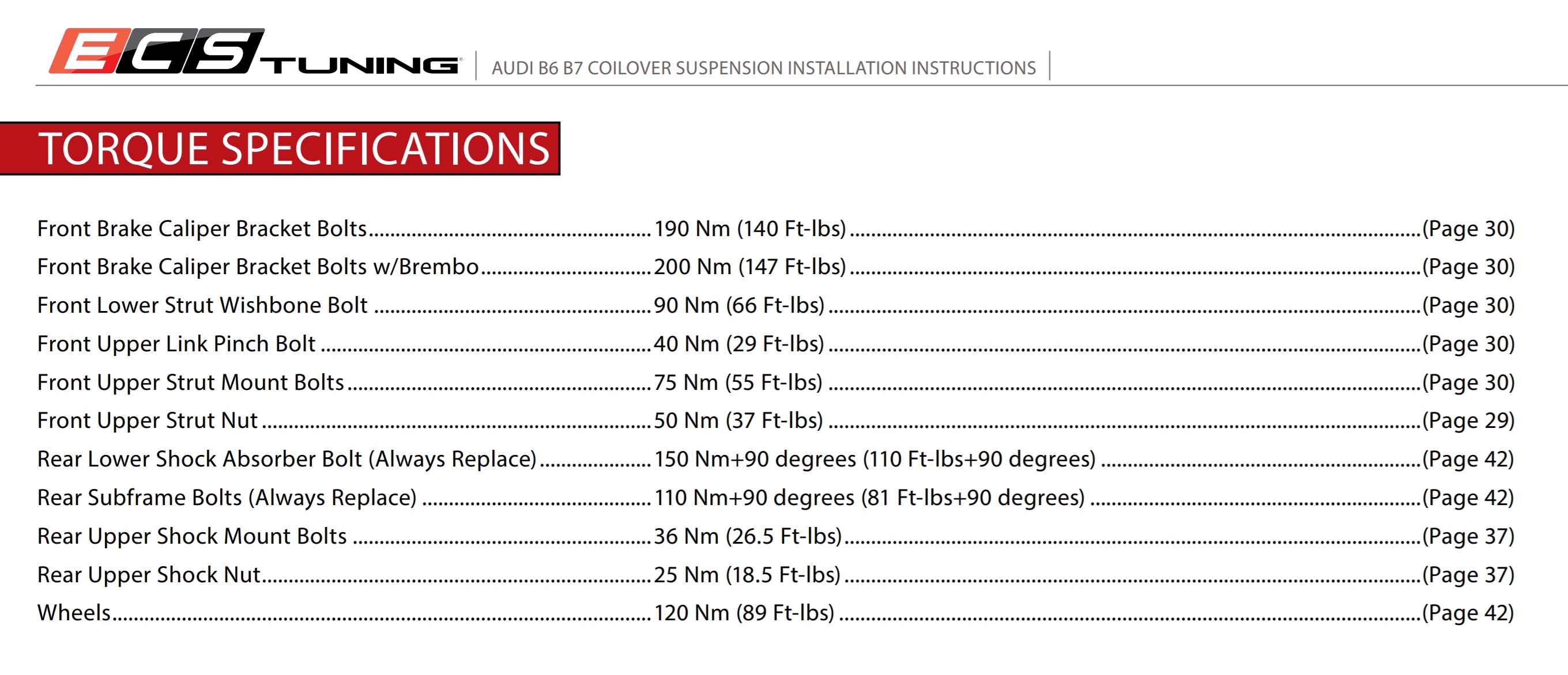

Any idea what the torque loadings are?

Tom B
Apr 2, 2002
4,710
16
Northampton
