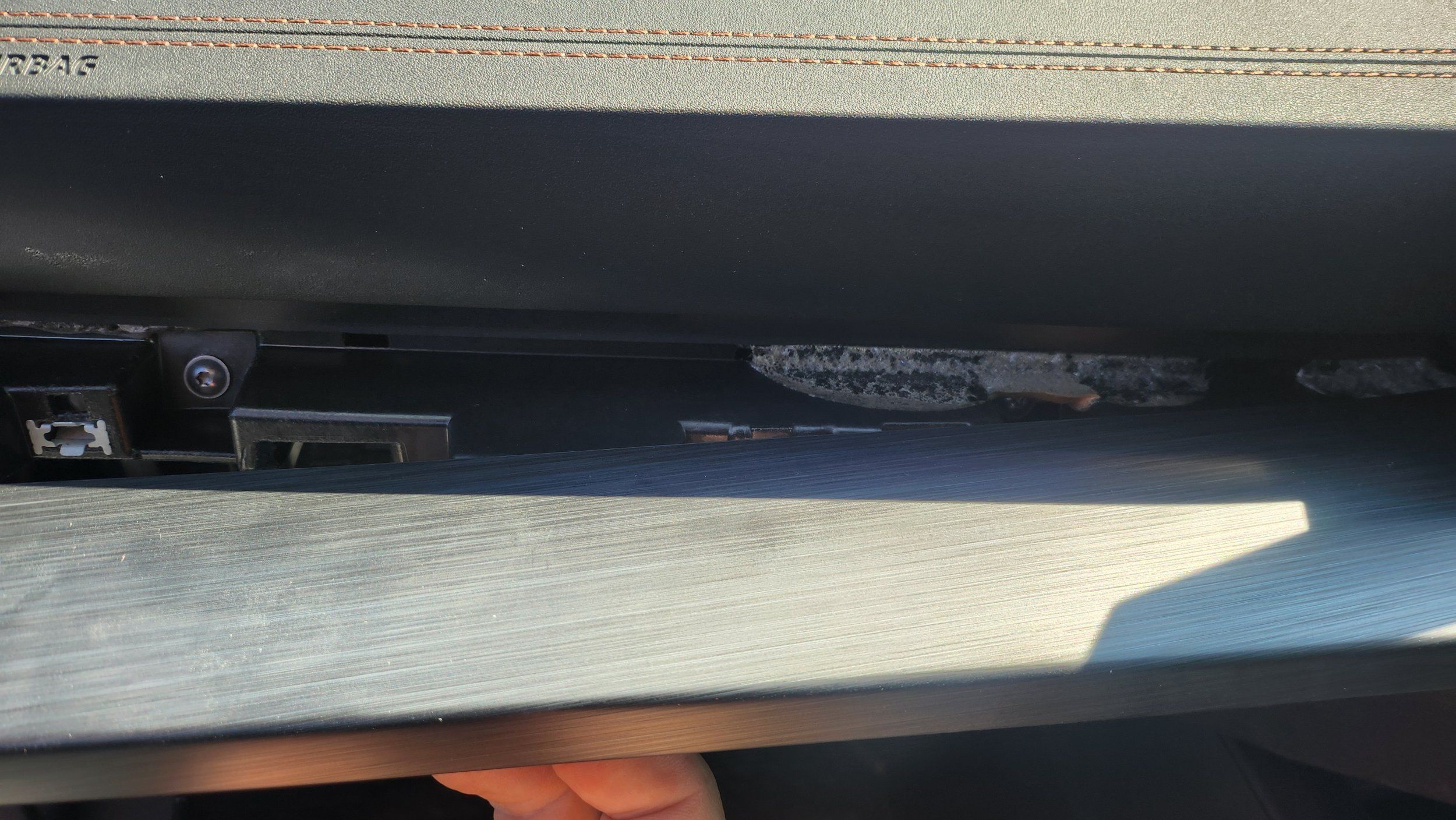

You'll have to remove the entire glovebox on UK Formentors, not just the door. It's a sealed compartment and requires trim tools to get it out. I wasn't even successful in changing the cabin filter because of the design, so good luck!

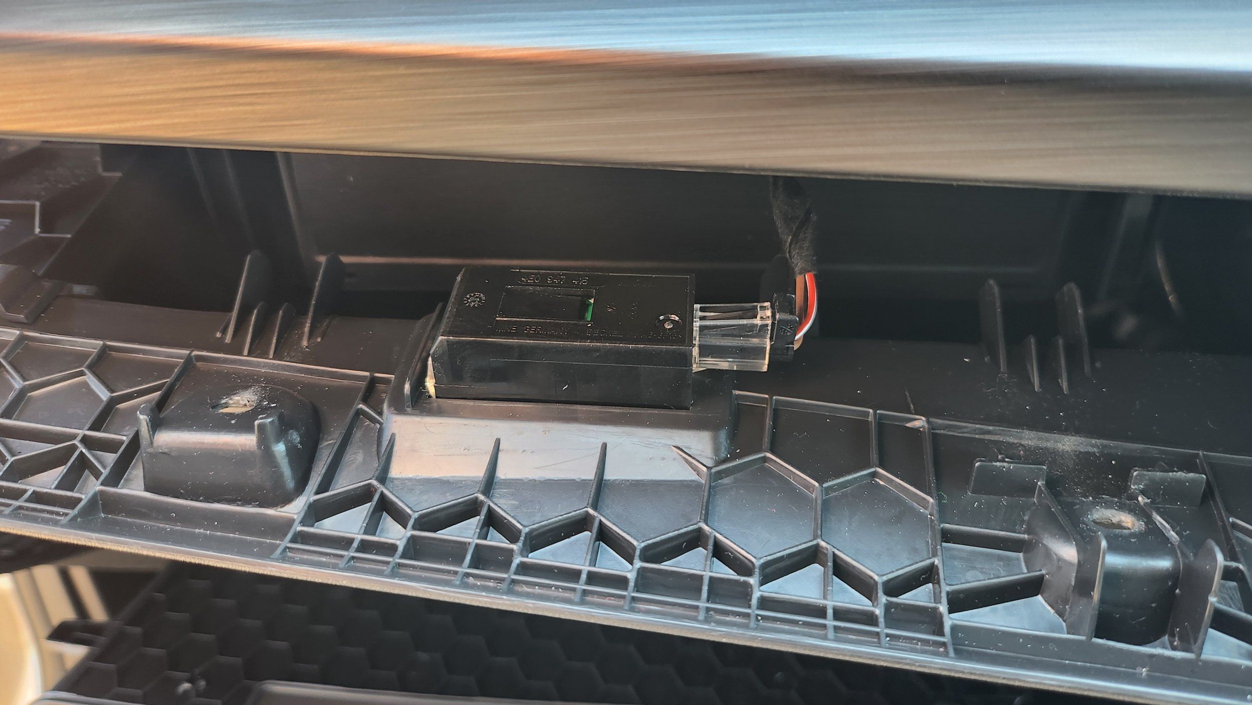

That's only for the fusebox.
On the Ateca when I asked how to get at the fusebox in the glove compartment at delivery, the reply was "its a non customer serviceable part".
Due to how RHD cars are wired, that's to say they don't change the wiring from LHD to RHD in how it runs down the car, what is easy to get at in LHD cars is hidden in RHD befind the glove box. Suspect as more tech is put in more hiding goes in. I never did get the Ateca dampners off, you need strong fingers.

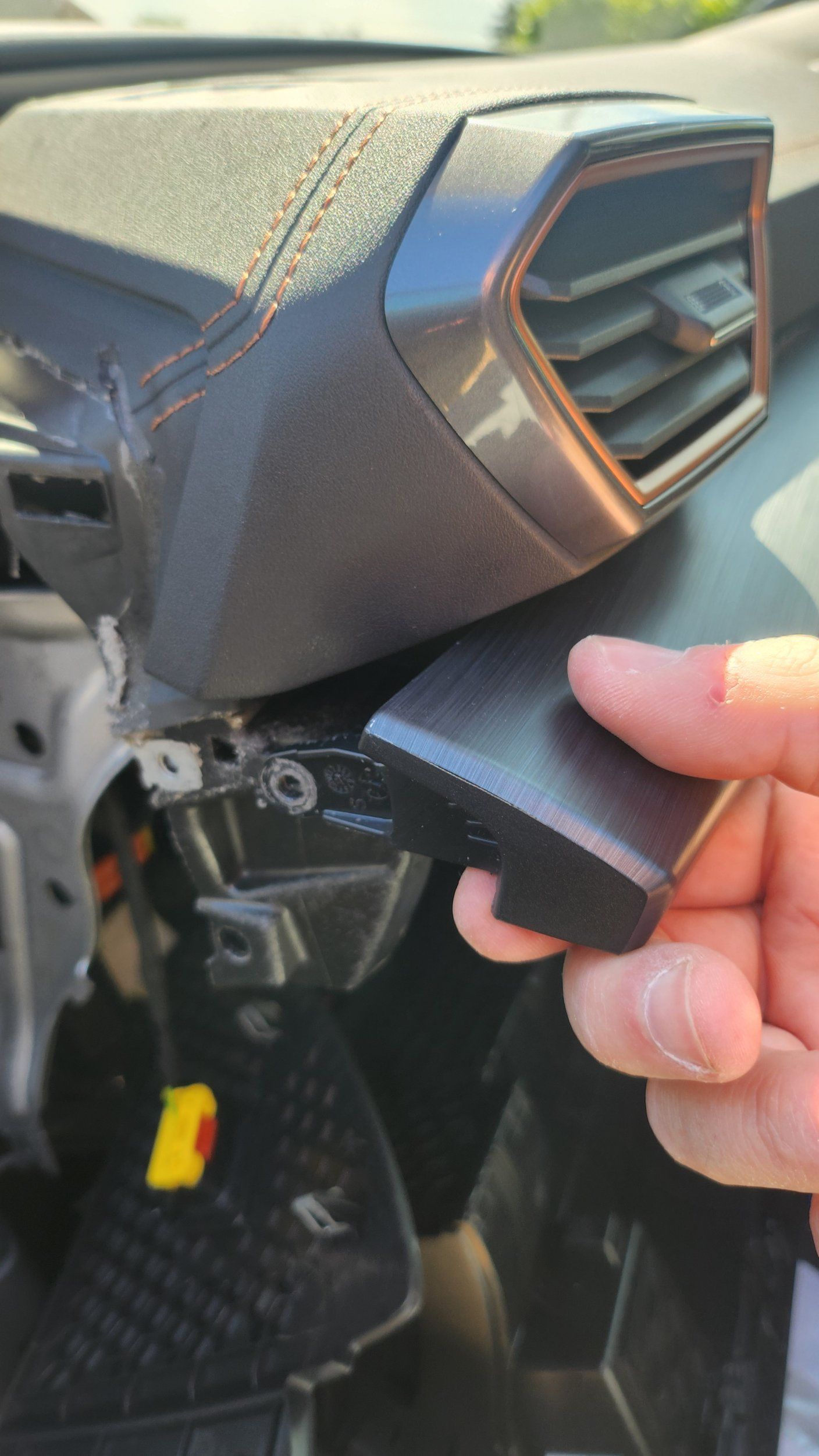

I used pump bags to 'gently' maneuver the glovebox into submission. ?

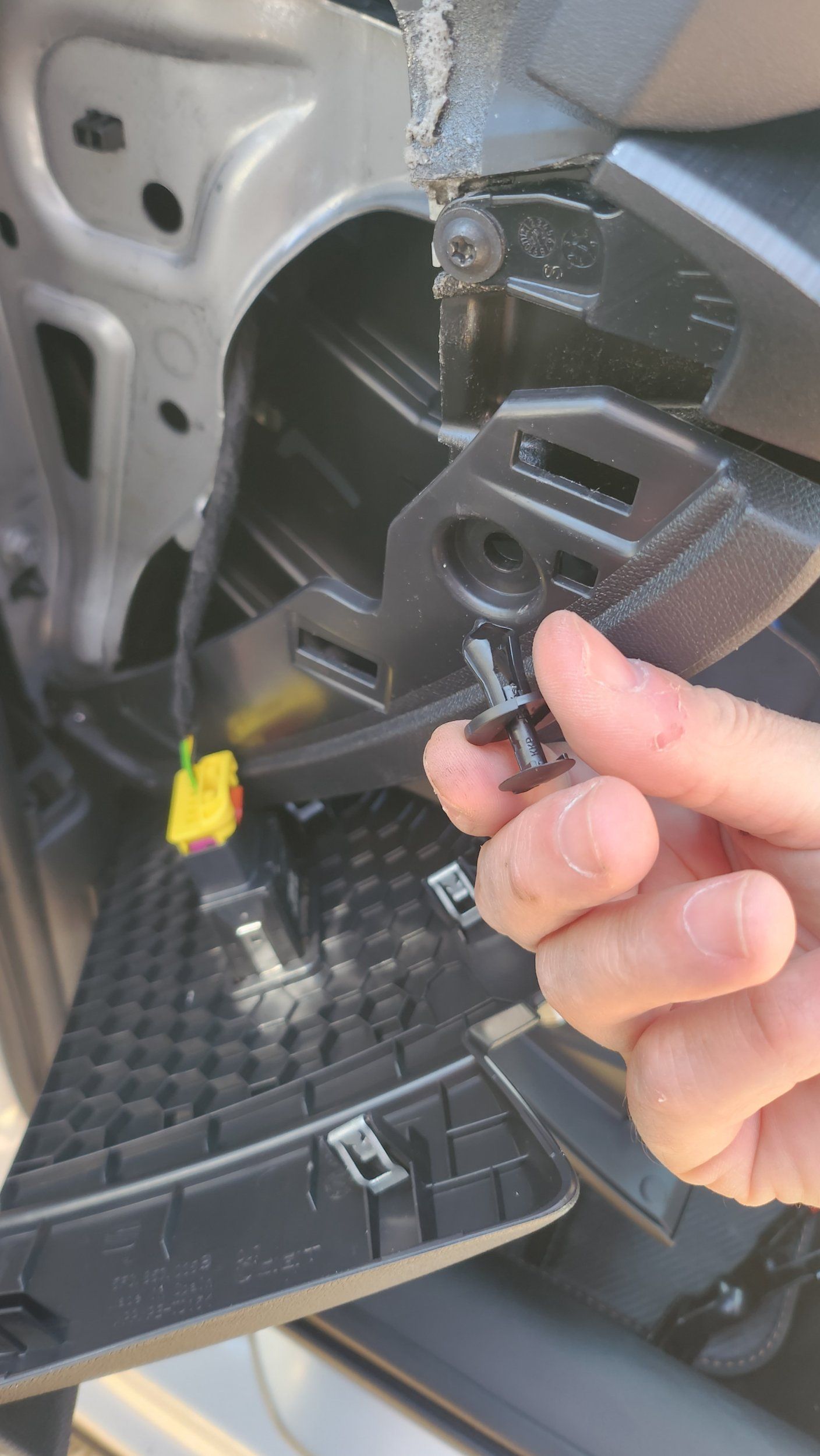

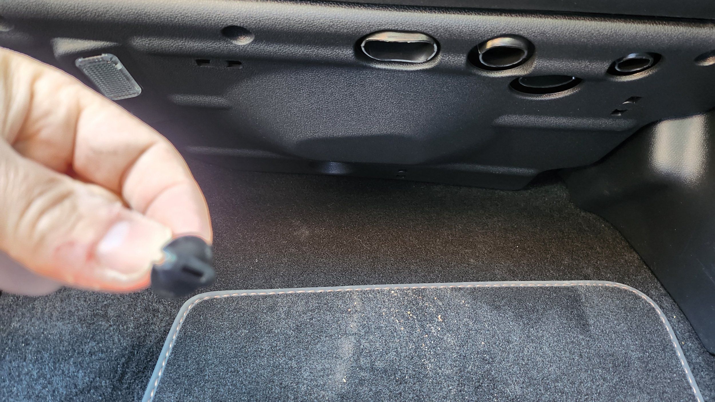

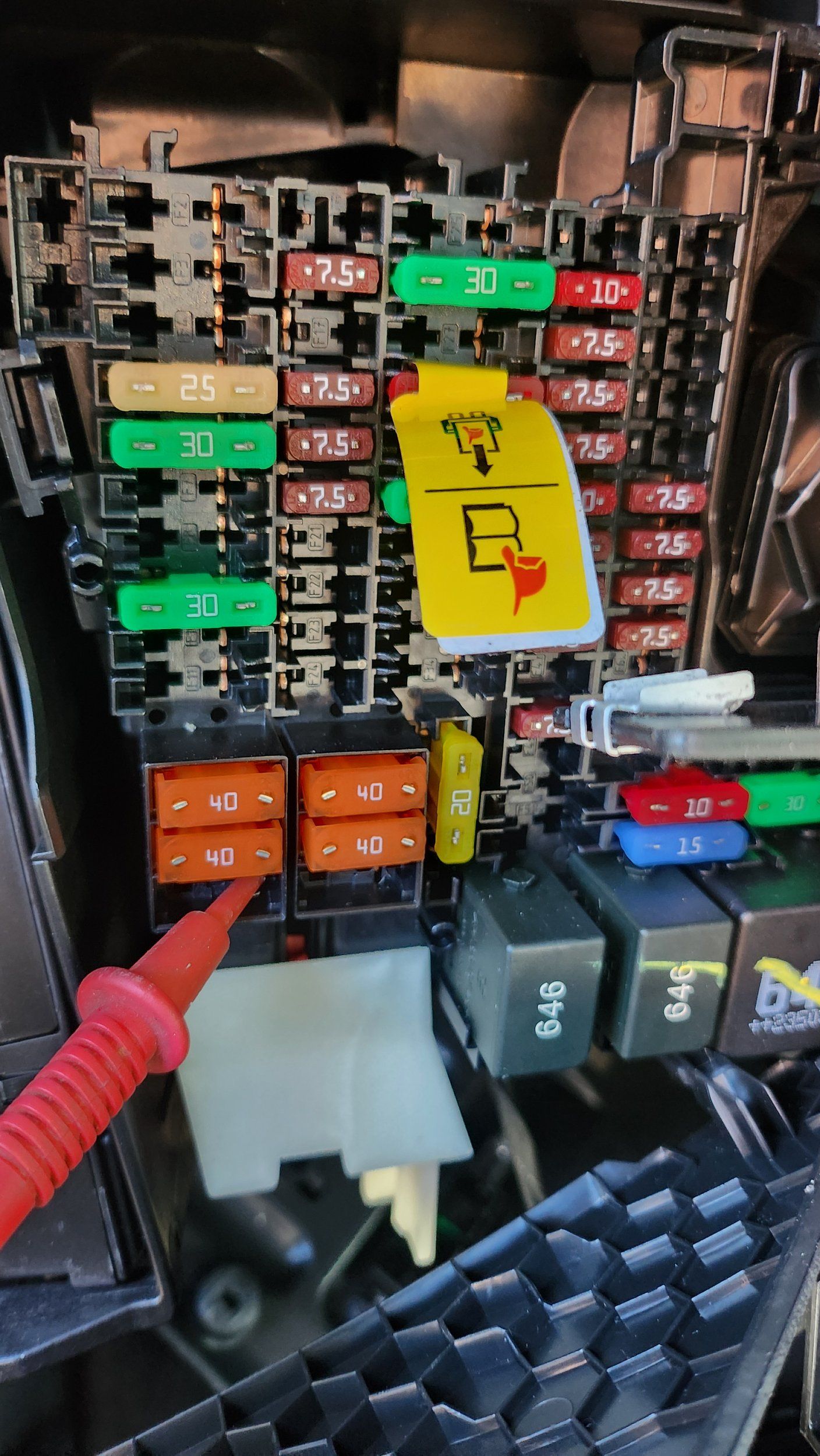

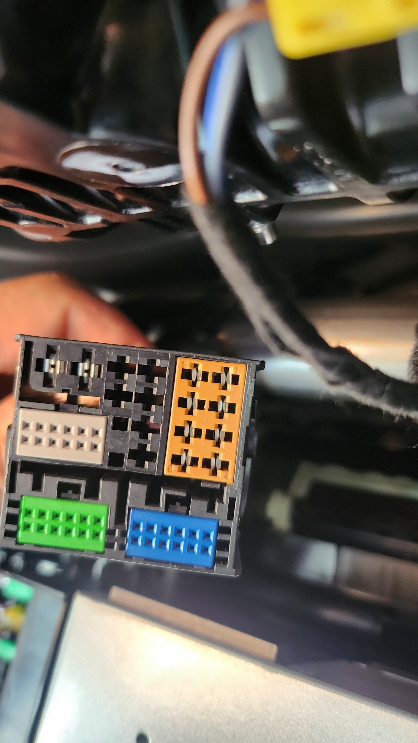

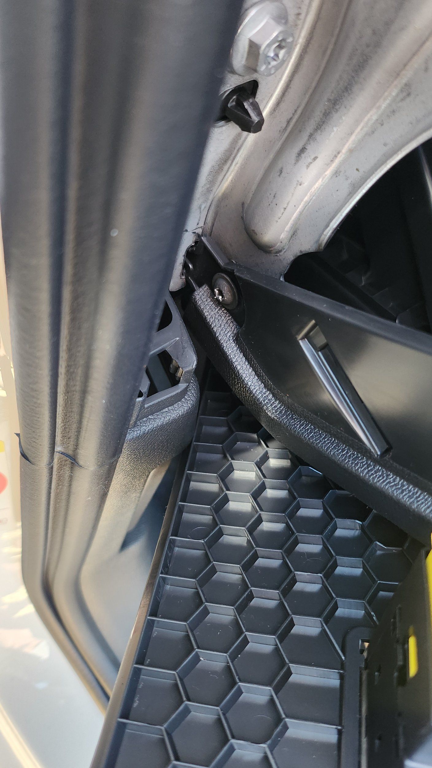

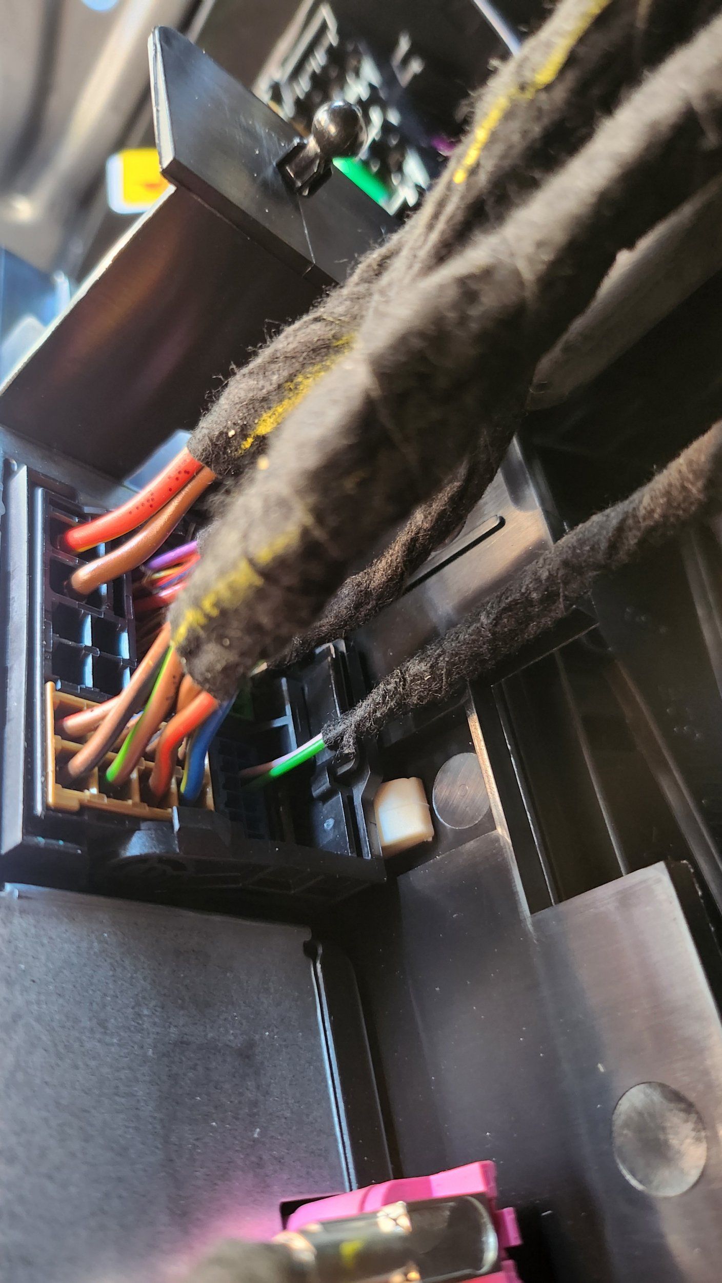

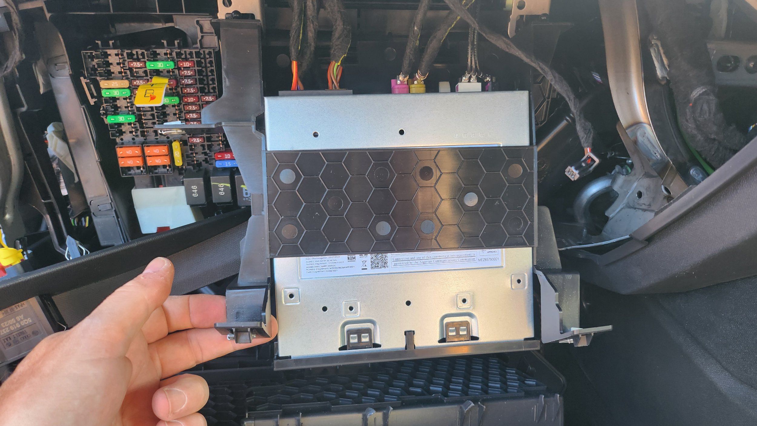

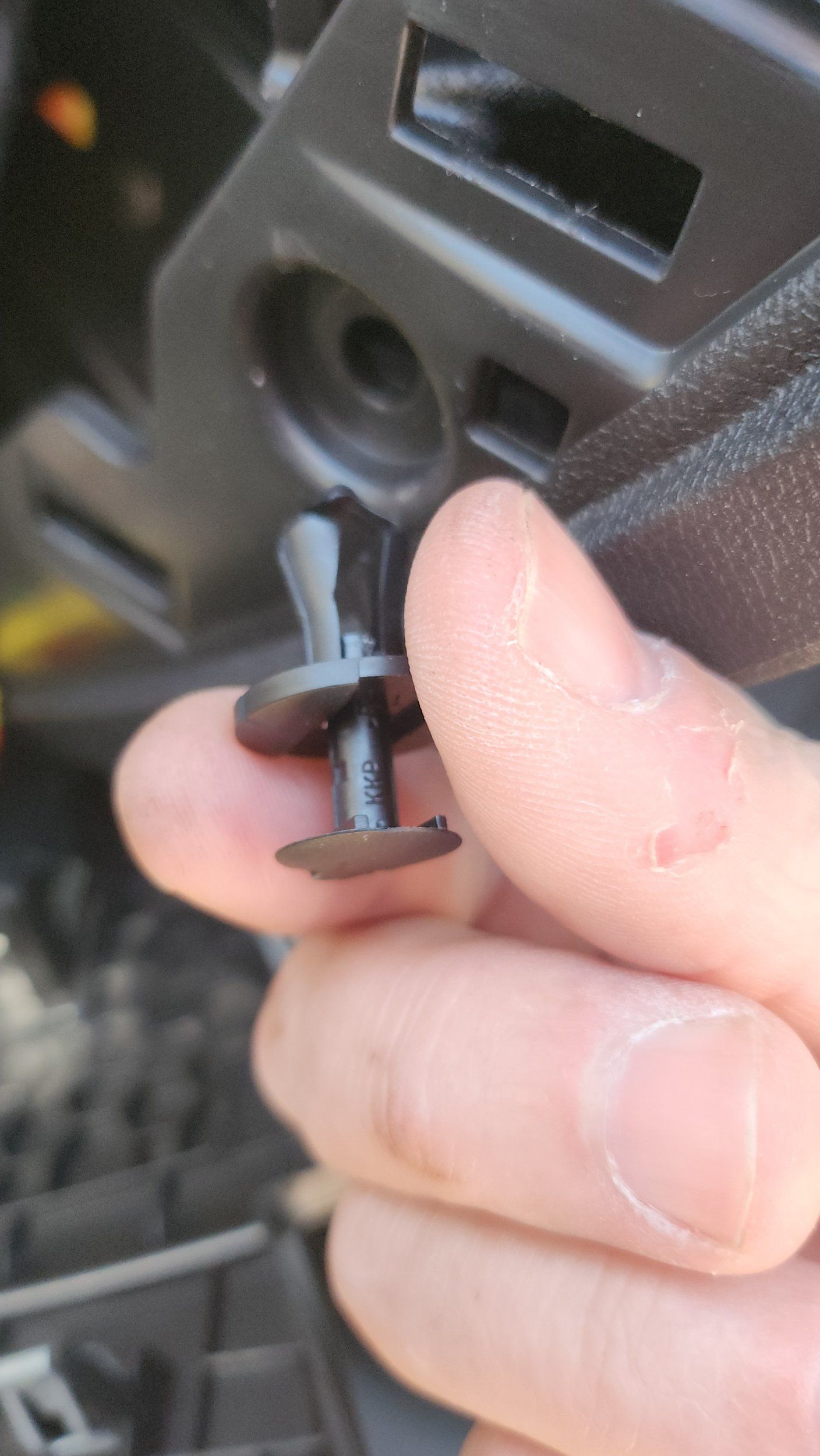

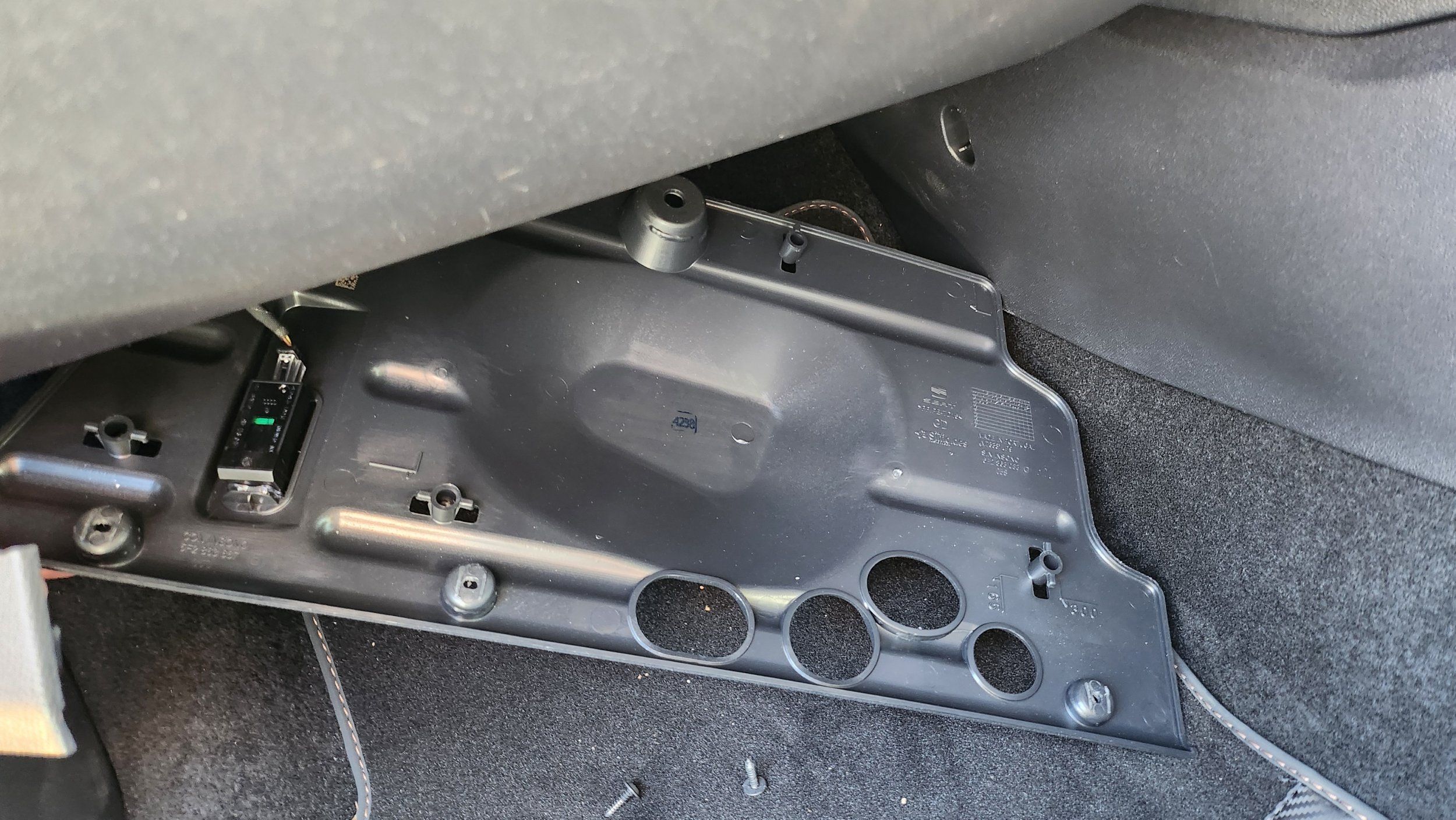

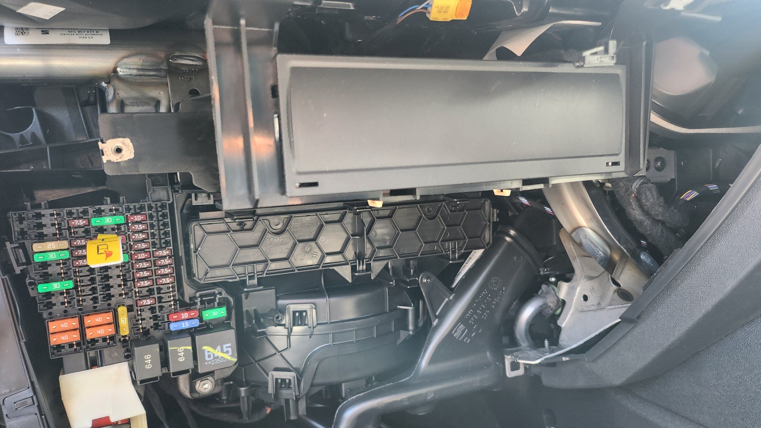

Found the media unit after removing the glovebox.
Hangs from a bracket, unfortunately cables behind it are too short for it to slide out fully so you need to drop down the bracket. Screws are behind the centre dash trim piece.

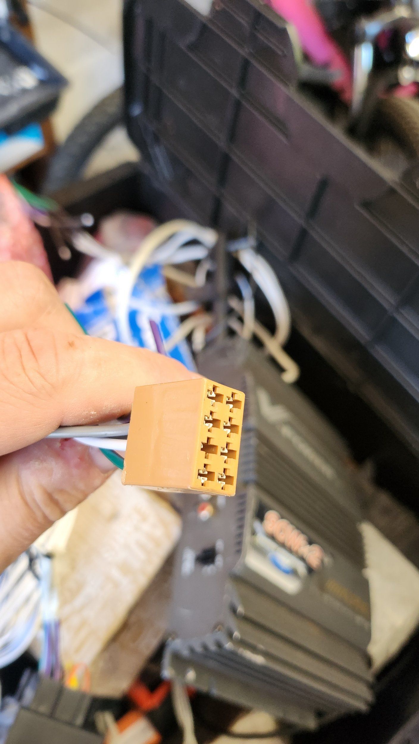

Looks like a standard ISO multiplug which you can just pull out the speaker section and then the usual amp business from there once I get the cables.
I've attached some photos if anyone wants to see this for future reference
Thanks for the pics. I assume you used speaker level to feed your amp, did it then throw a park sensor fault? Ive read it looks for the stock speakers and errors if it can't see then (I see focal make a harness to simulate the speakers?) just wondering if you had this issue. Also is there just a front left and right full range feed? So the tweeter must just have capacitor?
