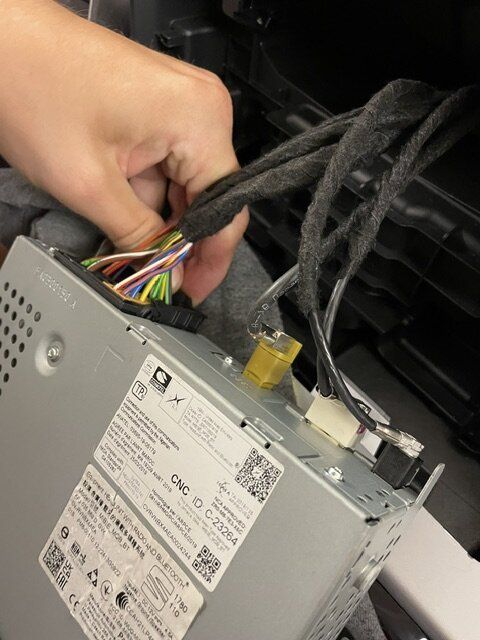

Hey guys, i just bought my new car, and my first project is car audio...
Im gonna install a Match UP 6DSP amplifier and that requires access to the MIB unit to install this adapter.
I heard that this box/unit is moved around on different models etc.
My car has the 8.25" screen, so no navigation just apple/android carplay, its a 2023 Ibiza FR.
If someone could enlighten me where it is and what i have to disassemble to get there it would be much appreciated.
Regards.

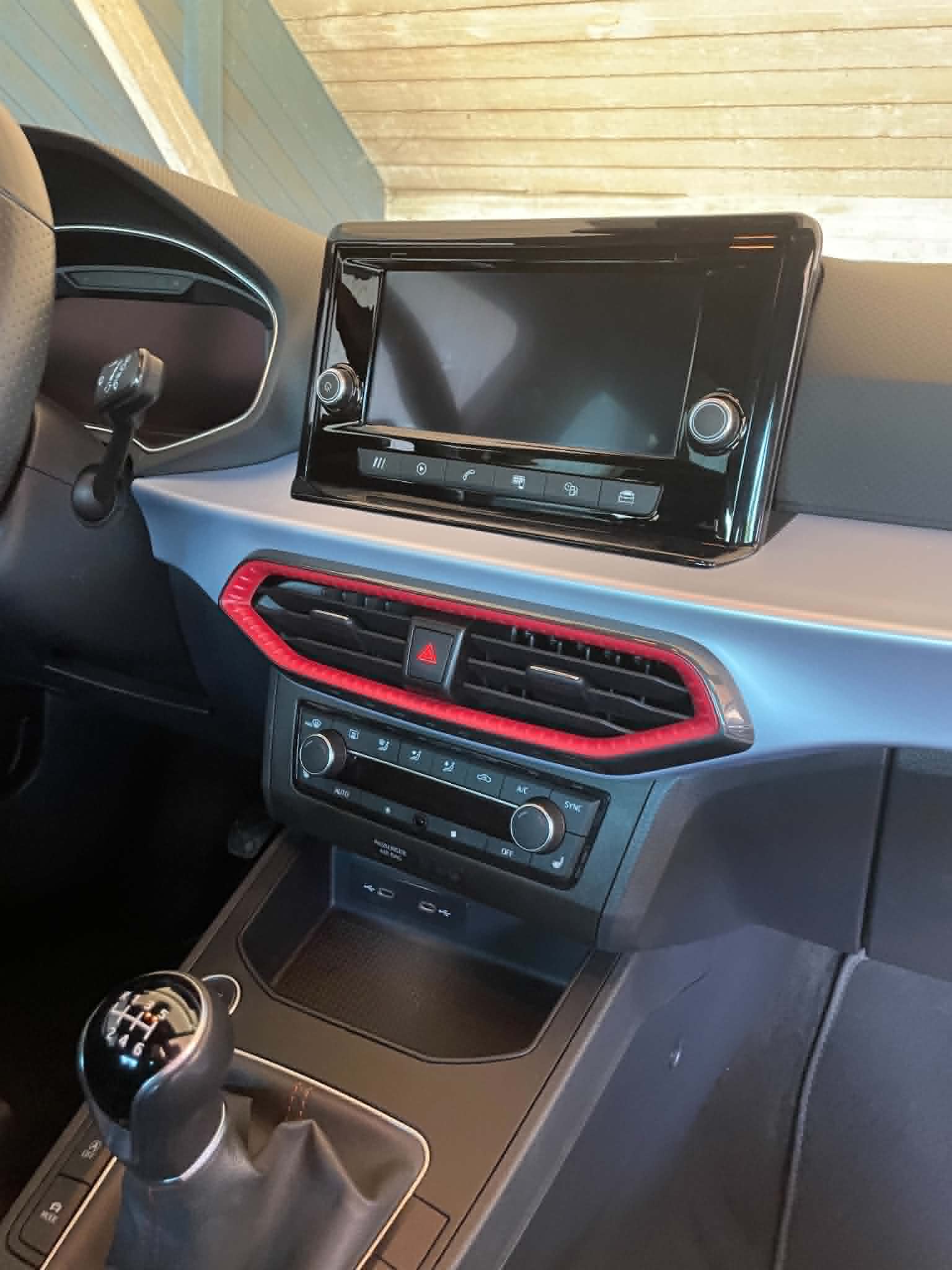

You connect it to the head unit. The head unit is your screen.
Here you have pics of the head unit
Nice! thanks - finally some clarity, because i did infact contact a seat service center in my country and their mechanics said they think its behind the glovebox, i got different answers but nothing definitive.

Hmm i havent changed any audio in my ibiza, i thought about getting a Match mini dsp plug and play and change the speakers. But i think you will have to add a subwoofer in the back to be worth the upgrade. Otherwise the stock sound will be ok.
There is a trim part you will have to remove first. I think its the one on the dashboard, not the trim around the radio.

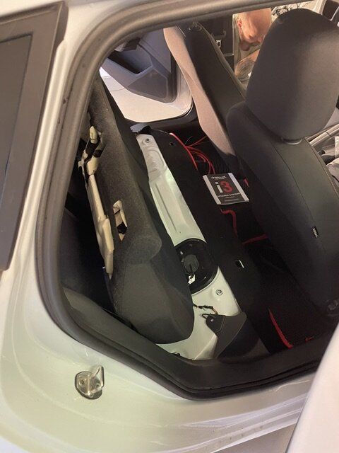

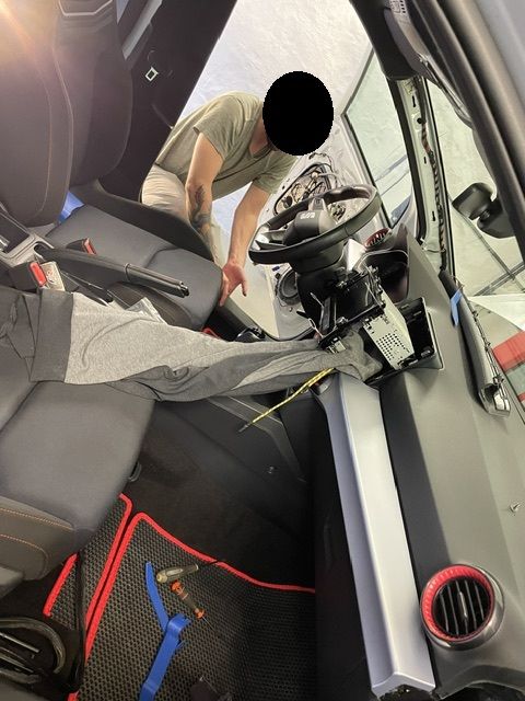

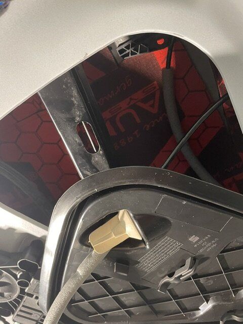

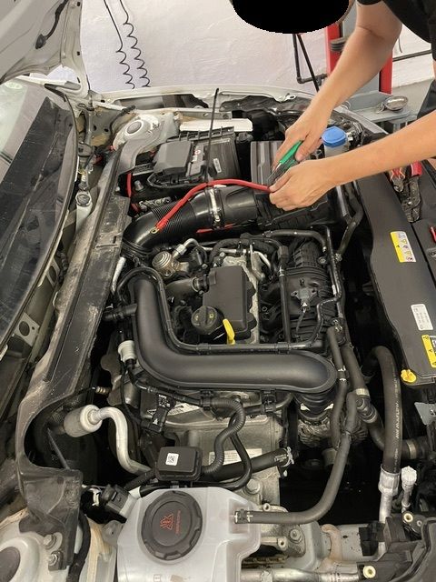

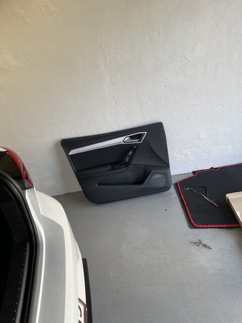

- Power is installed
- Trim off the radio but found out it had no torx screws, had to use 4 pin keys to get it out

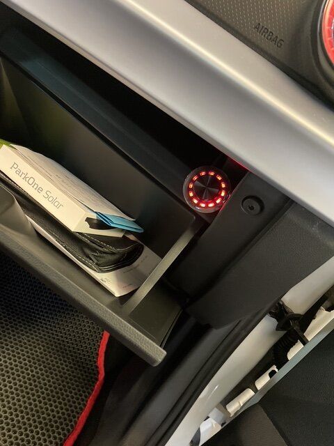

- Had to remove entire glovebox to install quadlock adapter as i couldnt reach the cable from the backside
^ Extended it to the boot and blinded the orignal power cables as im running highpower.
^ it was a perfect opportunity to drill a small hole in the right part of glovebox to install my conductor controller aswell and drag it to the boot side by side with the connector cable.

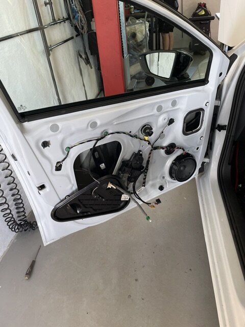

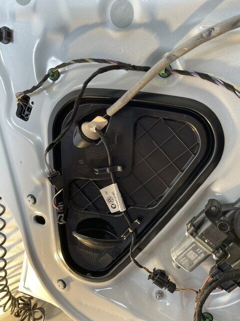

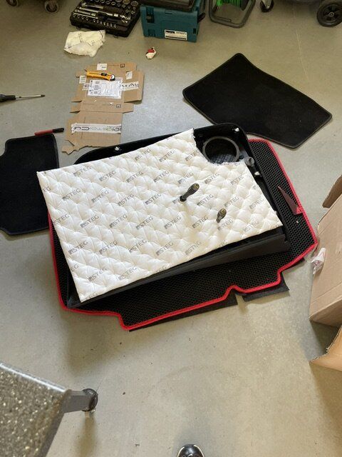

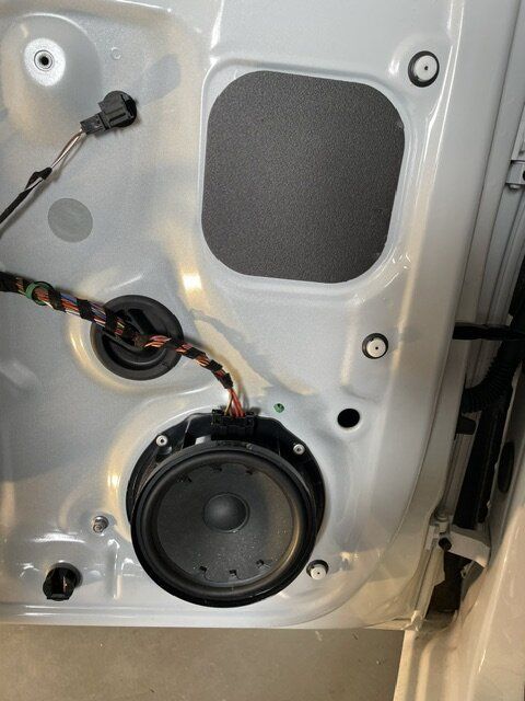

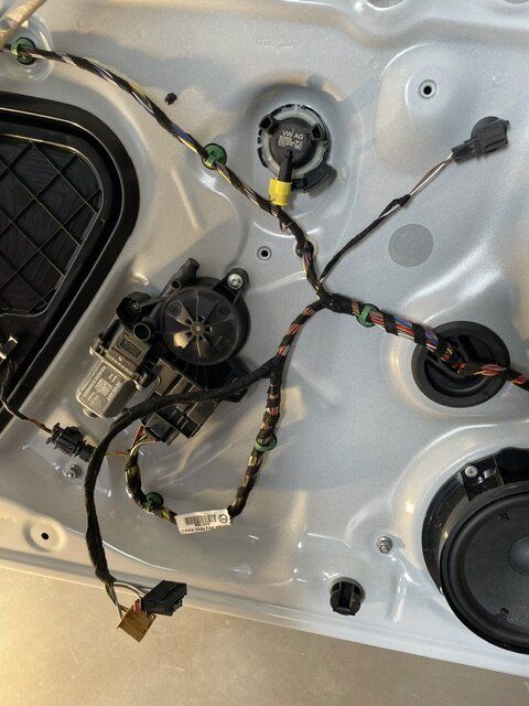

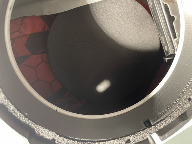

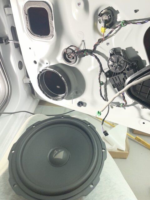

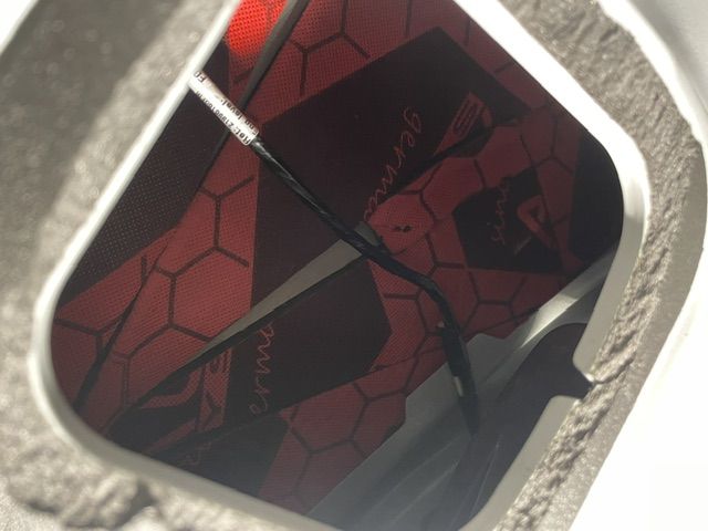

- All 4 doors has been soundproofed with Multilayer 7500 and Steg S7
- Front A pillar & doors have had Helix Compose Ci3 K165.2 MK 2 set installed.

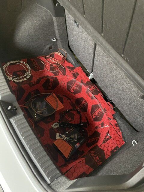

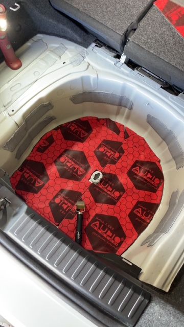

- Boot is soundproofed and the hatch aswell.
- Match 6DSP is installed and running a simple basic setup while i wait for my sub.
- Gonna build a new steady bottom, install 6DSP and 1UPFX on that, make some spacers and a new 2 piece board on top with felt matching the existing in the boot.
It's been one hell of a ride for now as its first time doing this haha, but you get to know the car thats for sure.
^ Pro tip, dont try to remove the silver pillar, i would rather step on legos for 30 minutes straight than trying to fit it in again.
^ The radio trim is clicked on SO well, i was -><- close to break it when removing the last 2 bottom clips.
