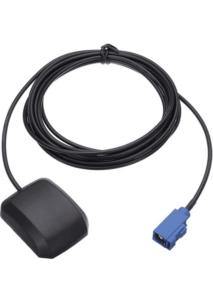

For anybody who wants to try it what GPS antenna / module did you buy,
Fakra GPS Antenna
Reactions: Tell
Thanks. That will be helpful for anybody who wants to try it.
