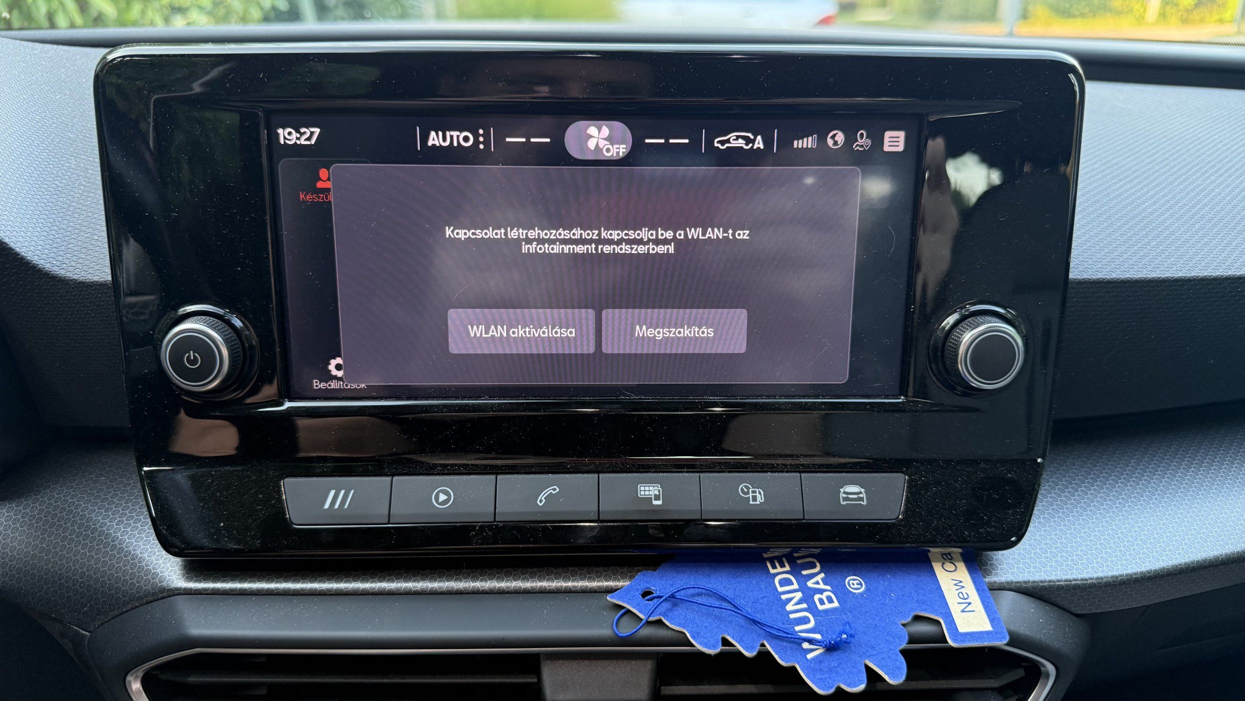

I bought OBD Eleven to enable wireless CarPlay (wired one works fine) but even though I enabled it (and restarted the head unit) I can’t connect to it via CarPlay ‘cause it says I have to enable WLAN (see picture [Hungarian ?]). Under Multimedia 5F > Adaptation > 5 GHz WLAN I’ve tried to enable it, but it says “Not available”.
Did I miss any step, or this basic display is not capable for 5 GHz?
