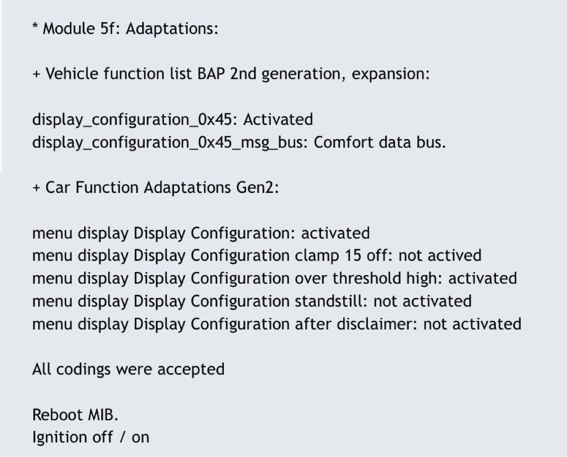

I had the same ‘issue’ as you. We have a Ibiza FR 1.0 TSI from 2020 with virtual cockpit and the basic 6.5” media unit / Infotainment. Except for the ‘view’ button on the steering wheel, we can’t change the dials’. The settings where you’re looking for are turned off by the manufactory.
However I've found the solution which is working but not for 100%. Perhaps that's the reason that is normally turned off. You need VCDS or VCP (maybe OBD11) to activate the settings on your media system.
Module 5F -> Adaptations
Search for:
- Vehicle function list BAP 2nd generation display_configuration_0x45 and set it on activated.
- Car function adaptations gen2 menu display display configuration and set it on activated.
When both codings were accepted, reboot the media unit by pressing the power button for +/- 15sec. After that turn off and on the ignition.

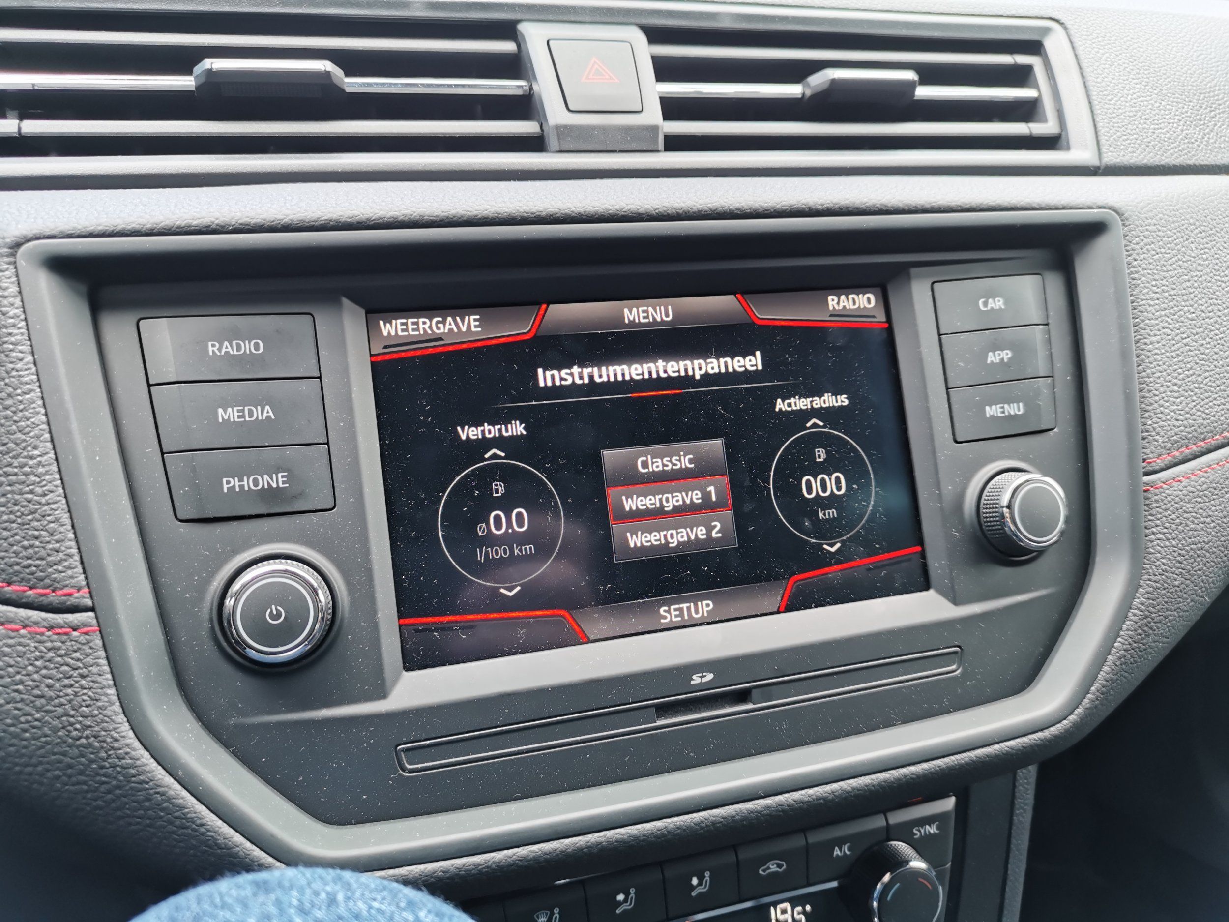

Now, when you press multiple times the ‘car’ button to changing the screen on the media unit, you get one screen to change the centre of the dials of the virtual cockpit.
And now the part that’s it not working for 100%. You can change the left dial with no problems, however the right dial has some hiccups. If you want to change the right dial, set the left dial on the view what you want to have on the right dial. Now you change the right dial and it copies the left dial. After setting the right dial you can change without problems the left dial.
Search for:

Wow thank you so much, you're the first person i found that had the same problem as me! I'm definitely gonna try this!
