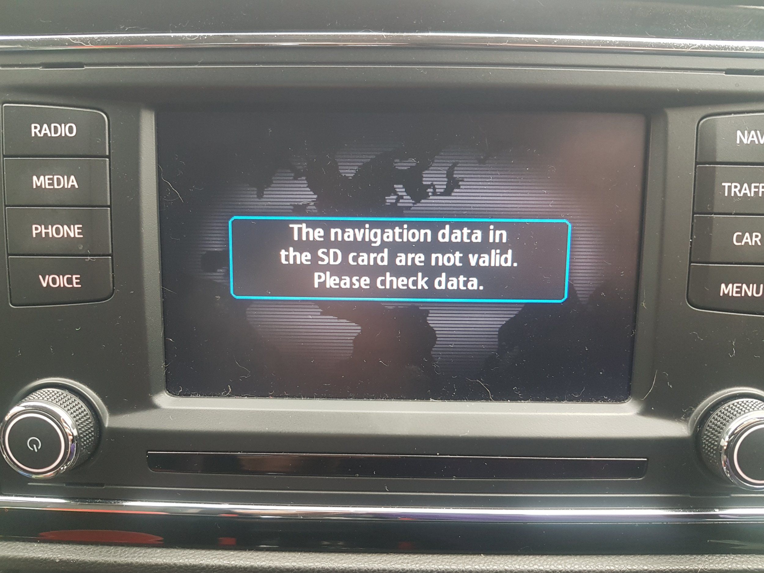

I have tried that - when this new card goes in, the unit thinks about it for a couple of minutes and then gives the message that the data is not valid

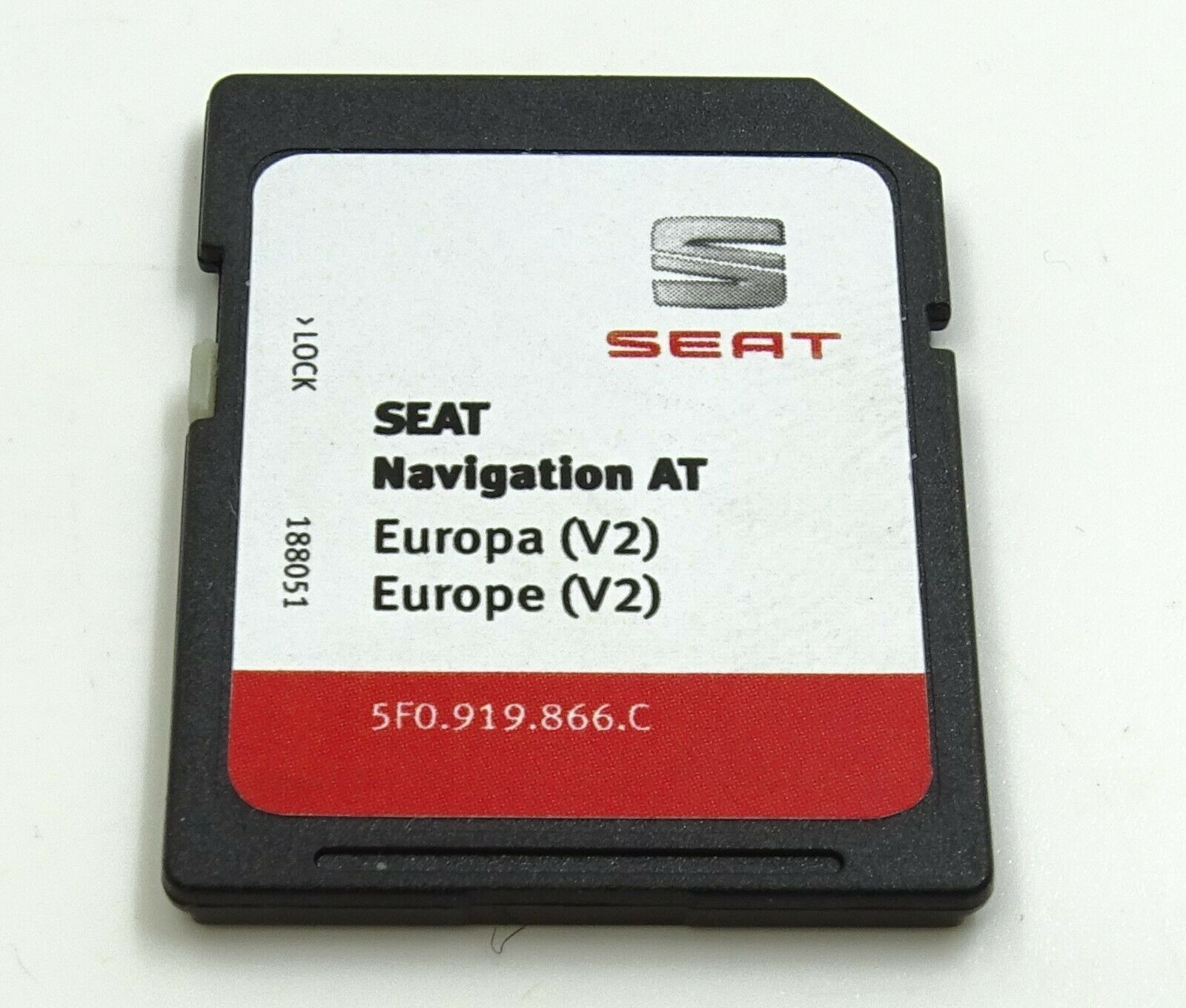

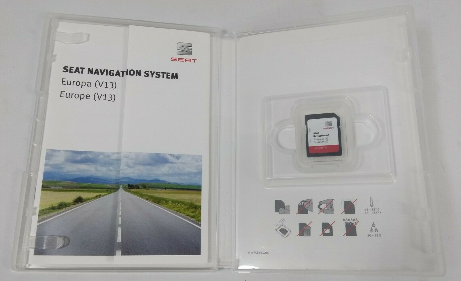

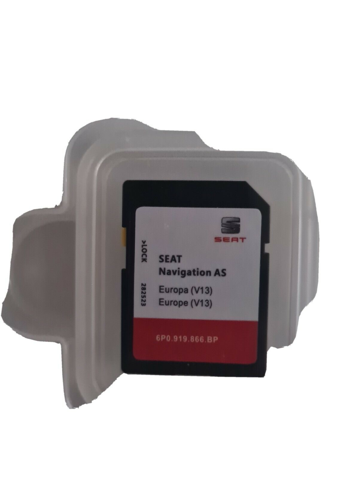

Yes I did remove the original (working) v 2014 maps. SD card in the box matches exactly what is on the box in the ebay listing (v13) as in your link
What is different is my original is marked Seat Navigation AT, the new one as in your link is marked Seat Navigation AS
All working again as soon as the original card is replaced

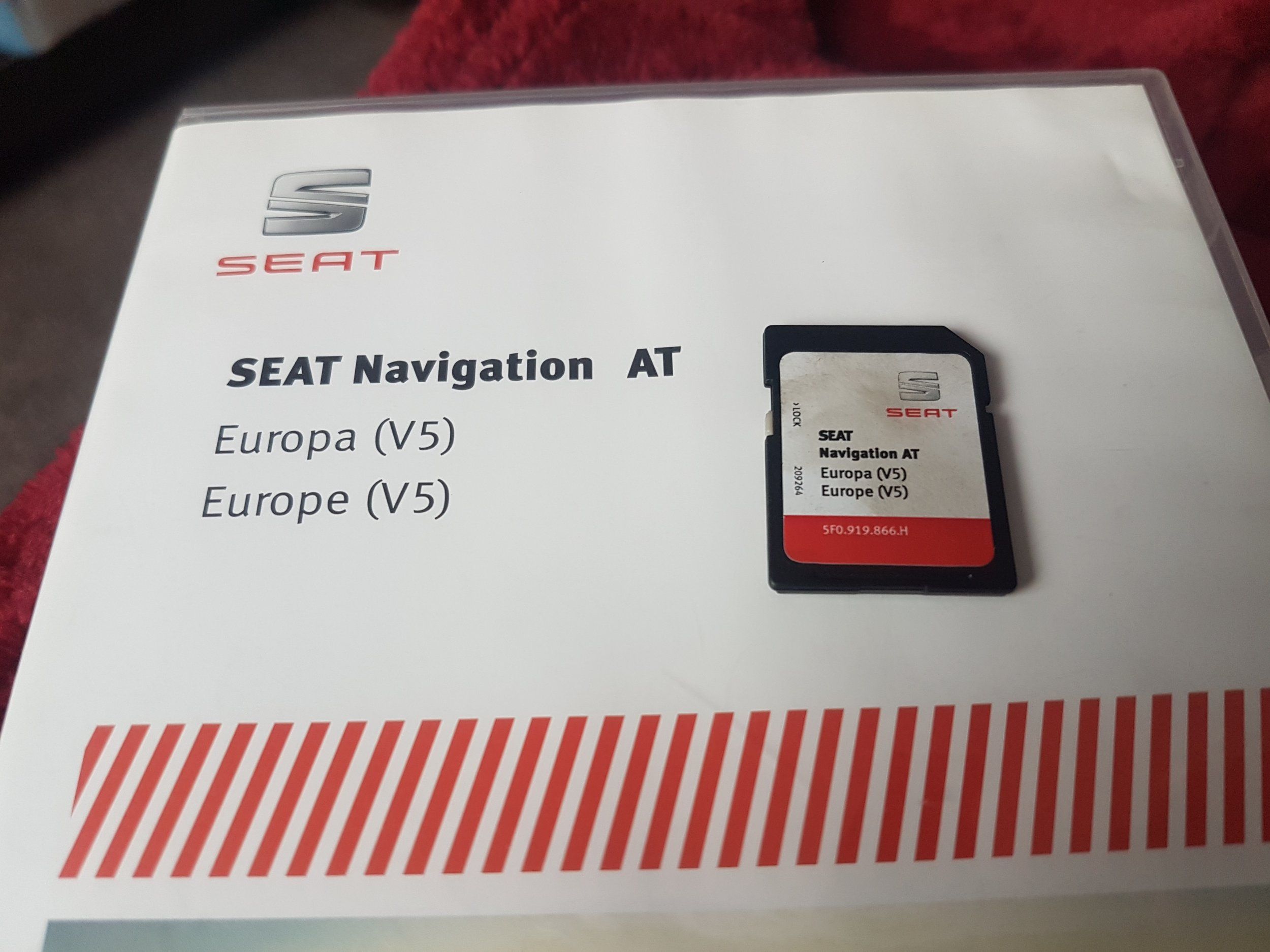

That's what I've been trying to say to the seller. He is adamant that this one he supplied, which is correct according to the listing, is the MIB1 update
The last pic you sent is like mine now, except mine is the V5 edition

You can send it back anyway, with pick of the dash of radio, but give me little bit i will ask my friend to check is card to make sure because i upgraded to mib2.
i will also look for my old map card.
AS is for MIB2 only for sure unless some software update by dealer makes AS work on MIB1 i don't know, so i will check his radio software if he has AS to see because does all service on dealer, unsure if they updated or he have AT card.
will check later on and will let u know once i am back, i will see what map he got and where from.

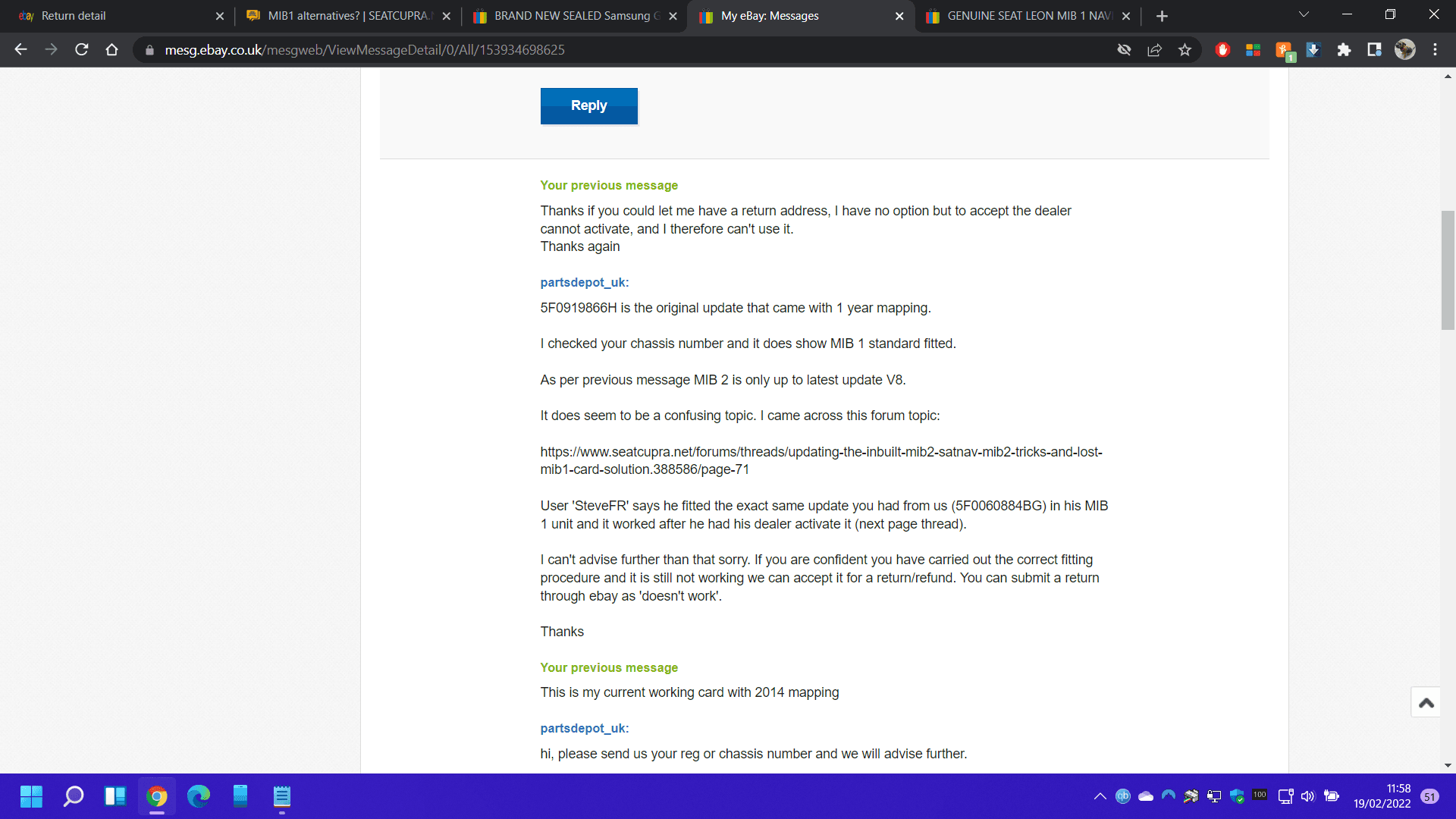

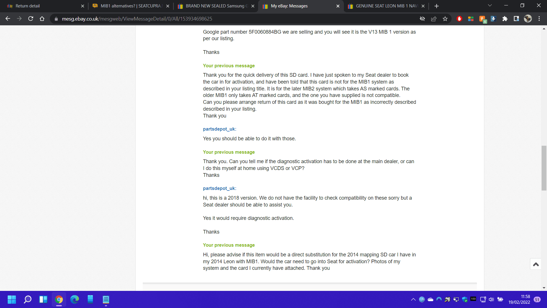

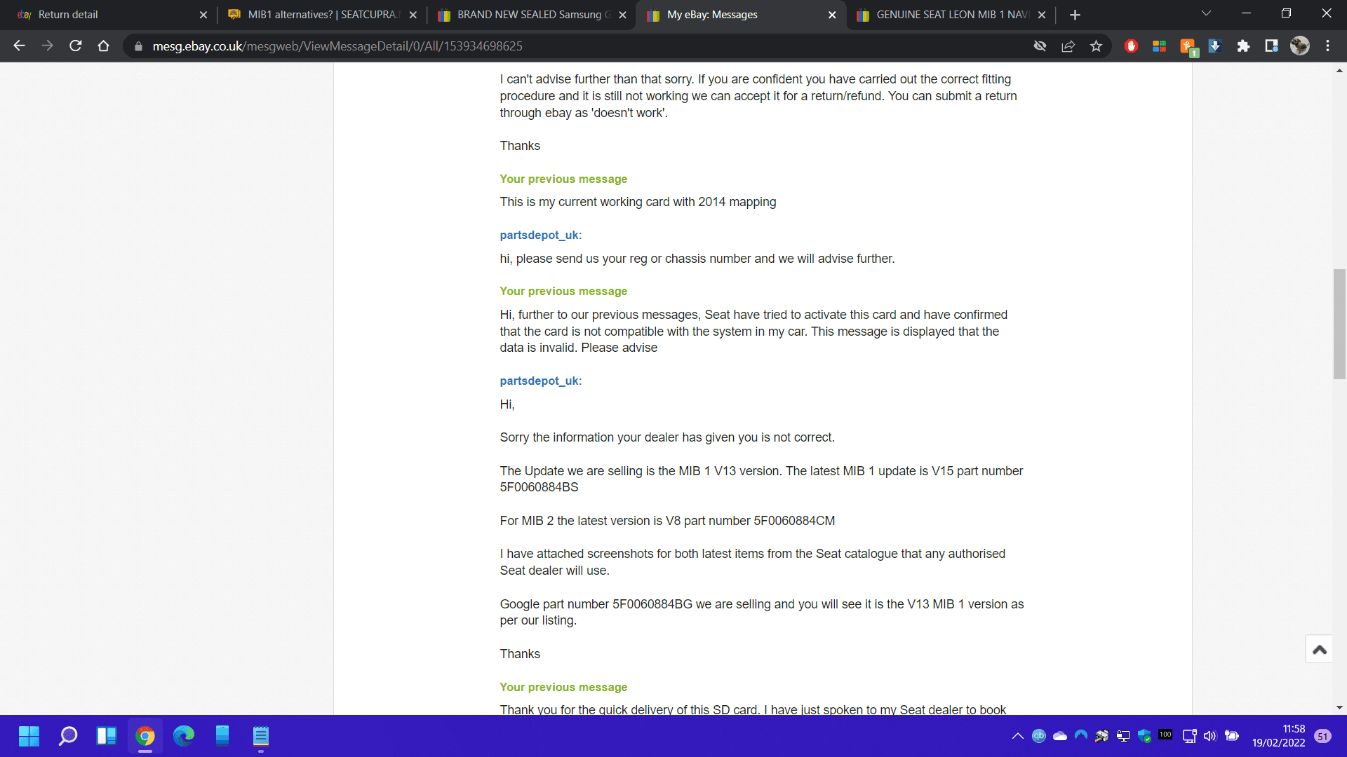

The part number on this box certainly sems to tie up with what he says but I can't work this out at all. Here are screenshots of the messages between the seller and me on ebay.
I have now returned the card to the seller for a refund, but still looking for a suitable upgrade to these old 2014 maps I currently have.
