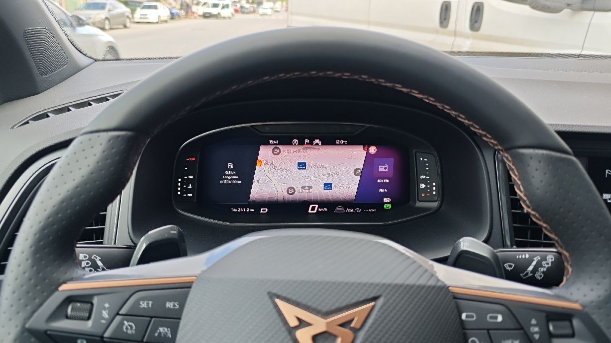

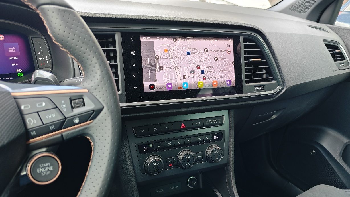

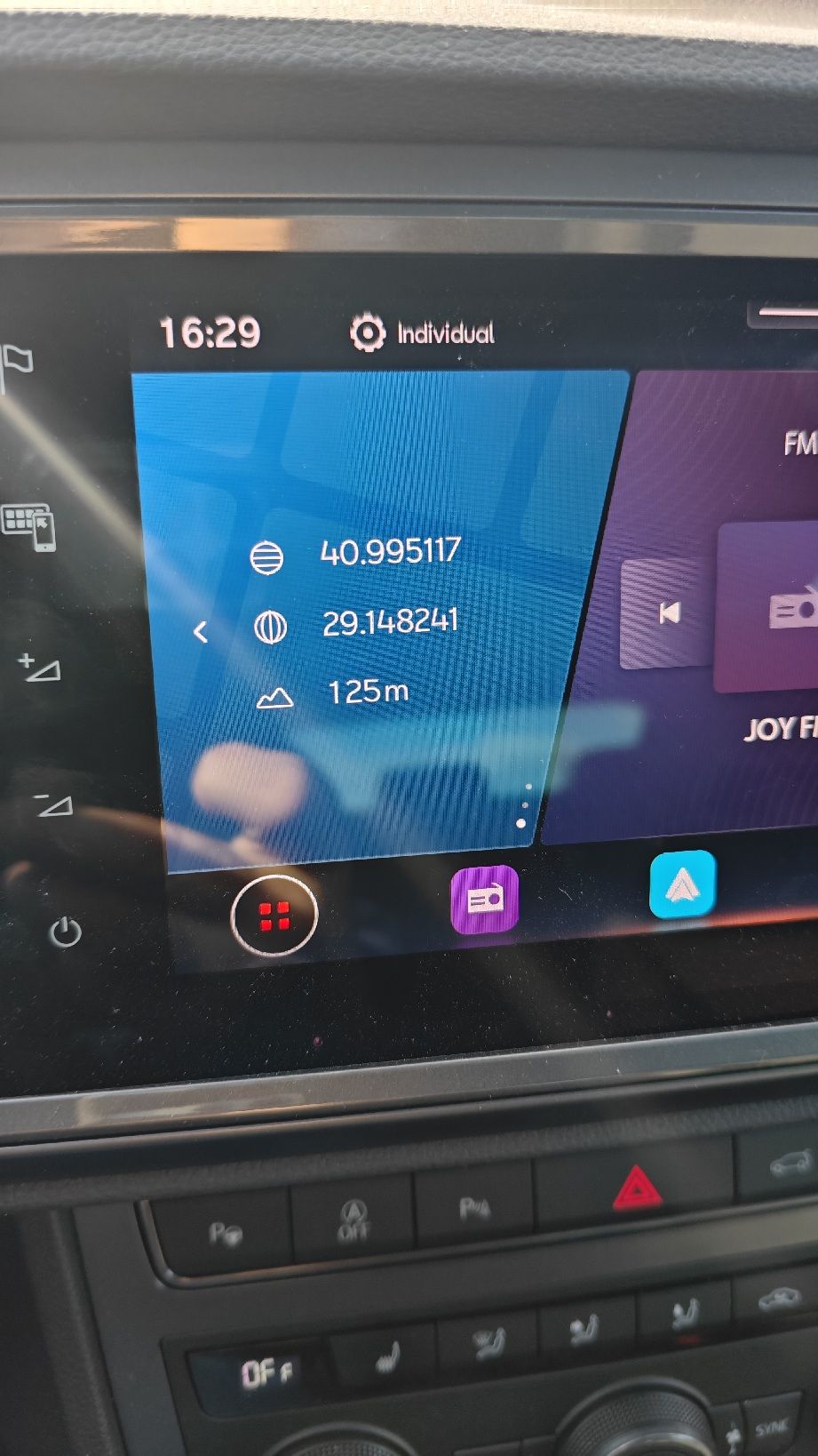

Hi everyone,
When I had ordered my Cupra Ateca, I was expecting that it would come with Navigation feature included, as there was an Ateca with the exact same trim in the showroom and it had navigation on it. But when I collected the car, much to my dismay, there was no navigation on it and the infotainment screen was telling me that I could "go to a dealer and purchase the navigation feature". But here in Turkey, no Cupra dealer nor the Turkish importer of VAG cars has been selling a navigation license so I had to leave the dealer with the excitement of a brand new car but also the disappointment of an unexpected outcome. The people at the dealer told me there's an unresolved conflict between car importers and the government about using the map data/satellite bandwidth and because of that, the cars that have been coming to Turkey for a year or so have no navigation feature, but if & when the problem is solved, the navigation in our cars could be activated by an update. I'm not sure that this is true but when I checked the full PR list of my car, I saw that it has "7UH - Preparation for navigation system (MIB)". I mean, it wasn't saying "no navigation" but "preparation", so what the dealer told me about the activation could be true, I thought. As for why & how there was an Ateca in the showroom with the navigation, they were completely clueless!
Anyway, I had no patience for waiting to hear from the dealer or the importer company and I took the matter into my own hands and looked for a retrofitter who would be able to activate the navigation on a MIB3 unit of a SFD2-protected car. I found one, who has a Chinese contact, who is able to enable the navigation FECs & prepare the needed tokens for required coding changes (of course for a not-so-cheap sum) and we proceeded with the activation. After some time comparing the codings & adaptations of a sample car with mine and haggling with the missing coding changes, we managed to get it worked! After three months with my new car, I'm happy again as if I bought another new car :giggle:
Here are some photos of this new actually-not-so-much-needed toy in my car & cheers to everyone.
Serdar

Unfortunately it wasn't just a matter of downloading/copying the map files to the unit because the FEC related to navigation wasn't enabled in factory & also there were a lot of adaptation items in multiple units that we had to change. I still wonder whether the "preparation" was ever meant to be enabled by dealers somehow, sometime when the laws permitted it or so-called conflict was resolved.
