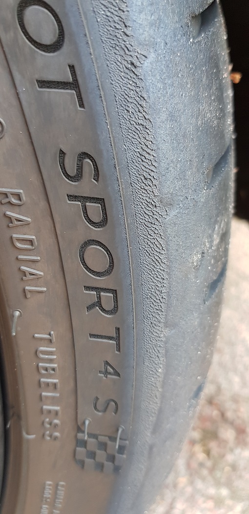

I had Michelin PS4S on my former Golf 7R. They were great the first track days but I believe they suffered from weak sidewalls which cause much wear on shoulders, much more than PSS I had before the 4S. 4S are great in rain! Many of you on this forum likes PS4S, a lot :)!

One of the Golf tires….

I think you have to try both, to see which you prefer and which wear's better. For me the photo shows a weak side wall carcass, unless your turning in to early and scrubbing speed off with the front end, of which I'm sure you know is so very easy done..
...….unless your turning in to early and scrubbing speed off with the front end, of which I'm sure you know is so very easy done..
Sometimes I do, if more tyre weare mistakes increase!

If your can get a laser temp sensor you could set your track pressures according to hot temps. You may be able to run higher pressures and reduce sidewall flex.
