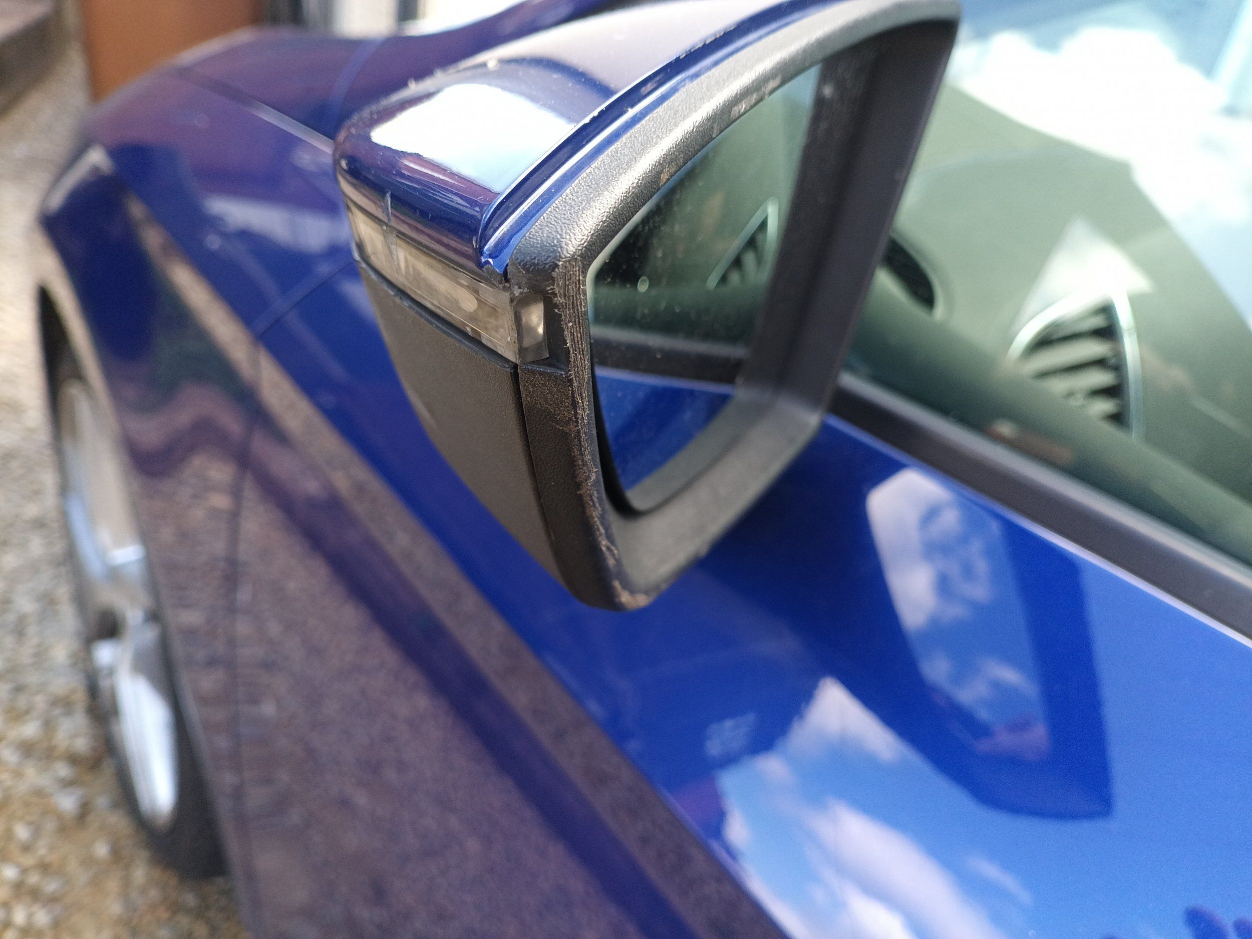

I was an idiot, and caught my passenger door mirror while reversing at our holiday property recently. It's damaged the black surround, the LED strip, *and* the painted cap. Of course it has.

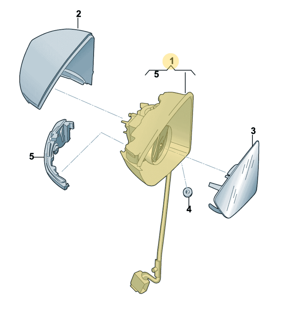

Anyway, the cap is probably saveable with a bit of paint, but the black surround is knackered. Does anyone happen to know if the black surround that faces the rear of the car is available separately, or is it part of the mirror body? I know the cap and LED are available as individual parts.

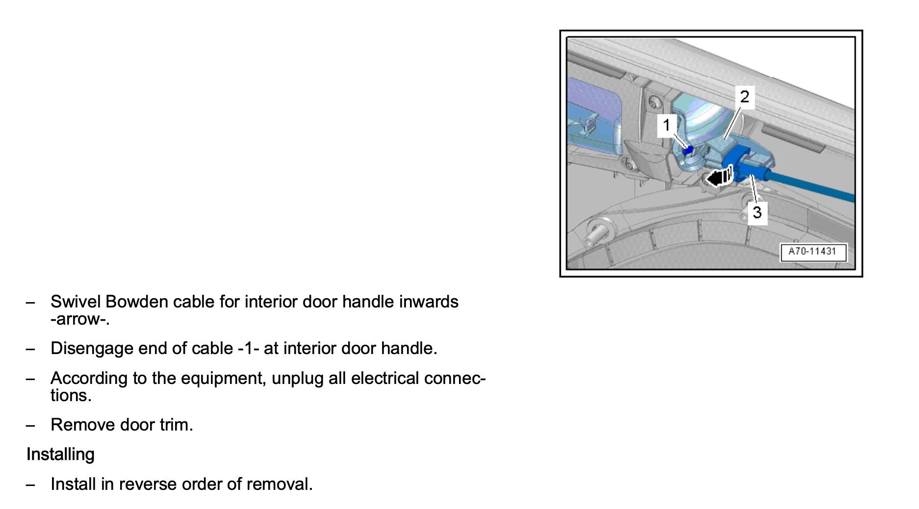

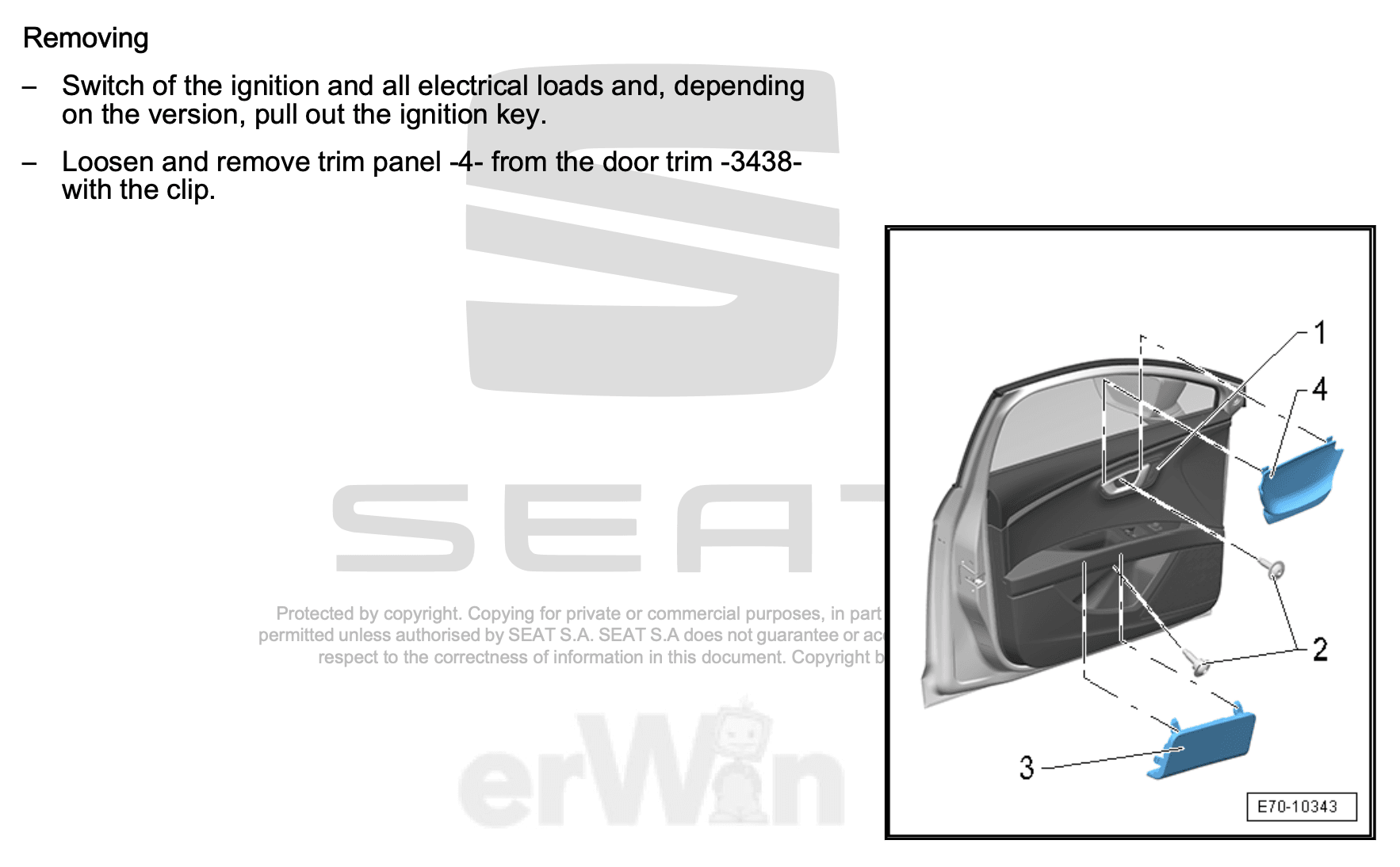

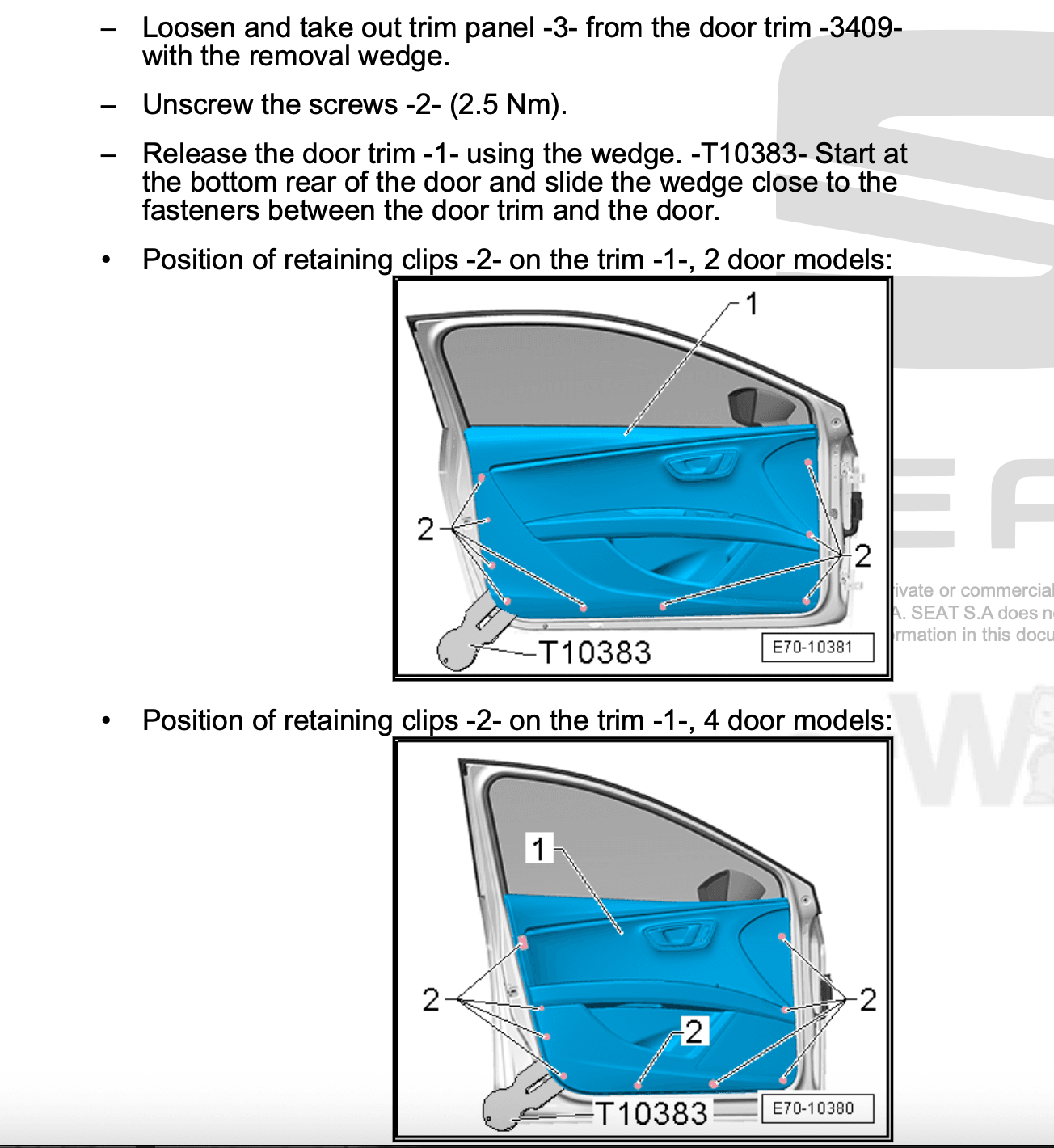

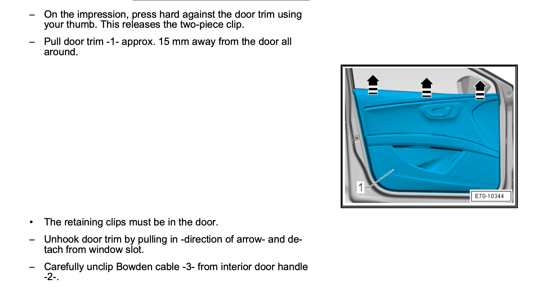

Secondly, is there a guide to removing the door cards? Someone here did an excellent guide for the MK2 Leon that I used years ago.

Happily, a quick look at eBay has found me the correct, power fold mirror in the right colour :)
