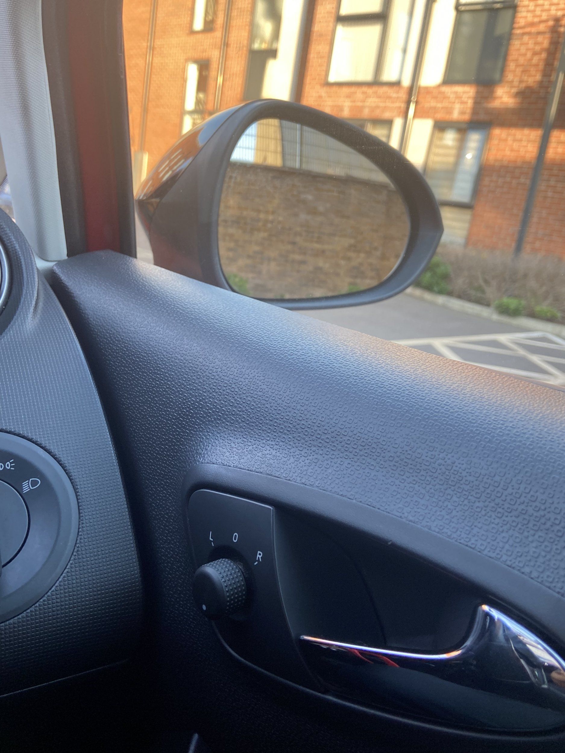

Hi there everyone, I had just purchased a seat ibiza FR 2015, and have been trying to figure out why my mirrors wont fold, after countless of videos and searches as well as looking into the manual i have just not been able to figure out how to fold my mirrors. The dial used to adjust the mirror works fine as the glass is adjusting depending on which side i select but after trying to turn the dial to 180 deg facing downwards nothing seems to happen. Does anyone know the reason and how to fix this?

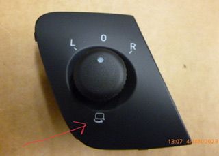

If you don’t have the folding mirror icon below your mirror adjustment control (arrowed in the picture below) then unfortunately your car doesn’t have the folding mirror adjustment function.
Electrically folding door mirrors weren’t standard on the 2015 FR model; they were part of one of the two optional Convenience Packs - see the Feb 2015 brochure at the link below under ‘Equipment Availability‘ and ‘Optional Equipment’ sections of the brochure;
If your car doesn’t have any of the Convenience Pack features listed in the brochure, then that would confirm your car doesn’t have folding mirrors.
