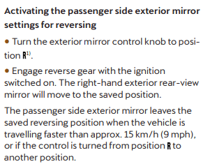

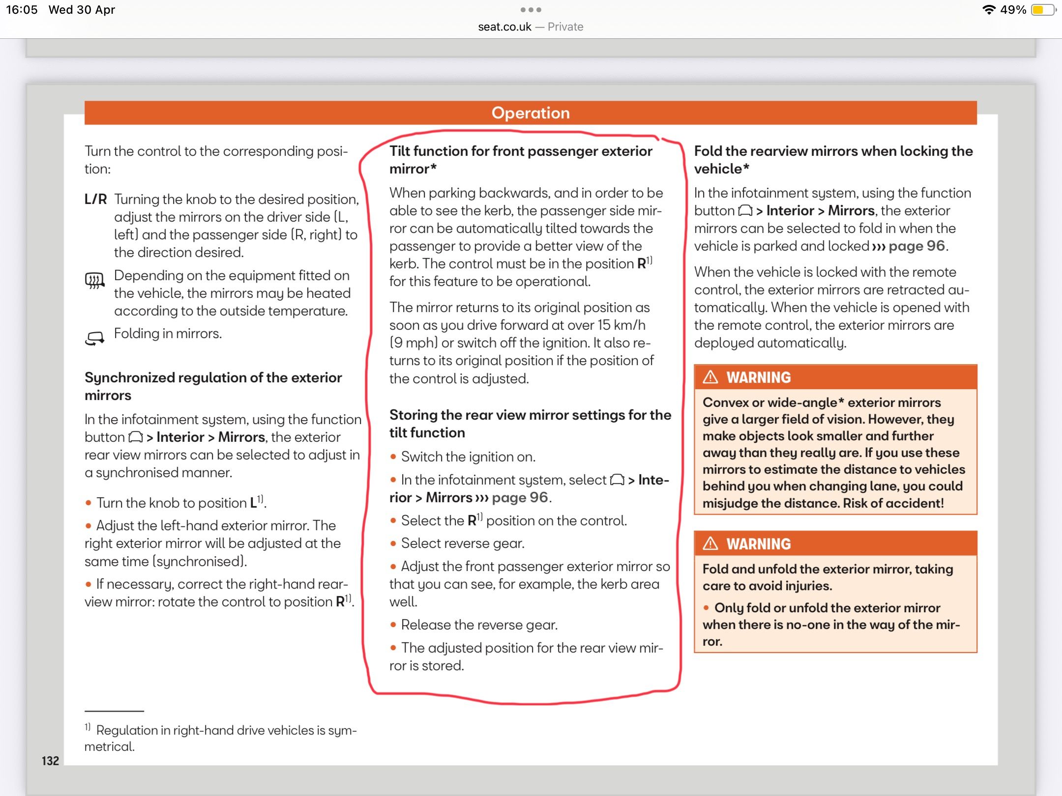

@Matt_Cardiff; should have added to my previous post that if by any chance your car has somehow ‘forgotten’ your specific ‘tilt while reversing‘ settings, you may need to set it up and store your settings again before it will work. Instructions to set it up as per the screenshot below from the 2021 manual (Nov 2020 edition) for the Leon - reference to ‘position R’ will be ‘position L’ for RHD cars.
