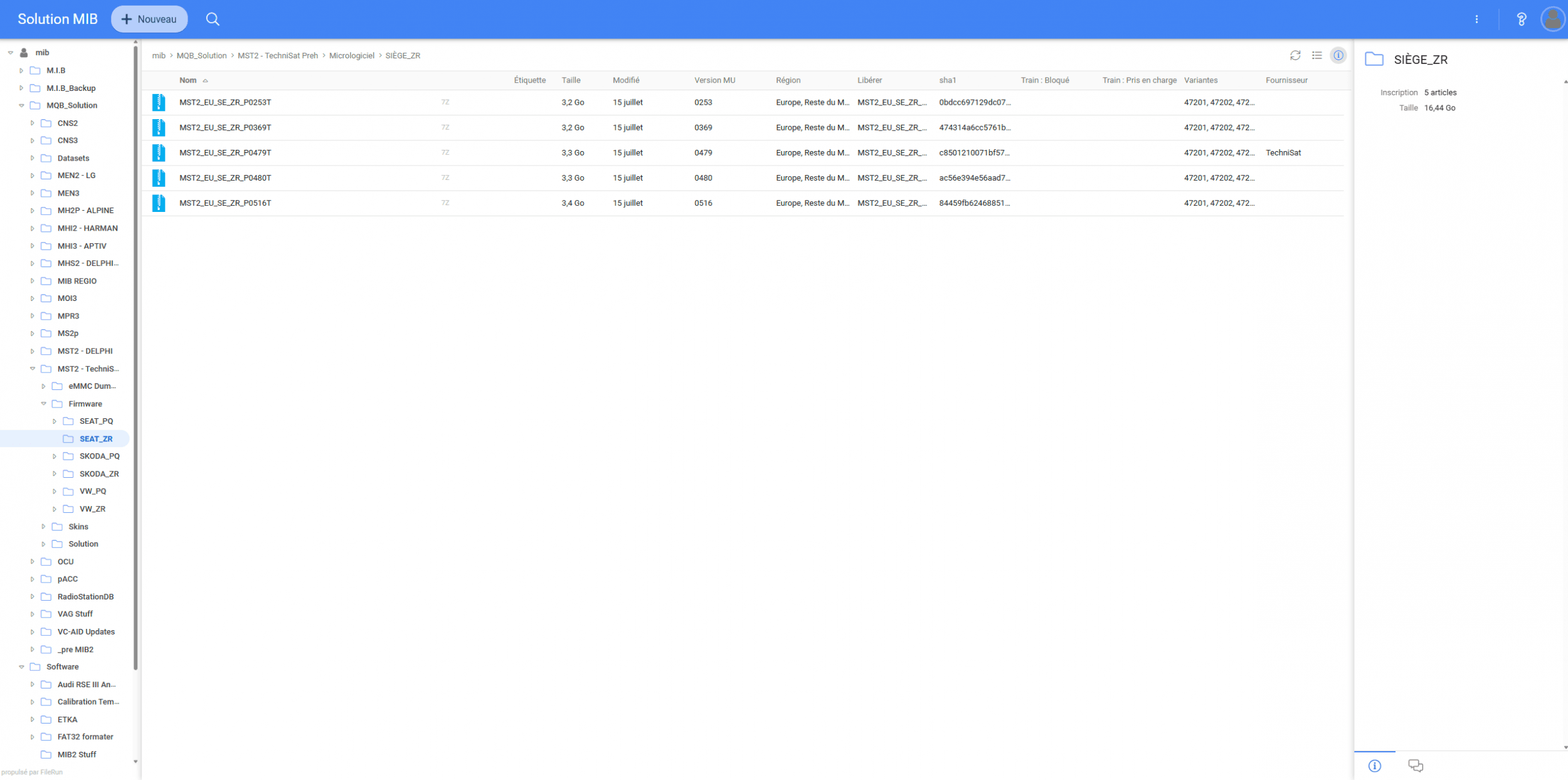

How doos tour download folder look like?
This message means you are missing files, zo maybe not complete or 100% complete download.
Verstuurd vanaf mijn SM-S921B met Tapatalk
